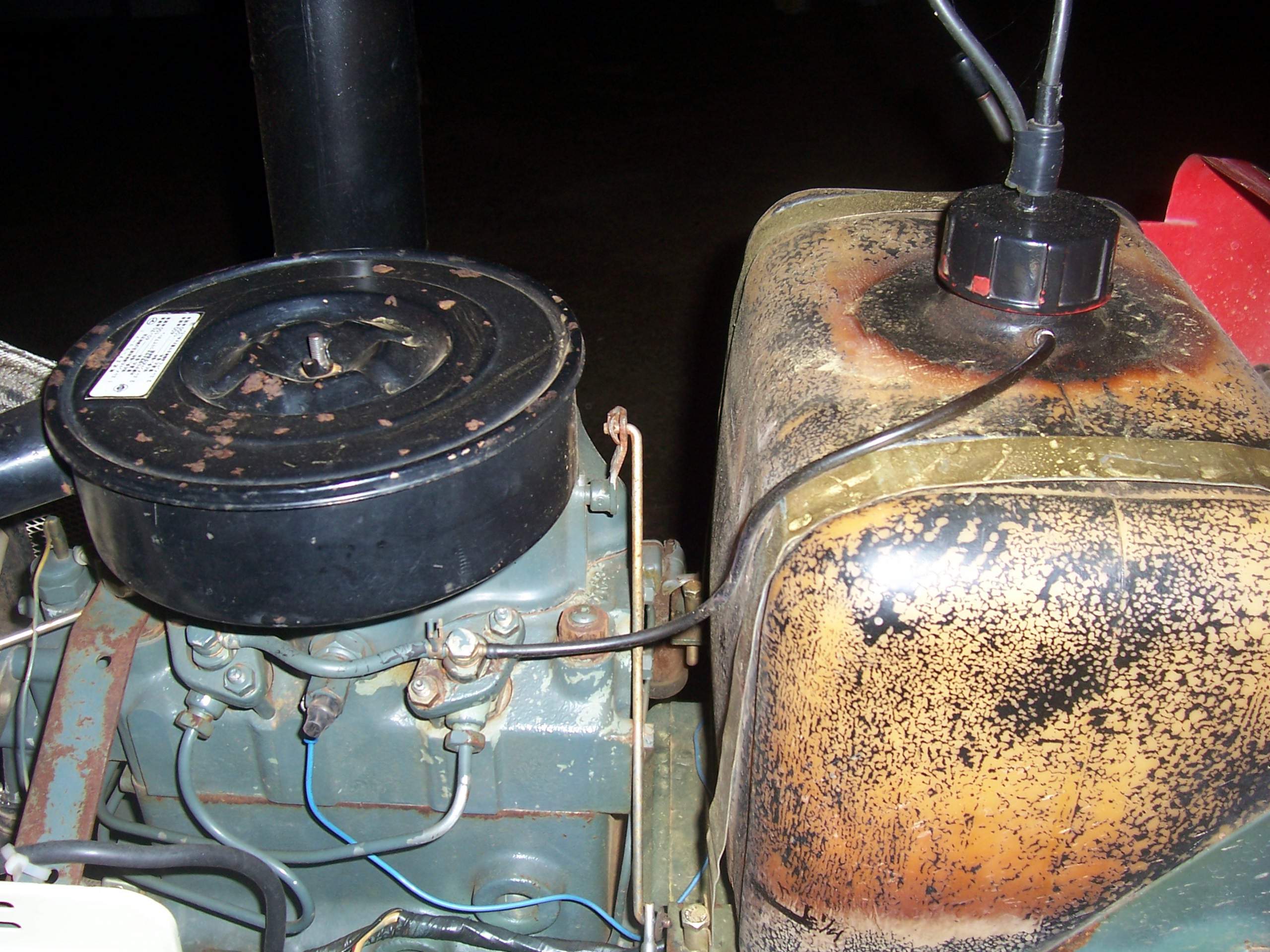

I recently acquired a Yanmar ym2000 from a friend of mine, he stated that it was running but sat for a yr or so . I attempted to get it started with no luck. Initially the fuel filter housing was low, I cracked the filter and it drew fuel in, I then cracked the discharge lines from the fuel pump, they seemed to pump fuel ok, I then cracked the lines at the injector, they had fuel squirting. I then tried to crack the bolt on top the injectors with the hose between each injector and no fuel would come out, can anyone provide troubleshooting steps as to why it won't start and fuel is not coming from the bolt/hose above the injectors? Also where is the best place to find a parts breakdown or oder parts? The pto shaft seal is leaking thanks for any help!
   / Yanmar ym2000 won't start #2
Since the Fuel bowl was half empty go through this How to bleed air out of the fuel system Pay attention to#4 no fuel coming out and I believe the line you talking about is just a return to my Tank.

Line on top of injector is only stem leak by. Don't expect flow there.
