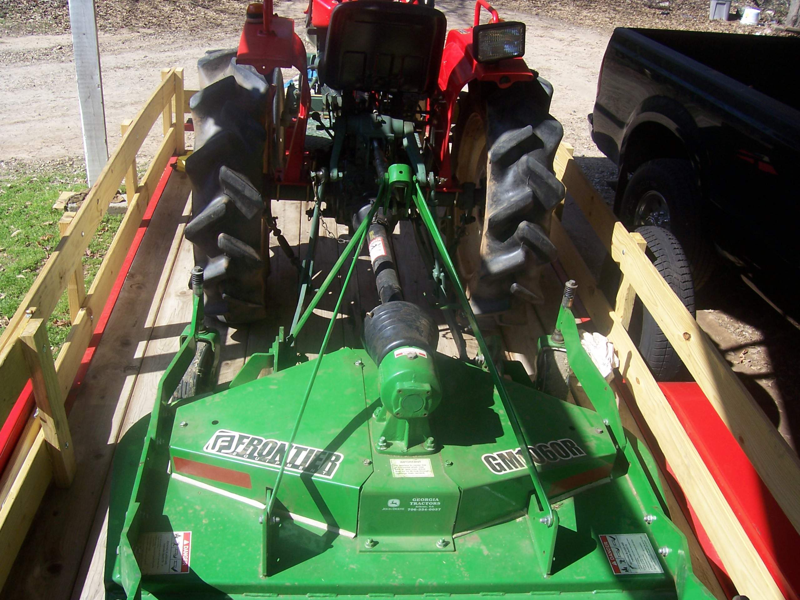

Picture 067.jpgI use a 5' Frontier/Woods on the YM2000. and on regular cuttngs I never have to run over 2000 rpms. 1st gear PTO. I believe I Tach Out at 2800. You'll probly need to add front ballast depending on the weight of it. Esp. if you have to lift it often.
