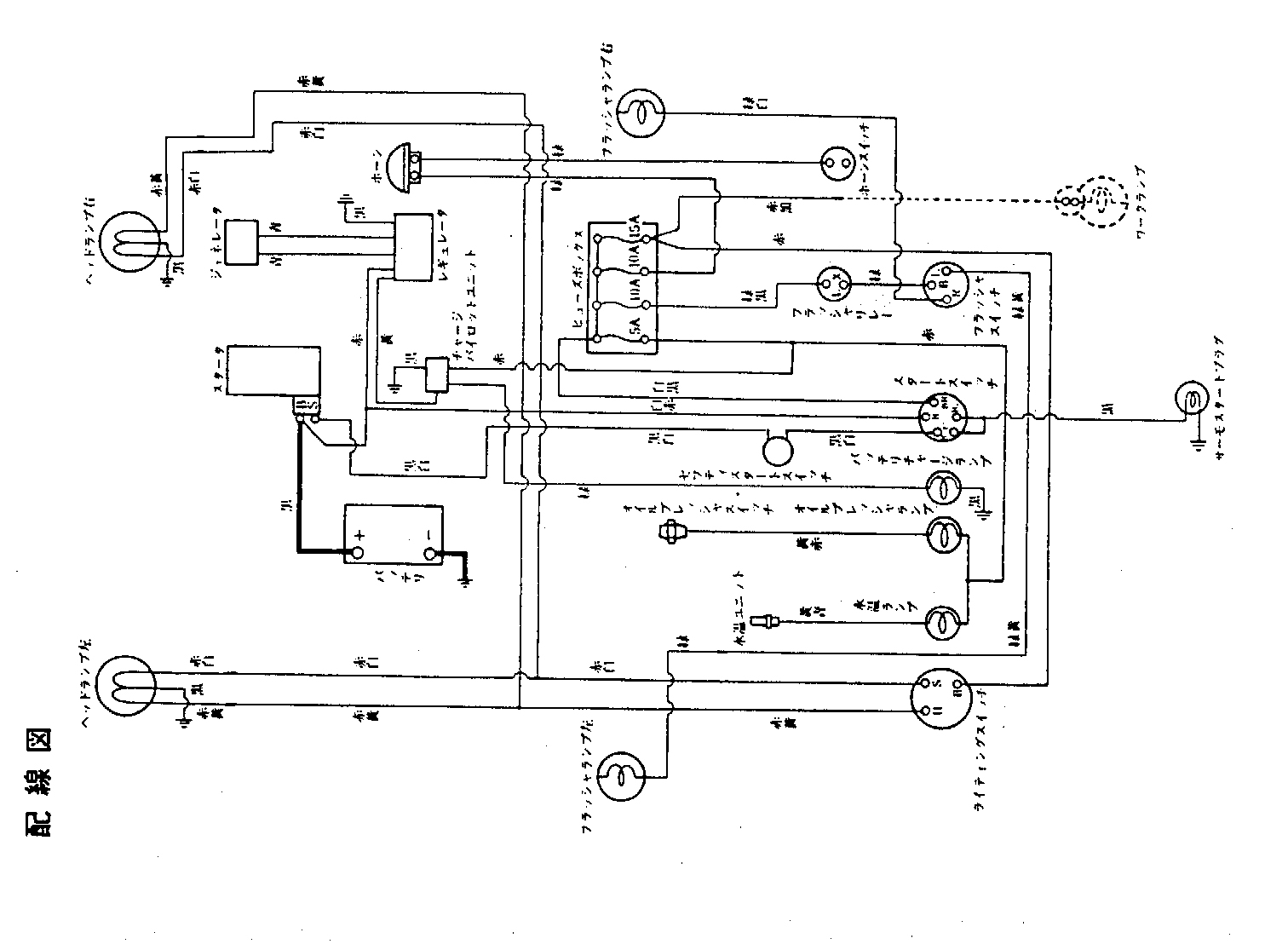

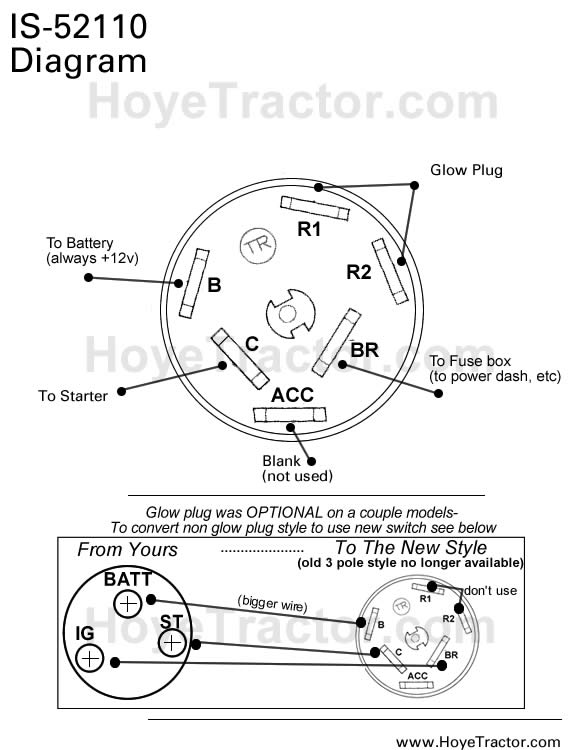

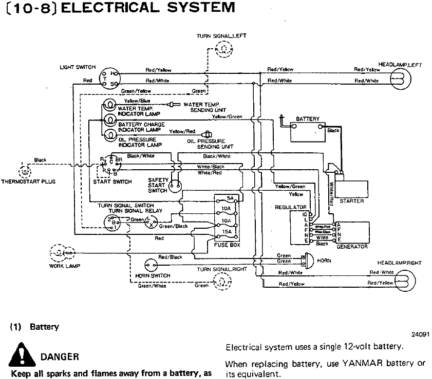

does anyone have an circuit diagram for ym186D -86 especially for the keyignition\safetyswitch\relay\starter...... :confused:
thanks in advance!

I do not have a schematic of a 186, but I do have that of a 1510 so it should be very close. I also will include the wiring to the back of the ignition switch of the 1510.
Mike
   / yanmar ym186D \\ circuit diagram #3
Try this Dia. should be close at least you can read it. Everything basicly wires the same on most models.
Carey

Thanks a whole bunch!!
Mike
thanks alot!! ill jump into it right now! :)
yes! it was a faulty cable between keyignition and starter
copper was burnt of within the cable
i would like to thank everyone who helped me out with this one!!:D
