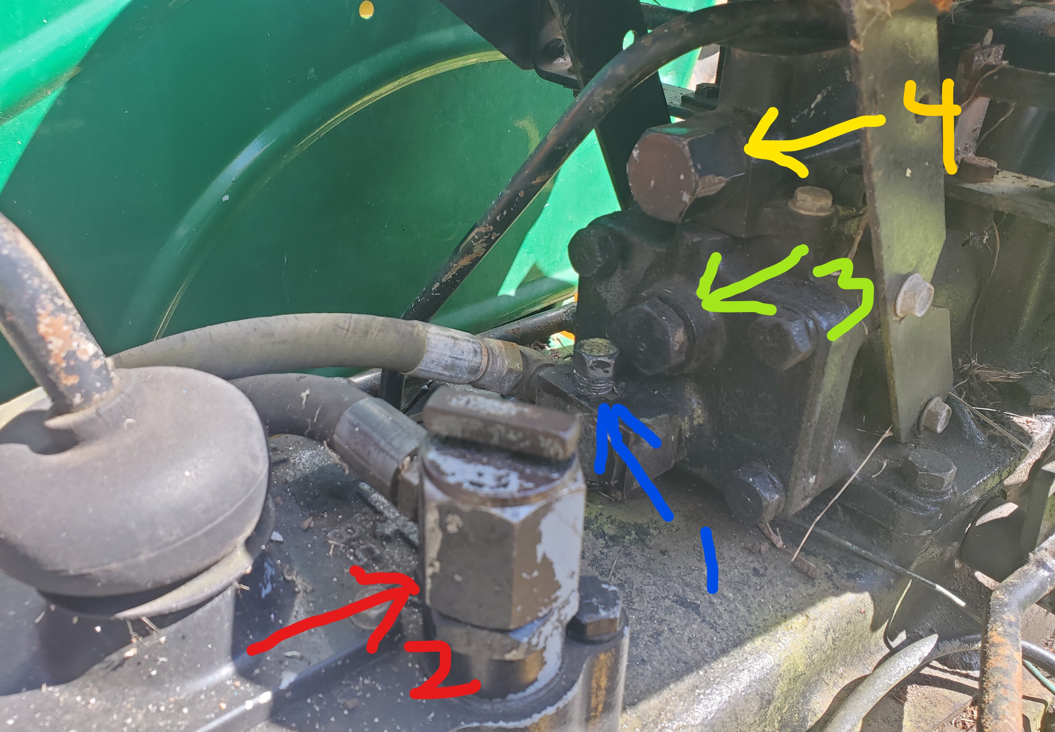

Here are some pics. First pic is taken from the front and under the seat. Arrow #1 is the bolt I turn (think counterclockwise) that was able to make the tilt on loader move. Can you tell me what is this actually for. The hose just to the left of that bolt goes to the loader controls.
Also #2 is the hydraulic fluid fill. Could you tell me if #3 and #4 is used for anything. Really trying to learn these for future while I troubleshoot the loader problems.

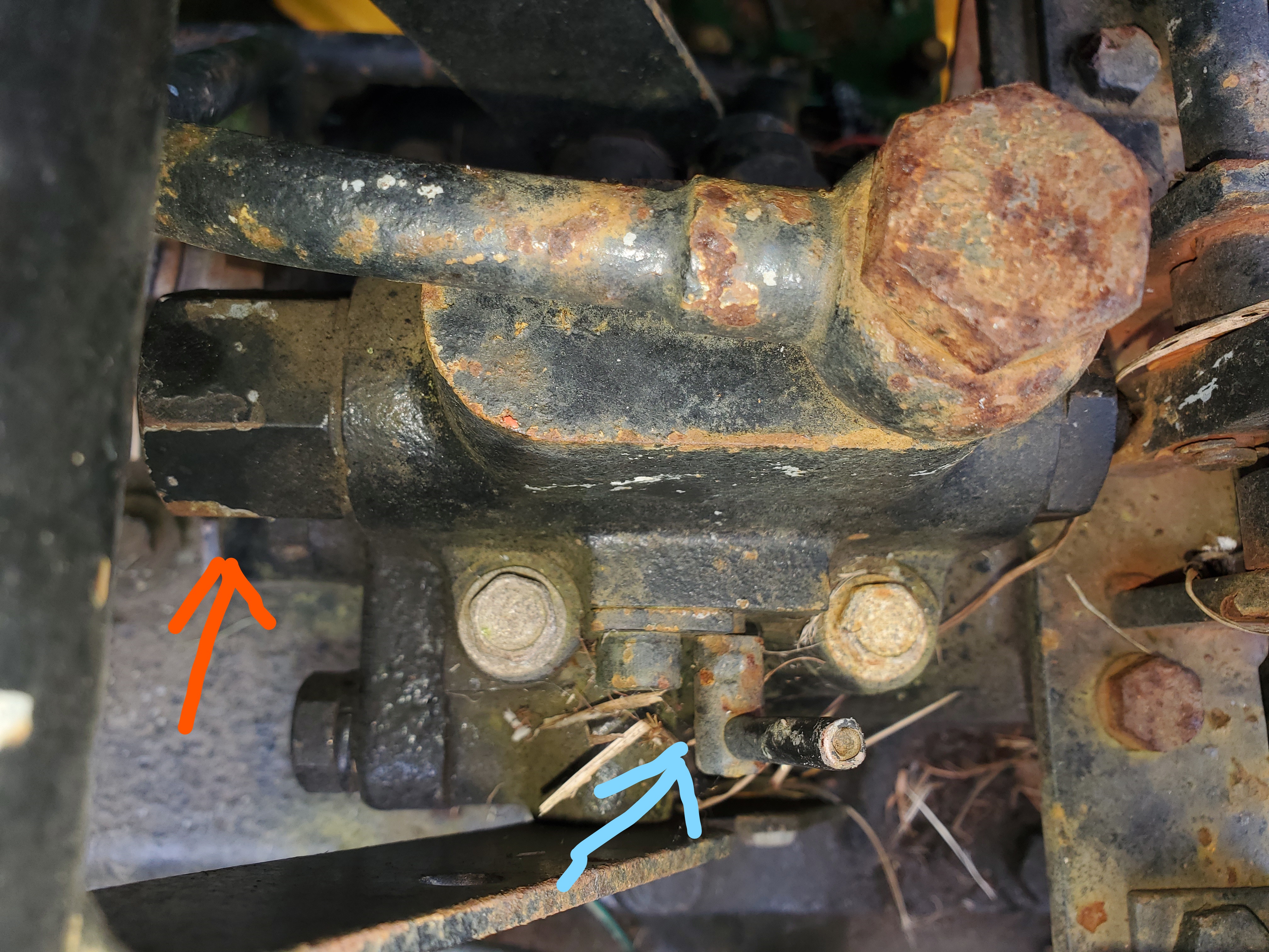

Also on the next pic is taken from the left rear side. What would the adjustment be for(blue arrow)? I been reading other blogs and I think this is to control the drop speed but not sure.

View attachment 662026View attachment 662025View attachment 662024
#4 is the cap on the 3 point control valve. There is a relief valve behind it. That cap is #8 on this parts drawing. THREE_POINT_CONTROL: Yanmar Tractor Parts
It would look to me your tractor is plumbed with power beyond. #2 in your picture has been added and is not only for dip stick but also the tank return from your loader control valve. Hydraulic Return - Dipstick Adapter - Out Of Stock: Yanmar Tractor Parts
#1 in your picture is a new one to me. Never have seen that exact setup. However the hose going in there should be the power beyond hose coming from your loader valve.
#3 I am not sure of but believe it is an outlet for a single action cylinder.
You are right about the little lever with the blue arrow, it is to control drop speed.
