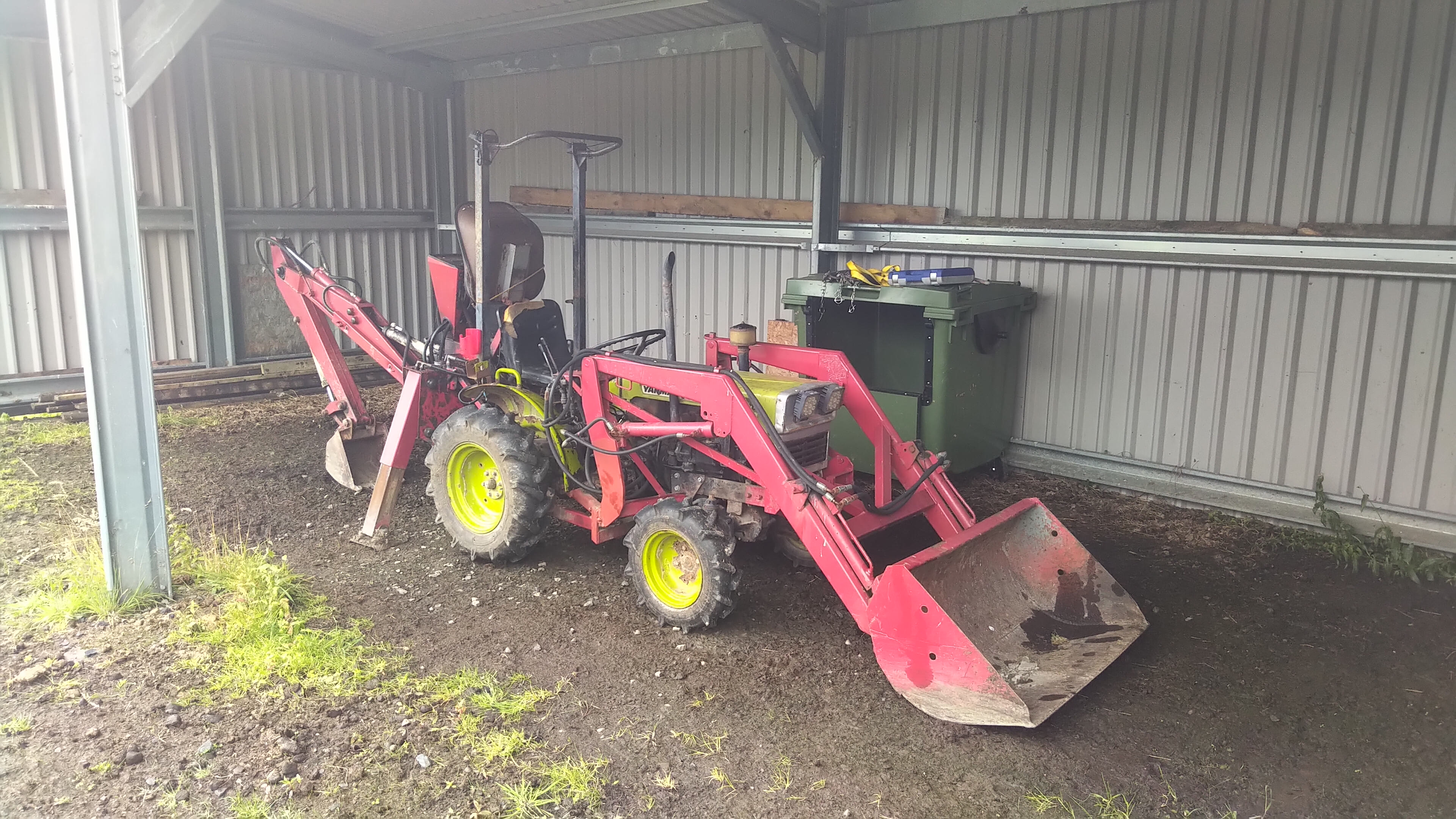

Hello, my name is Steve and I live in Scotland. I recently purchased a used Yanmar YM155D with front end loader and Polymark D200 backhoe. It all works mechanically, but does need some TLC. I got it for a good price though and the tractor has been very useful so far.
The transmission fluid needed changed, so I went ahead and drained it and put new transmission/hydraulic oil in. I attempted to remove the transmission oil filter cover so I could remove and clean the filter, but it seemed basically impossible to remove without first removing the backhoe frame from the tractor. I'm assuming the filter has not been cleaned in some time.
The transmission dipstick was really tight to remove and the plastic/rubber handle was missing from it, I managed to remove it with pliers. I was then unable to re-insert the dipstick because of the rubber grommet in the hole. I removed the rubber so I could get a better look and then attempted to put the dipstick back in to see how far it would go. Because my hands had oil on them the dipstick slipped out of my fingers and ended up dropping right into the transmission dipstick tube!

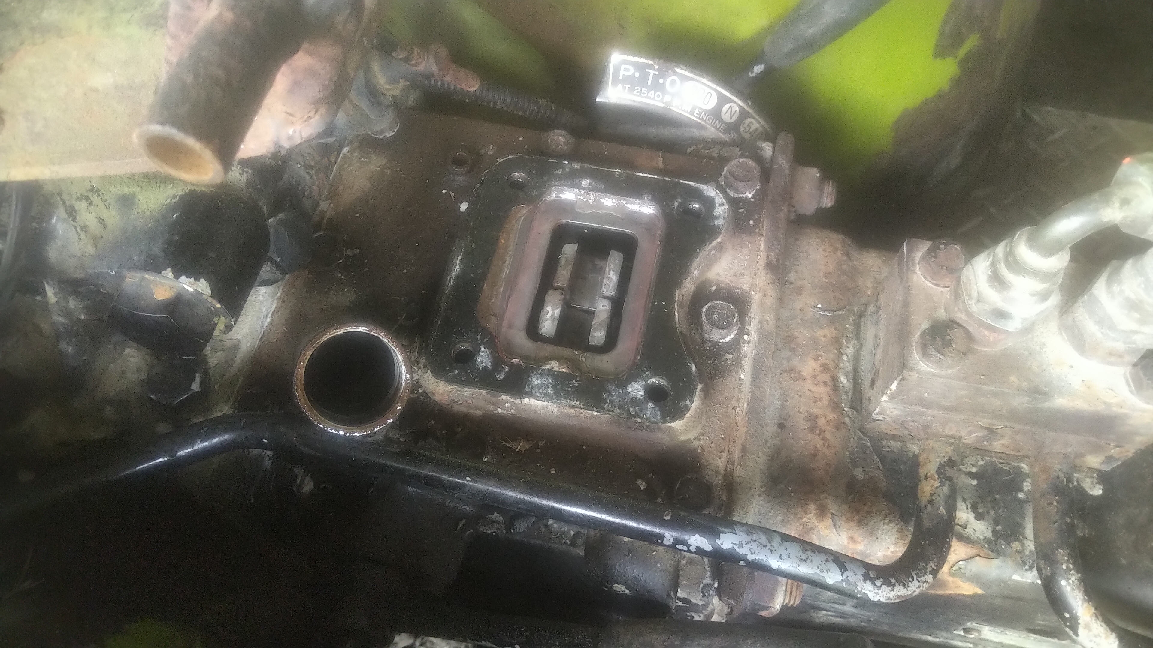

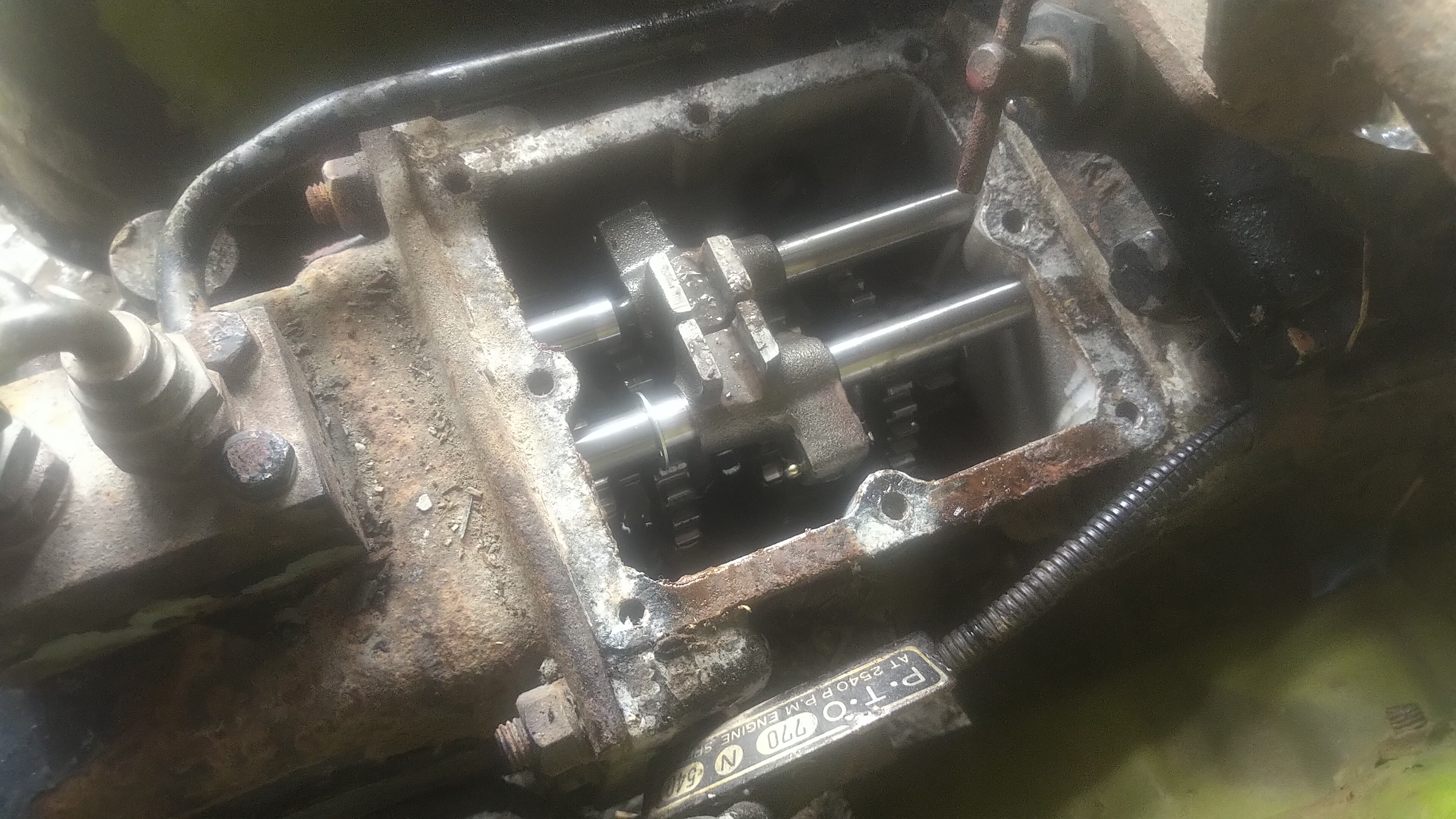

This is what mine looked like with the cover off
   / Yanmar YM155D Transmission Dipstick

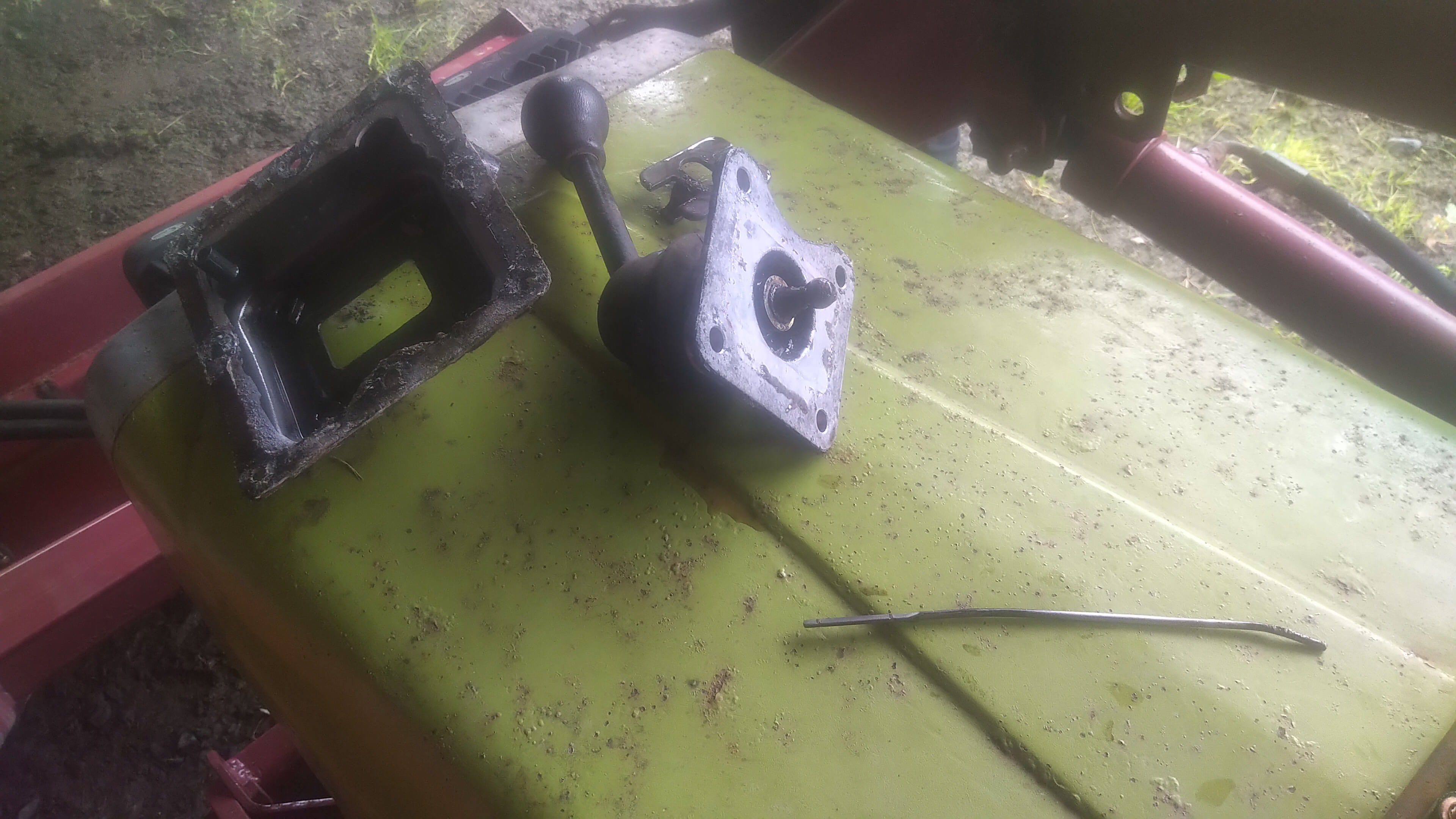

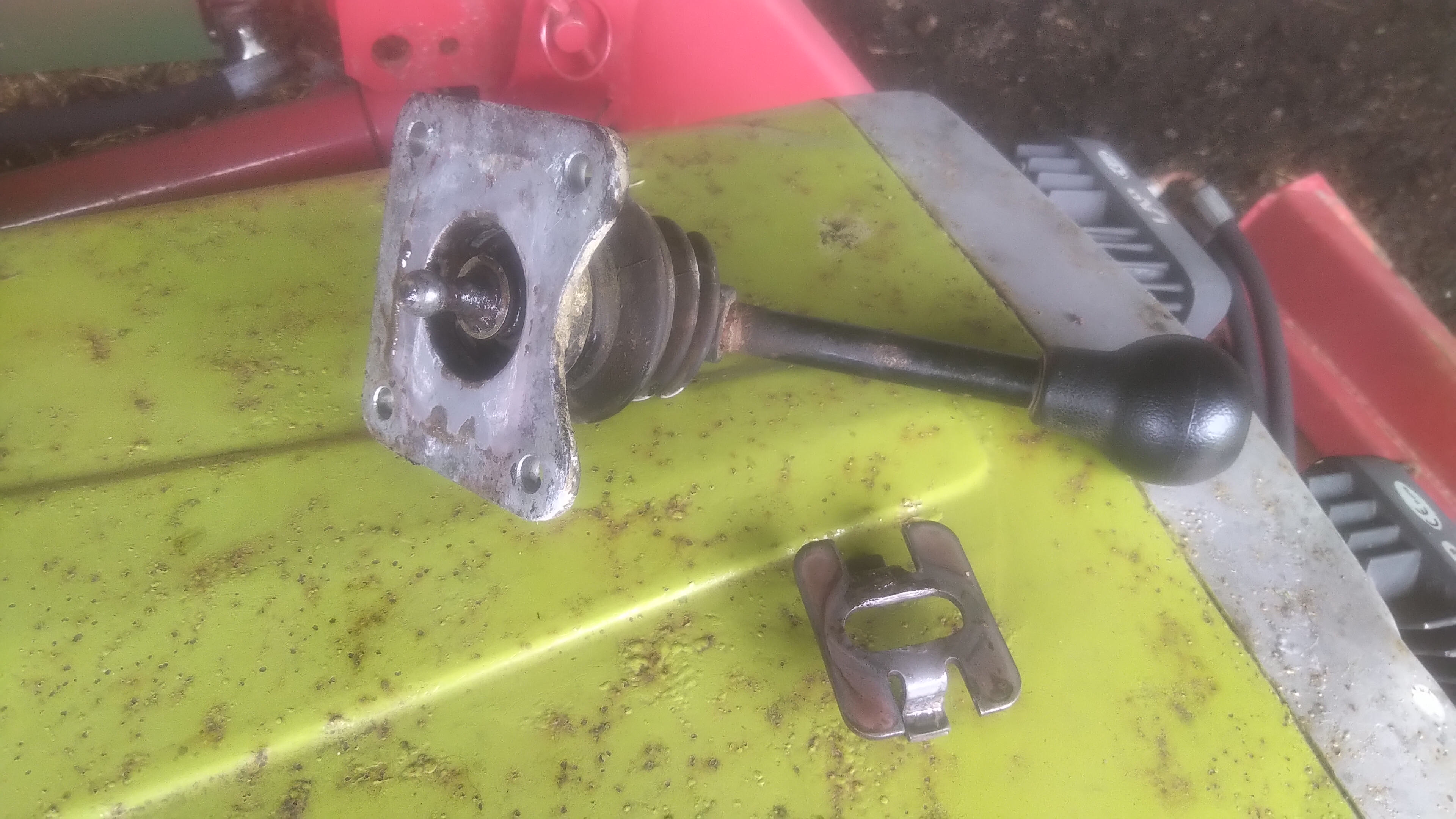

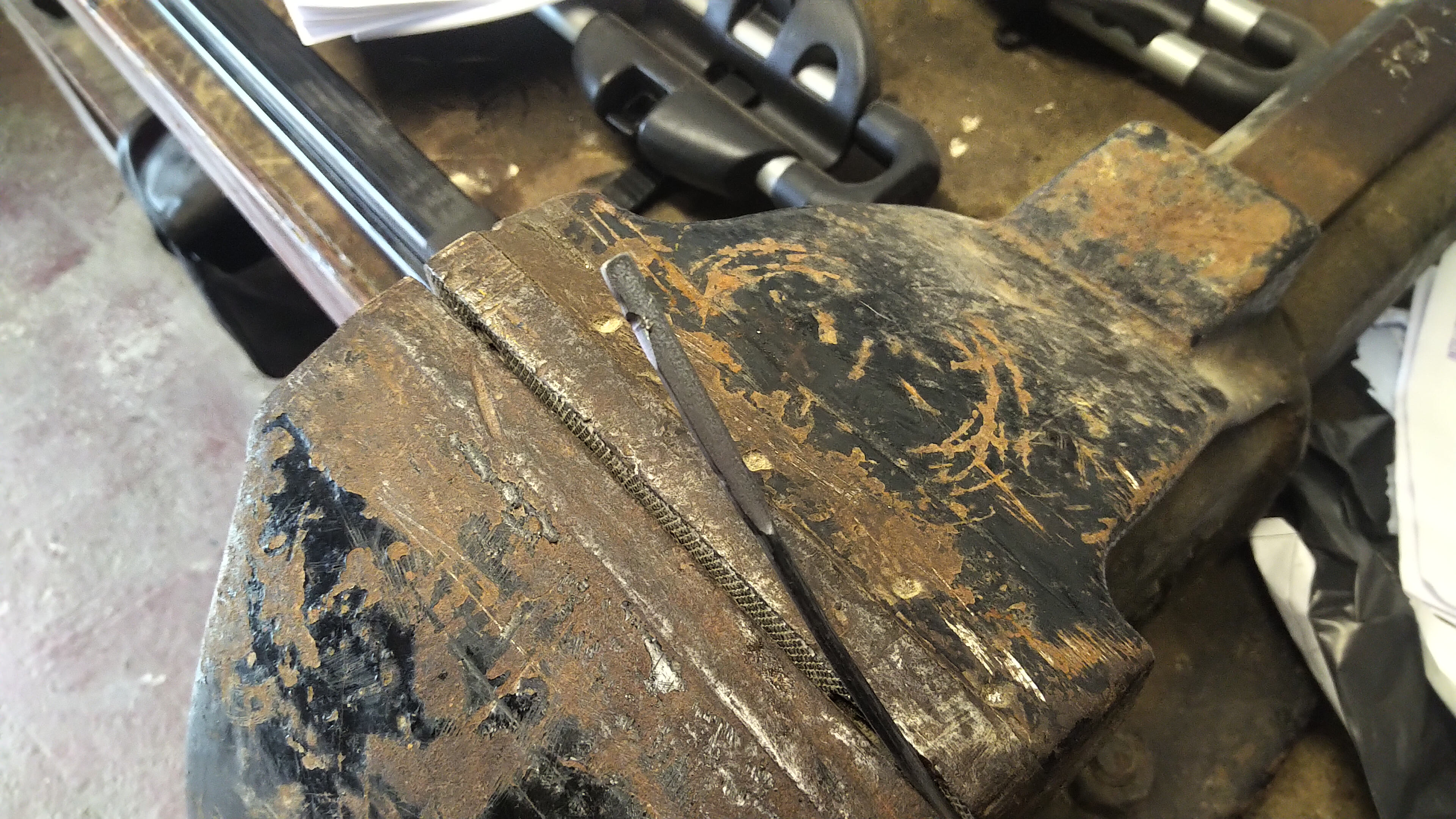

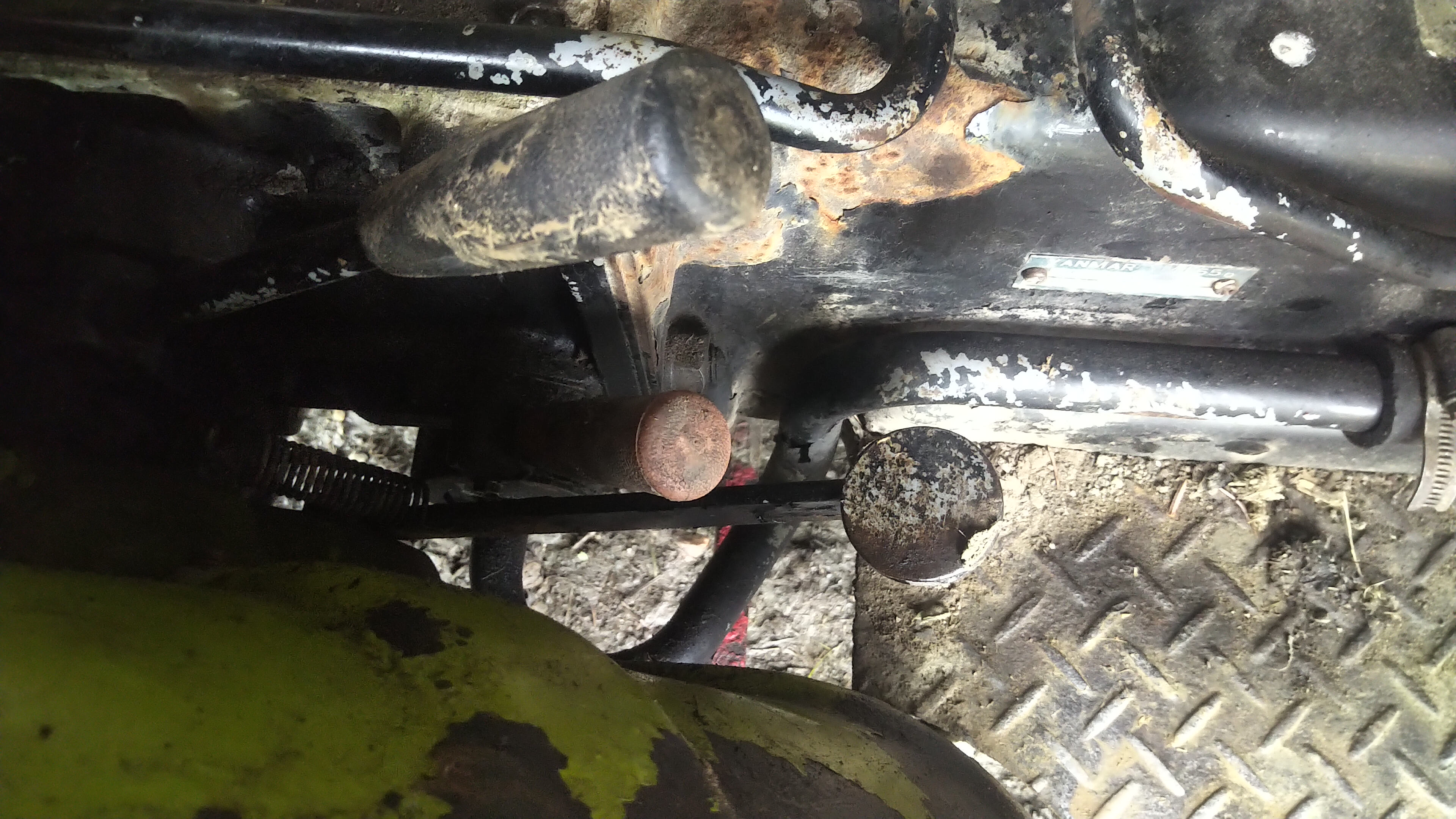

Hi guys. Thanks for your help. I was able to remove the shifter and then the transmission cover with a bit of persuasion from a mallet. The shifter cover gasket was in pretty good shape, but there was a few tears on the transmission cover gasket. I was able to retrieve the dipstick, I just reached in a grabbed it. There is a small nick out of the dipstick where it must have touched one of the gears. It was already bent and the handle was already missing, so I'll just need to make a handle out of some Sugru or something.

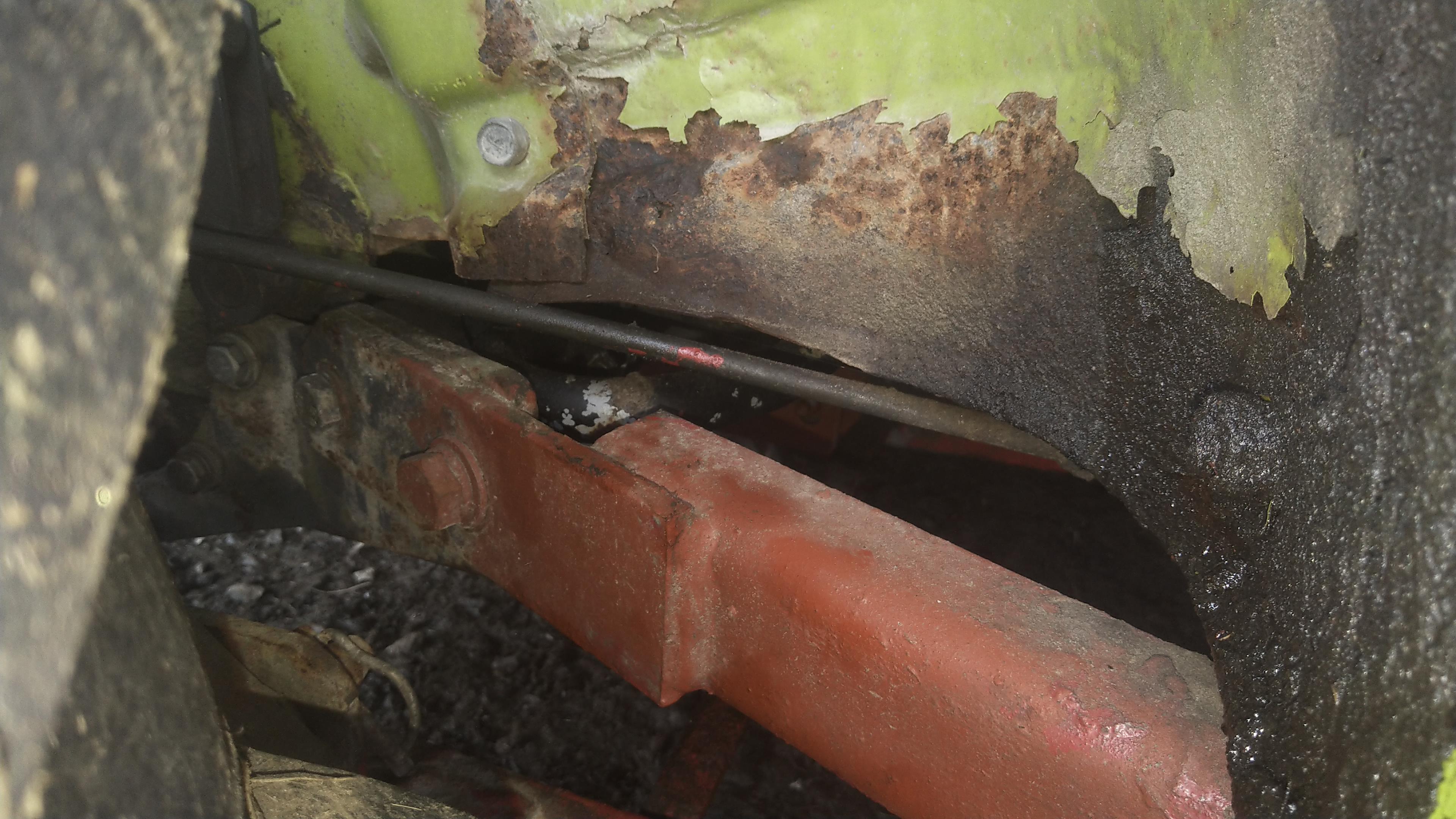

Whilst I had the transmission drained I attempted to remove the transmission filter cover. I got all 3 bolts out and was able to move the cover a little, but I am unable to remove the filter, due to the front end loader support frame in the way. I think I'll have to remove this if I want to clean the filter. The front end loader support frame is attached to the backhoe frame. Which is great that's it's nice and strong, but I don't know how easy it will be to remove. I think that's a job for another day, so I bolted it back up again. Everything else looked fine in the transmission and it's had a good flush from 2 lots of new tractor oil.
I used some sealant on the gaskets as described above and closed everything back up, everything is working fine. I've attached some pictures for reference.

Hi Steve, Glad you got the dipstick out and your problem is resolved (at least that piece of it). You shouldn't have issues with the gasket repair, they are above the oil level and the system isn't pressurized. Sounds like a ton of work to change the hydraulic filter but in the long term you'll want to do that. On my 240D, which has a FEL, the support frame has a curve in it to allow the filter to come out straight. This particular FEL would appear to have been made in Chicago but specifically for this Yanmar. Don't know the maker because the plate on it says "Yanmar, Chicago Illinois". I think it came with tractor new as a unit as it is the same colour as the tractor (same green as yours).
That is a good looking and worth the time to invest. When you're ready to tackle it perhaps you can have the FEL frame altered so in the future you won't have to go through this. When you're ready to take it on let us know and I'll crawl under mine and take some measurements and photos and post here in case it helps.
