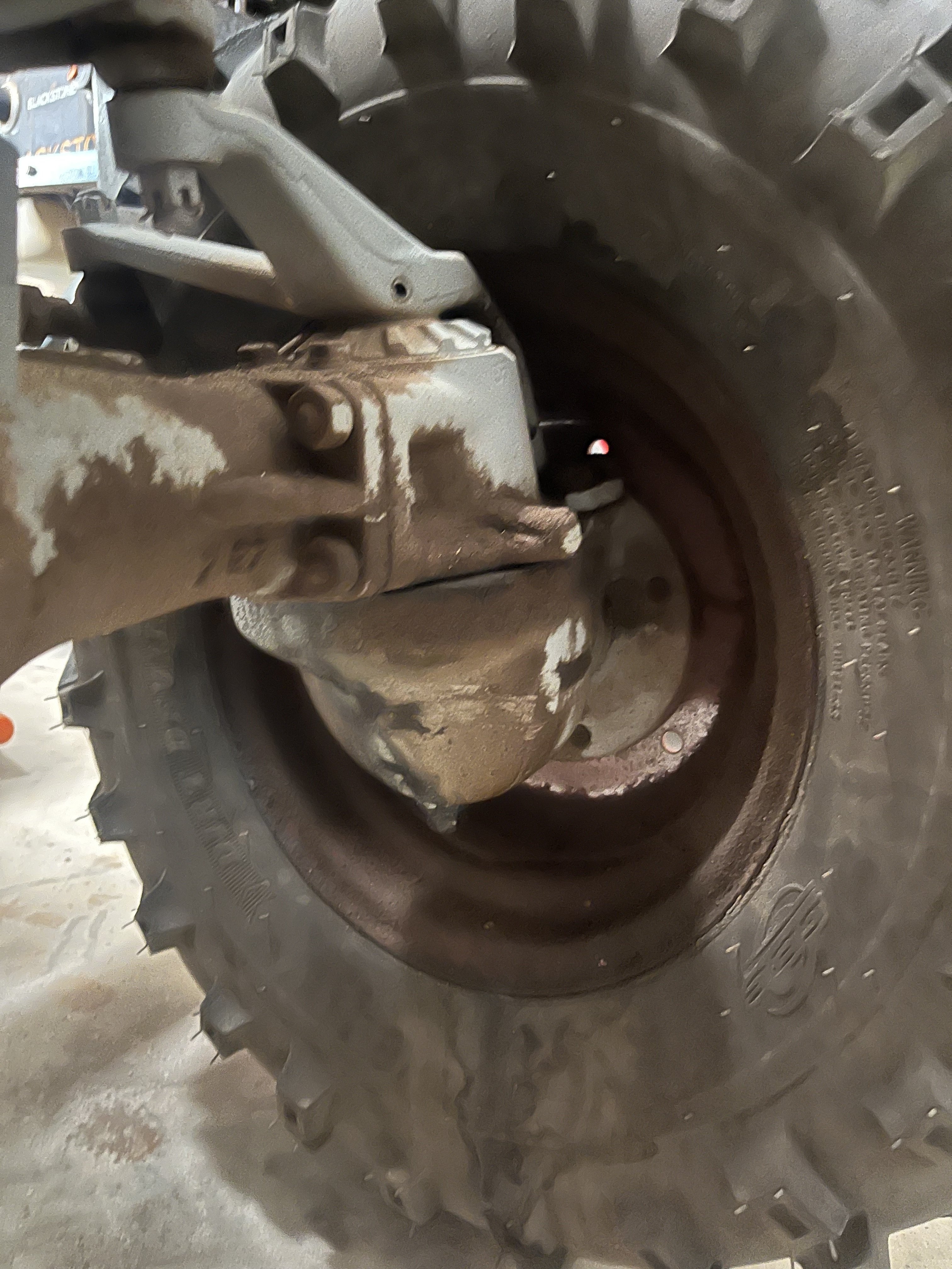

I’m having an issue with the front wheel assist (4WD) on my Yanmar YM1510D and could really use your insights. Here’s the situation:
When I jack up the front of the tractor, I can spin one front wheel by hand and the other turns in the opposite direction, but it seems like it takes a minute to “catch”.
I also occasionally hear a metal-on-metal grinding sound, but it’s not overly loud or constant. Just enough to make me concerned. It doesn’t clunk or pop; more like a soft grinding that comes and goes.
Leaking + Low Fluid
The front axle fluid is definitely low, and I suspect a leaky gasket or seal. I have noticeable oil residue inside both front wheels, so I think fluid is leaking from the hub area or knuckles. I haven’t cracked anything open yet, but I assume this could be contributing to the problem — potentially insufficient lubrication of gears.
When It Started
This issue began while I was hauling and spreading rock, so the front end was under load. That’s when I first noticed the delayed engagement and the occasional noise. Before that, 4WD seemed to operate normal.
Tests So Far
  • With the front lifted, both wheels turn opposite directions — no obvious binding.
  • I haven’t drained the fluid yet to check for shavings or signs of damage.
  • I haven’t opened the front differential or center joint yet either.
Looking for Advice
I’m hoping it’s not a stripped gear or something major. I’d really appreciate advice on:
  • Whether this sounds like normal open diff behavior or a sign of internal wear
  • How critical it is to fix the leak before diagnosing further. Any insight on how to fix the leak as well.
  • What internal parts could cause this delayed front axle engagement
  • Any tips on what to look for if I open up the front axle or center drive shaft
Thanks in advance for any help you can offer. I’ll try to get some photos of the leak area if that helps. Let me know if I should try any specific test or inspection.
— Matt

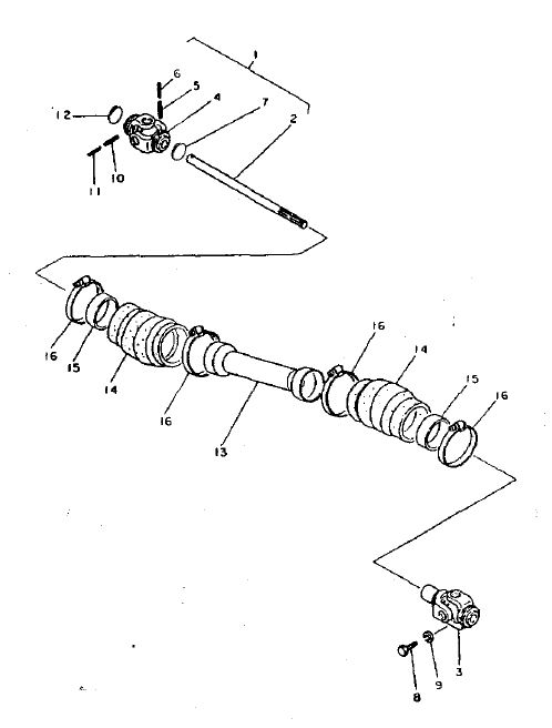

See this thread for helps. (y)

The wheels spinning opposite directions when the 4wd input shaft is unable to turn is normal. If the 4wd shaft is allowed to turn then both front wheels can (but still might not) spin the same direction. If by "a minute" you mean less than a revolution then the delay could be caused by a loose or broken U-joint allowing the driveshaft to spin a little bit before stopping. This can cause a grinding metal sound from the bad bearings and can even let the shaft contact the metal shroud causing a metallic sound. If you mean you actually have to spin the wheel multiple revolutions then it sounds like a gear has probably lost some teeth. Just a guess though.
I, personally, would not worry about the leak until I got the main problem diagnosed & fixed.
The driveshaft U-Joint would be my first suspect. If it was an internal gear then I think you would have a different set of symptoms (grinding, binding, popping, slipping). It could also be a bad or broken bearing letting things get a little loose but I think you would have more serious symptoms.
The U-Joint can be seen just by removing the 4wd driveshaft cover. If you have to take apart the differential or knuckles then just look for any metal pieces, or missing teeth on gears, or anything loose that should not be.
Running those axle low on oil (or with bad sounds) is really risky. There are a couple gears in there that are very hard to find and you do not want to damage them.

   / Yanmar YM1510D – Front Wheel Assist Not Working #5
And those U-Joints are near impossible to find. I discovered they were also used for a couple of years on the rear axles of a Honda ATV - and cost less, purchased that way.
I looked up my 2009 notes for the previous YM186D (no loader) that I sold several years ago:
HONDA ATV models:
1985 ODYSSEY (FL350) REAR SHAFT
Part # ATV300 $249
* These may fit other Arctic Cat models.
Or Ebay:
American CV
1985 ODYSSEY (FL350) Rear Axle Shafts Standard U-Joint
Price: $29.95
[in 2009]

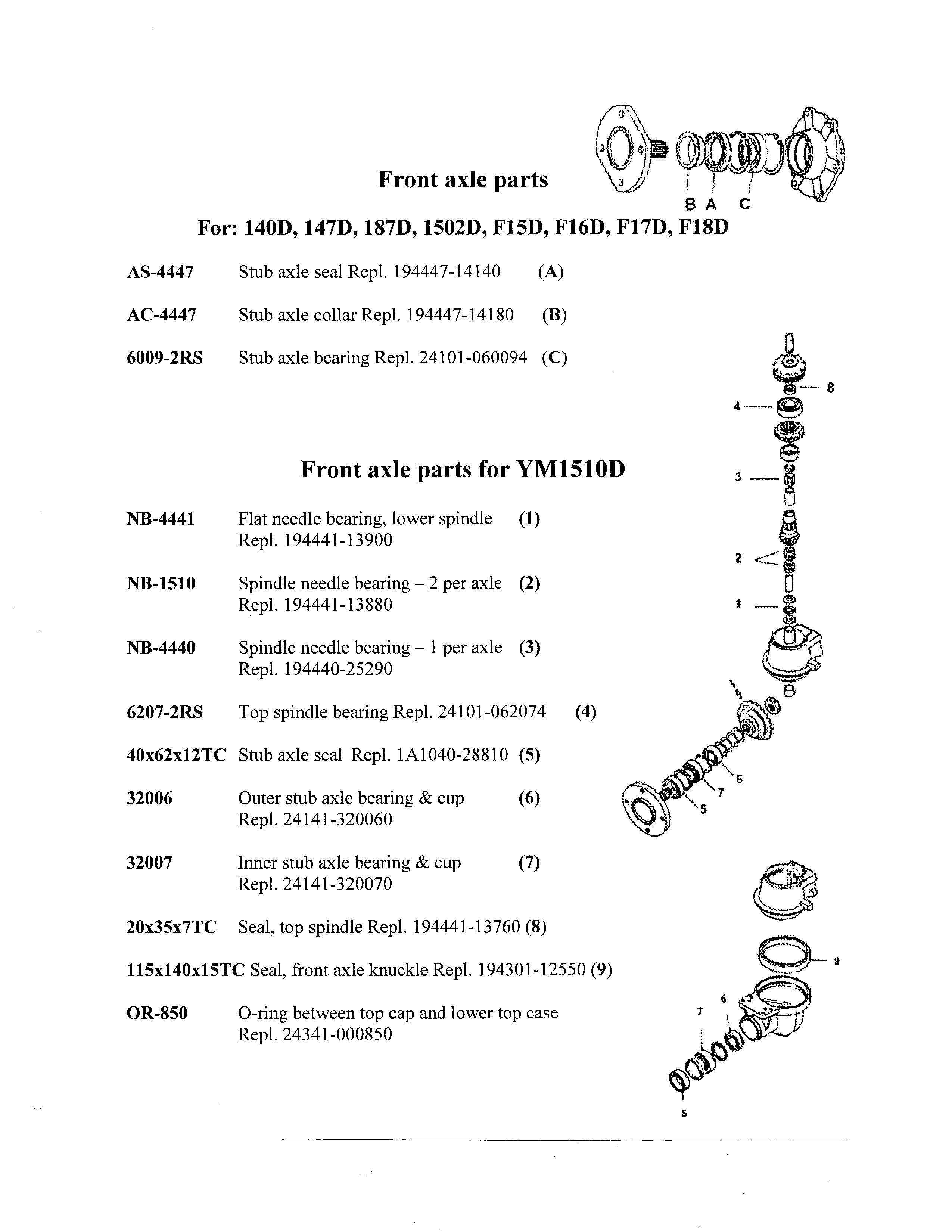

   / Yanmar YM1510D – Front Wheel Assist Not Working #6
1510D bearings and seals.
