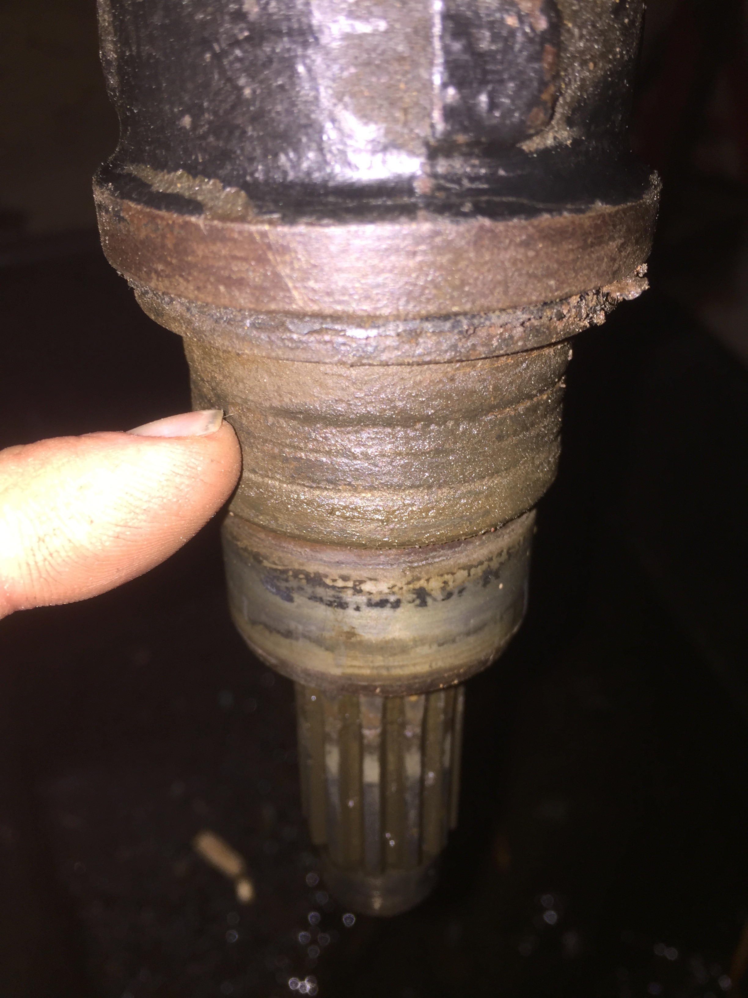

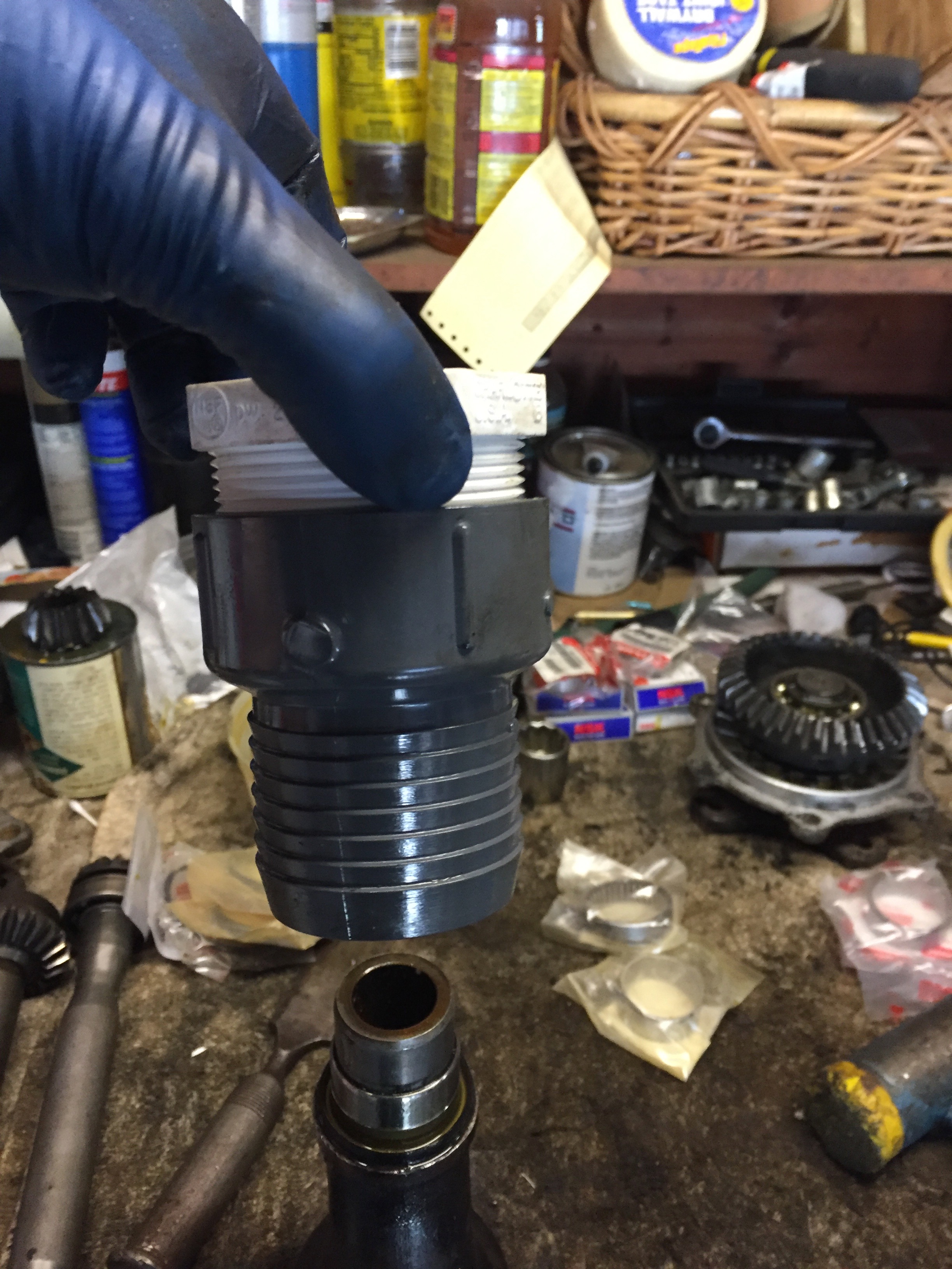

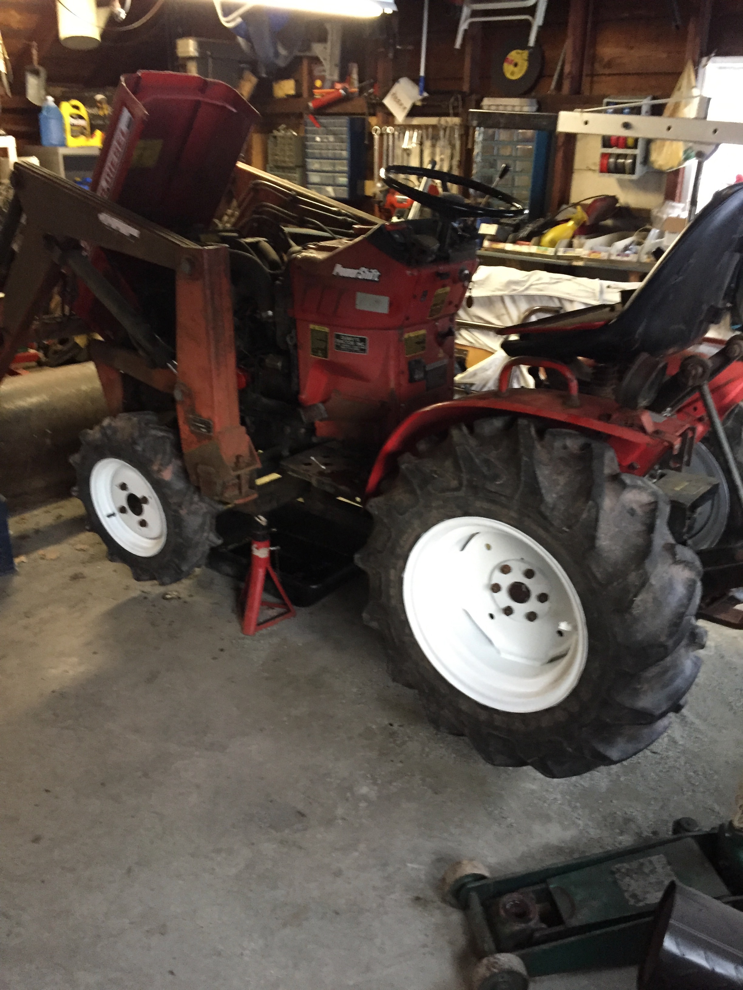

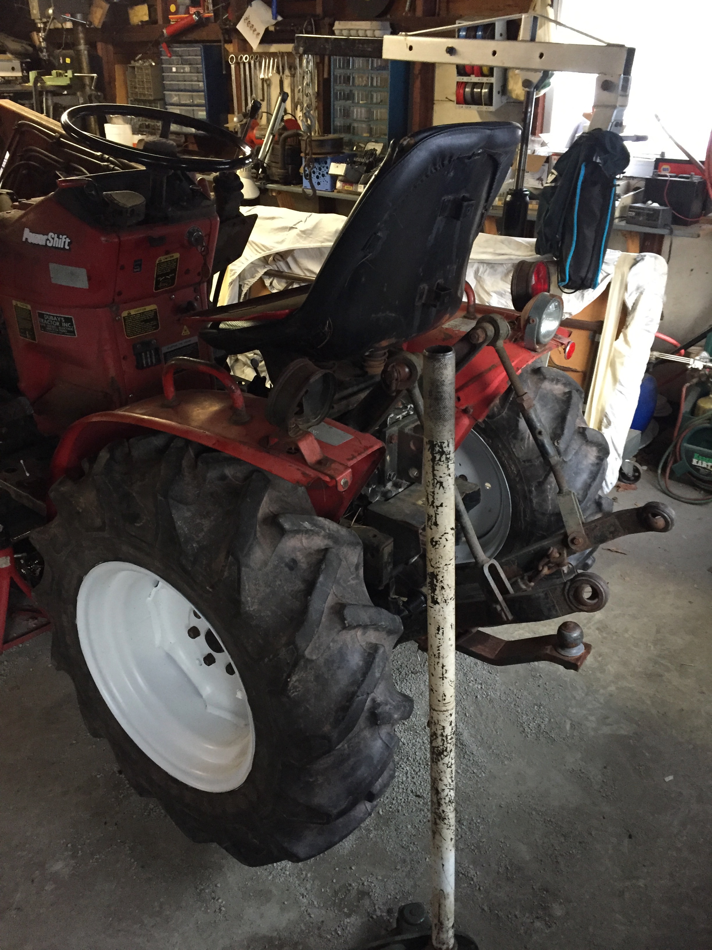

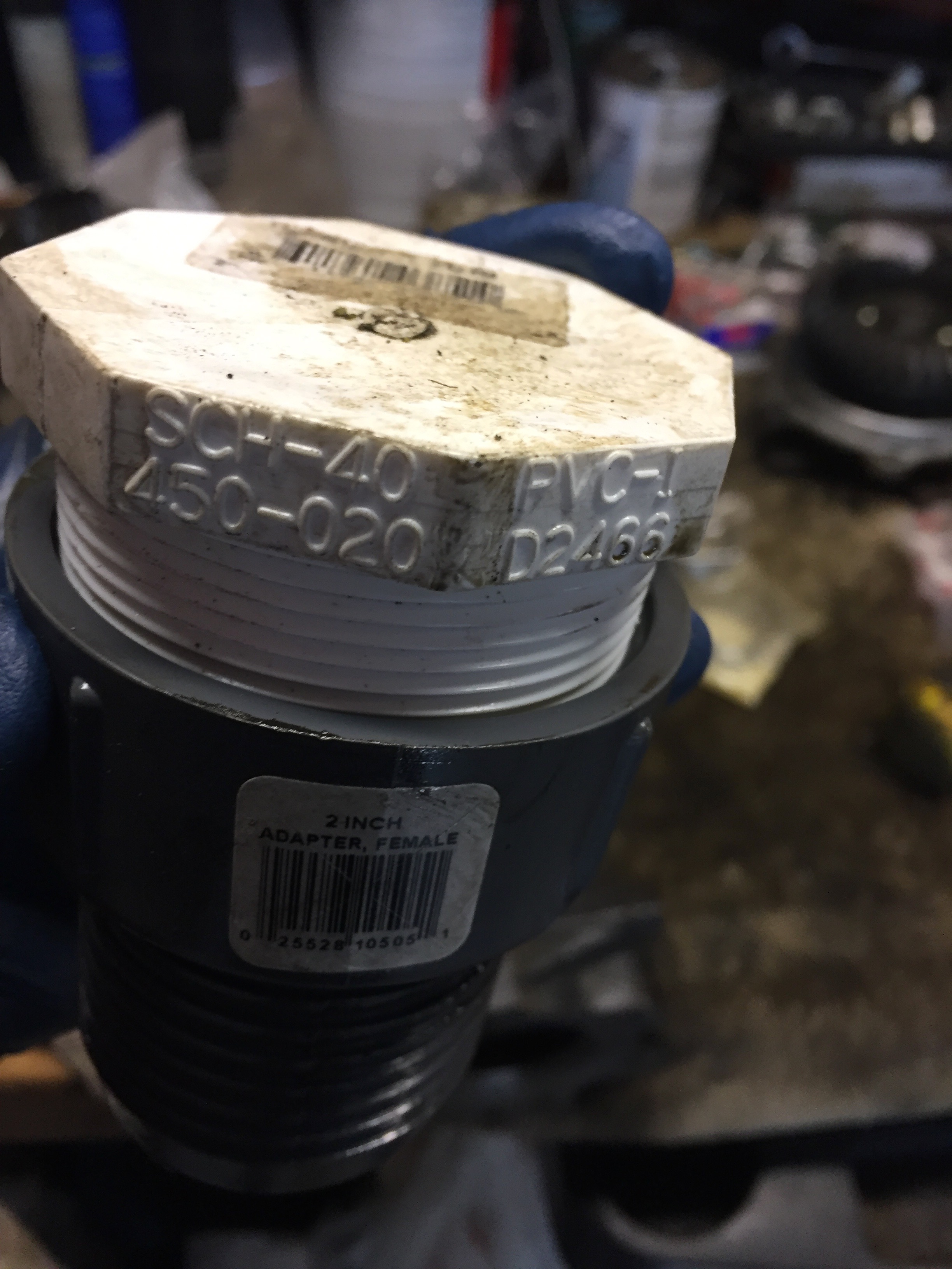

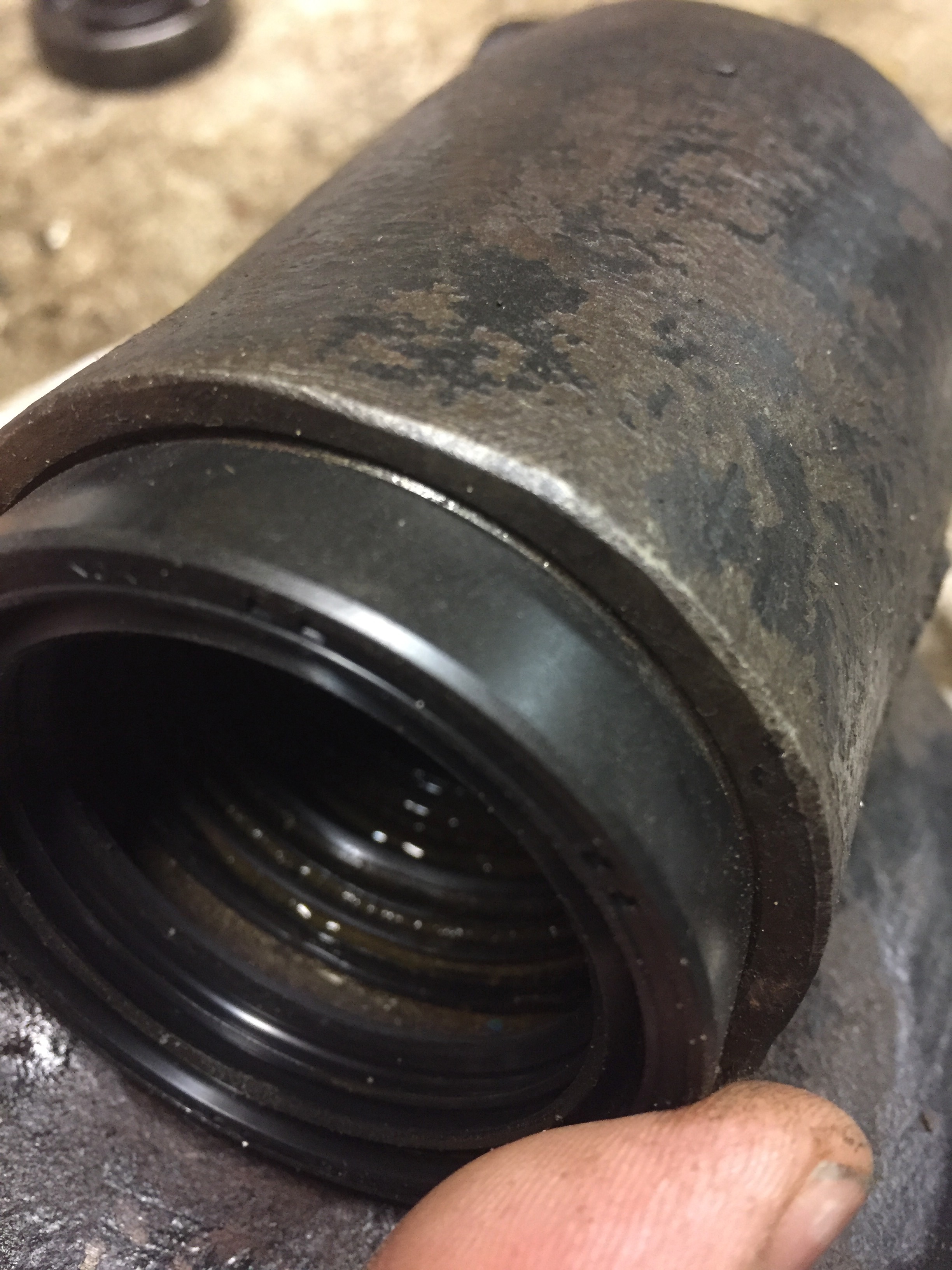

I finished rebuilding the front end of my father-in-laws Yanmar Ym147D and I thought my experience could possibly help someone in the future. includes pictures of a tool I made to install the seal collar on the final gear. I installed the tires and rims he bought after I painted the rims. Gave it a complete tuneup and overhaul. I highly recommend Jamieson tractor for all yanmar parts and Gary went out of his way to help me with my questions. We now have a brand new, used tractor that runs and looks great.
