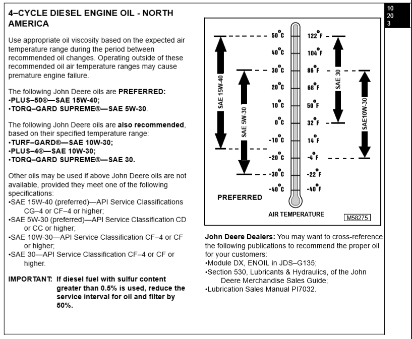

Matt, Not sure of your location, maybe far north? I'm in Southern WI. It will drop down to -20F real feel (9F) tonight. Our compact tractors can use 5W30 as the winter engine oil. This is far better starting than 15W40 in the winter. I was on the YM2610 today moving snow this afternoon in 15F weather. No issues at all on startup. First pulled the decompression cable (some models you would turn), then pulled back the throttle 1/2 way, with turning the key and the starter kicking in, I press in the decompression cable. The Yanmar fires right up. AND, the thermostart has been broken for the past 2 years. (I know, got to get it fixed.).
A coolant block heater is nice. Works best when the tractor is out of the cold wind. Is your coolant mixture 50/50 or 60/40 or 40/60 ? I've only used, 'Prestone 50/50 mixes with everything extreme cold temp coolant'. It's not frozen up at all. The YM2610 sits in a lean-to. (3-sided walled shelter, open in the back away from the wind.)

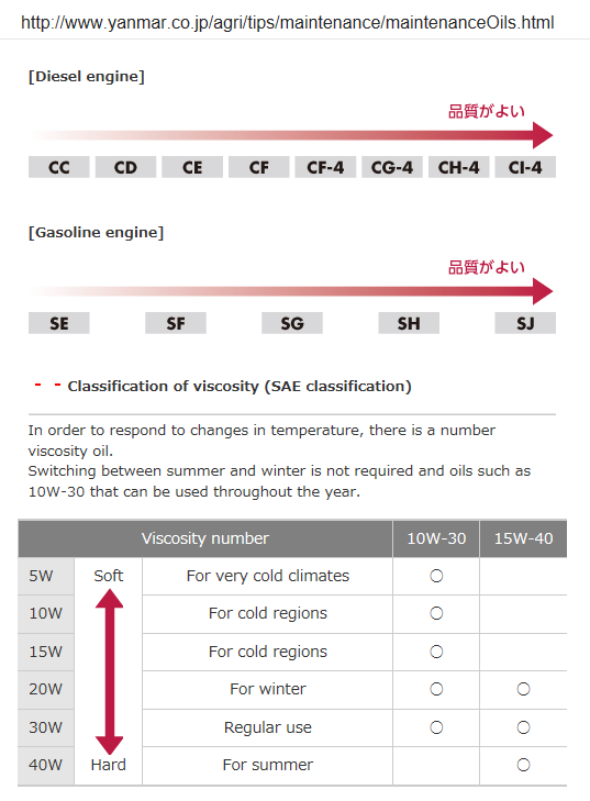

Matt, Are you in the arctic circle or lower? I have friends in Kotzebue, it is fricking cold there.
For oils, yes, the 5W30 is the winter use. Does well for +70F to lower into the -minus temps. Depending on where you live, this may be the only oil grade to use for you. :cool:
Engine size wise, your YM1110 is a 2-cly sort of like the JD650.
Here are the 2 known oil to temp charts I'm aware of.
