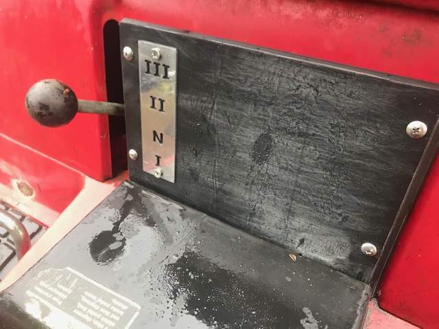

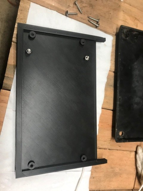

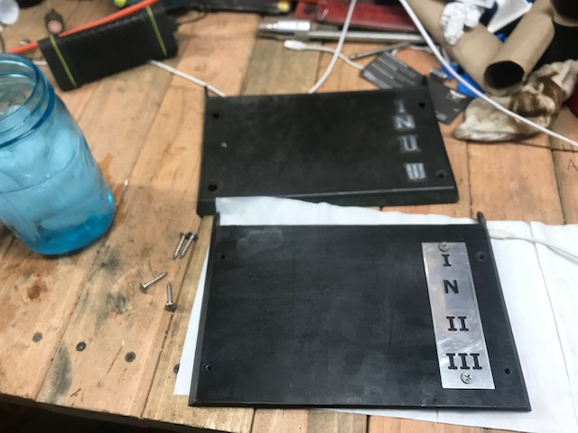

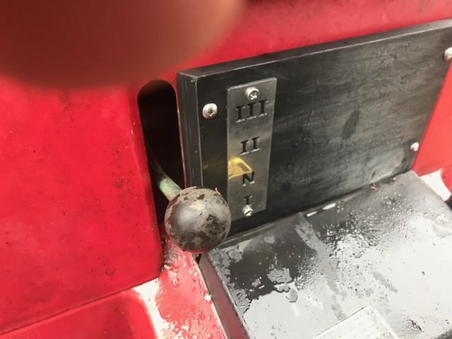

I created and printed this shift-plate cover for my Yanmar YM-146.
I used an Ultimaker 5S to print and designed using Tinkercad. I already had a plasma cut plate for the shift positions so I attached that to the plate. The plate is much tougher than the original which cannot be purchased and is almost always cracked. I am creating a custom dash cover now that will be a combination of 3D printed and plasma cut metal parts.

I used a material called tough PLA made my ultimaker. It took 2 days to print at the 0.1mm setting so the quality was pretty good.
I just finished creating the bottom part of the dash and have that on the printer now. It will take 5 days to print. Tough Ultimaker Tough PLA material: Create durable prototypes and tooling
