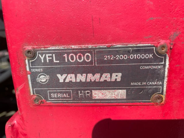

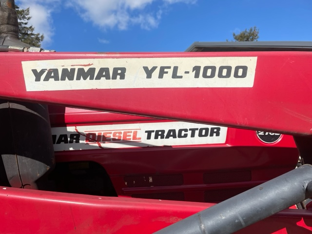

Here are a couple of photos:

The main differences are three things:
The control valve was markedly improved.
The seals in the cylinders were improved.
And rear reinforcing rails that went all the way to the drawbar were added.
This was the same for the YFL 800 and YFL875 for the YM220/226; the YFL
1500 and YFL1575 for the YM336.
