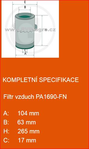

Does anyone know a replacement filter for the F22D air filter such as Napa, wix, or Fram? I can't find any reference to even the original air filter numbers. I have no numbers to even cross reference with. Hoyle only carries theirs and want 30 bucks plus 12 bucks shipping and won't give me any cross reference numbers they want to sell only theirs.
   / Yanmar tractor parts-Air filter/Fuel filter #10
air filter Yanmar F22
15521-1112-0
C 1188 MANN-FILTER
WIX 42276 Air Filter
