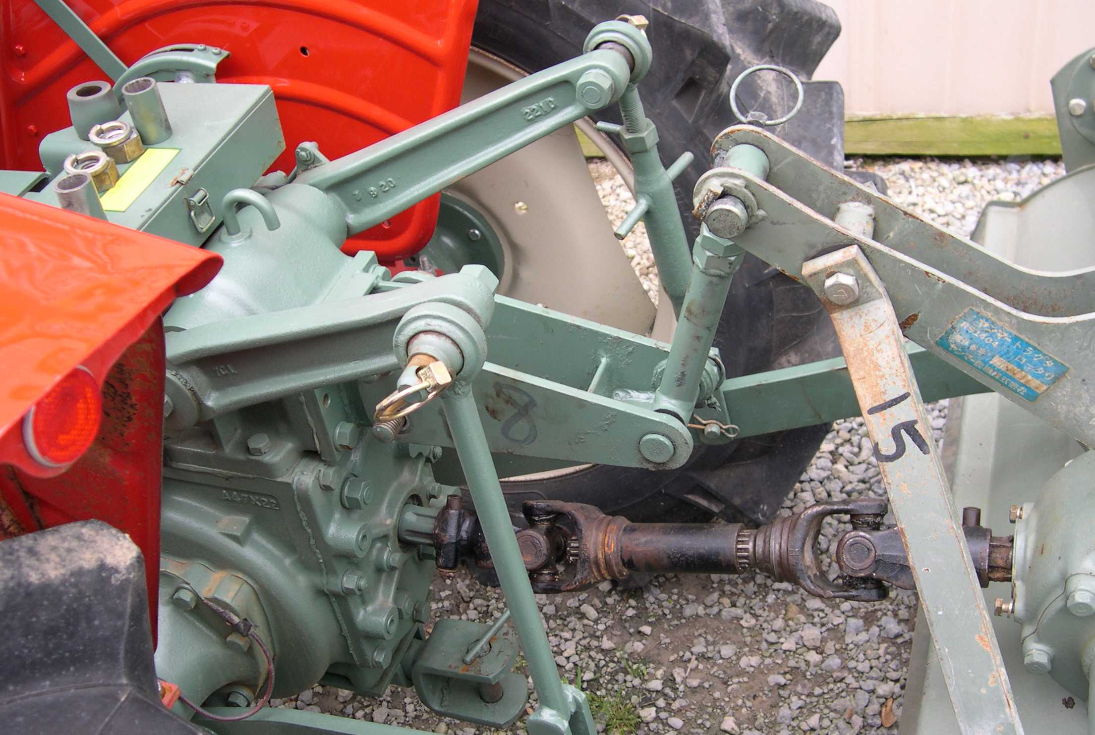

does anyone have a picture or two of how the tiller is set up. each time I start tilling and acutally get into the ground the angle on the shaft at the u-joints it too tight.
I'm thinking I must not have things set up right.

Is this a 3 pt hitch tiller???

Try this.

OK thanks that is the picture I needed. It looks like I have the top bracket on upside down. I'll try that later today and see if it helps.
thanks for the pict.

Consider downloading and saving the picture for next time. It gets confusing when you do it once a year.
