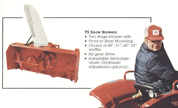

Followed your advice on the Ber-Vac, now RAD-Tech. Searching the web, there are FREE manuals galore for these machines. The real open question is, what model is close or exact match to the Yanmar models?
In the Yanmar brochure, these are listed ...
   / yanmar snowblower #10
FOUND 1. The 51" and 63" Yanmar Snow Throwers by Ber-Vac, a RanTech Co.
rScotty brochure on the inside pages had the image I had posted earlier. That's 2 of the 4 sizes!
After searching the eBay to see what the cover page should be, I retro-fitted a nice clean one.
Basically many of the tractor manufactures got the same snow thrower back then, just painted differently. For the manual, the first page was the tractor company followed by the Ber-Vac on page 2 till the end.
Enjoy!
