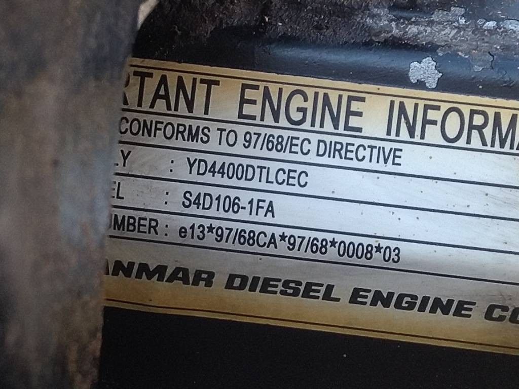

S4D106-FA is Komatsu's model no. for the engine.
Yanmar's model No. is 4TNE106D. This might help you find more info about it.

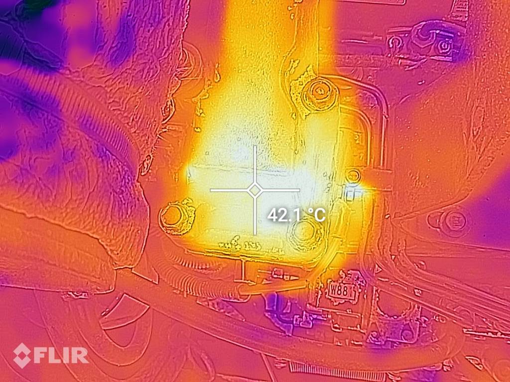

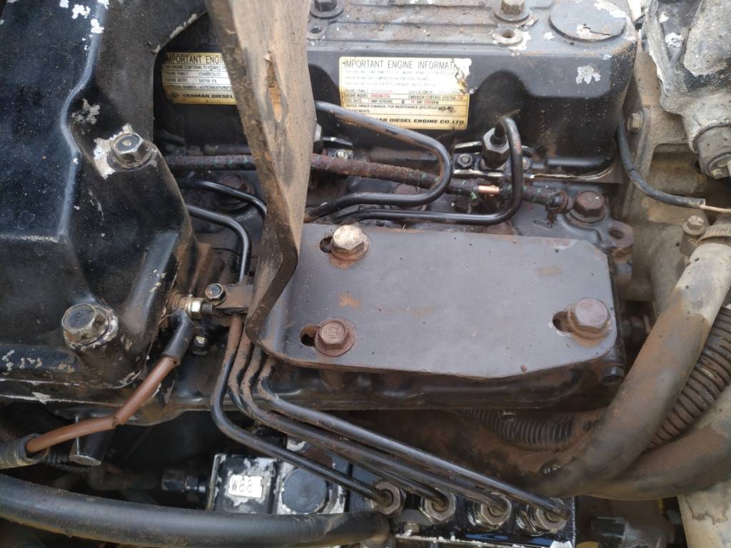

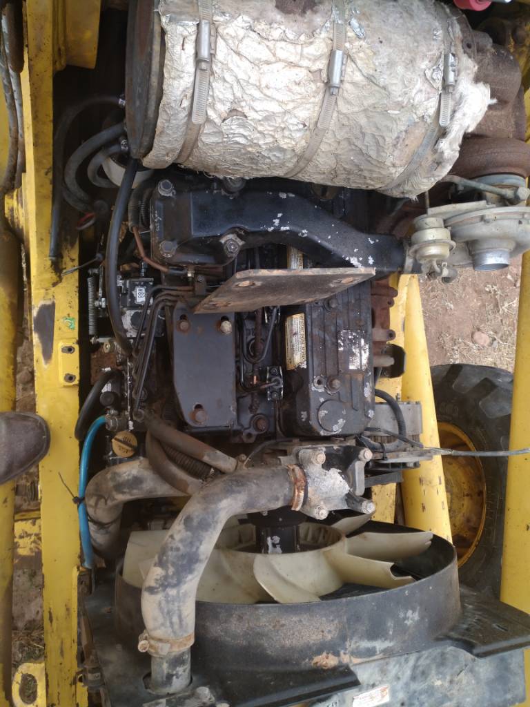

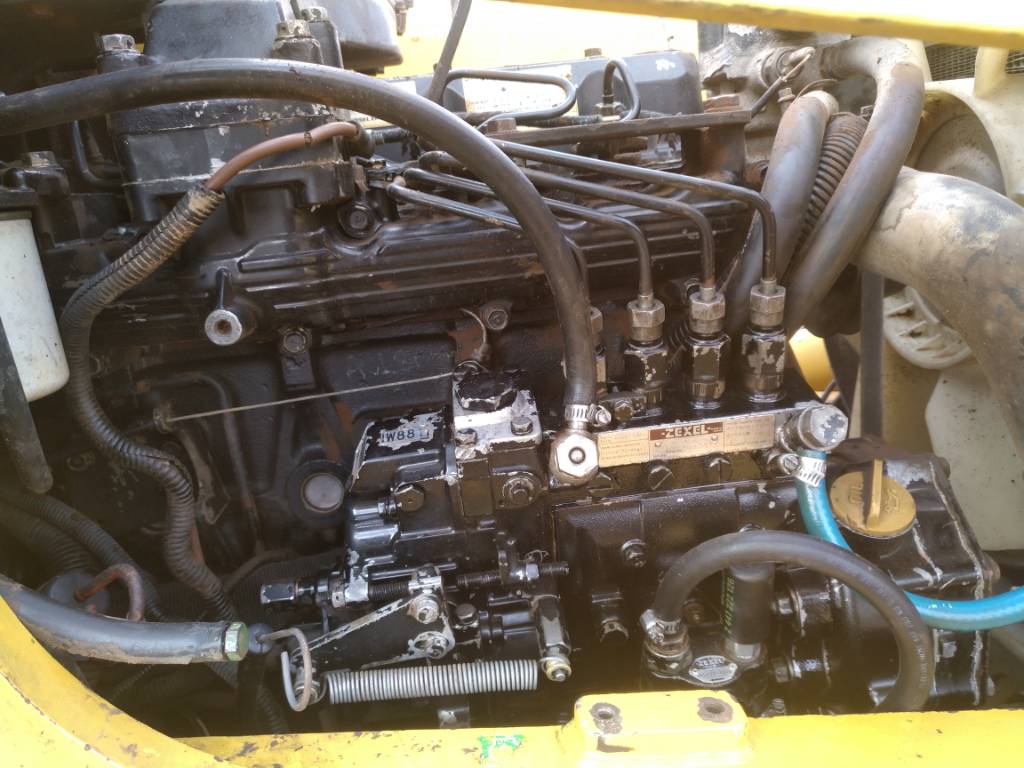

My Yanmar engine in Komatsu tlb. I have removed air filter to get to injectors to bleed off the air. Still battling to start. Last photo of air-intake after pre-heater activated IMG_20200912_152808.jpgIMG_20200912_152820.jpgIMG_20200912_152758.jpgIMG_20200912_152826.jpgIMG_20200907_152924.jpgflir_20200912T152729.jpg

How do you shut down the engine (if you get it running)?
Most Yanmars shut down either by pulling the throttle lever all the way back, or by pulling a cable that goes to the injector pump. Perhaps your linkage/cable is not releasing from the shut down position when you try to start.
Try spraying the injector pump area with a penetrant/lubricant such as Liquid Wrench or even with WD-40. Especially on the lever on the pump where the throttle linkage connects.
From your picture I'd say your Thermostart is working!!!

Thank you, normal shut is with cable to injector pump. Will check that out as it looks a bit tacky there. Will update tomorrow
