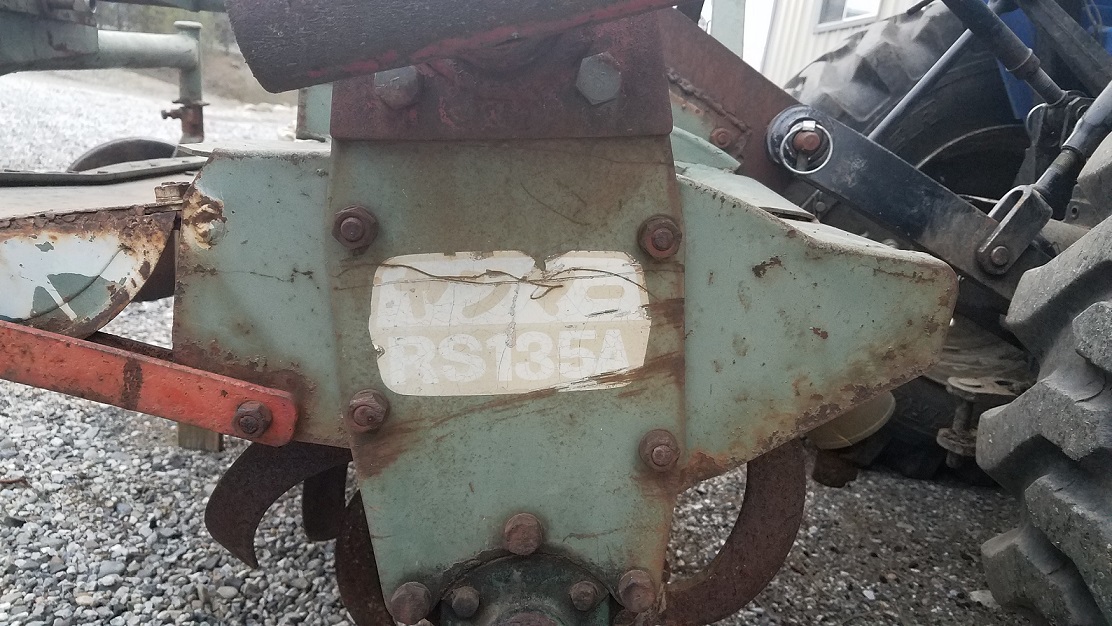

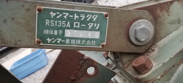

Neighbor had this tiller sitting under a tree. Servicing it so I can use it. Found Yanmar cast into the side of the housing and RS135A on a label. I assume that is the model type. Not finding much info on it. Basically I need tines for it. Drained the fluids, will refill and see what happens.
Thanks for the Help!
Nick

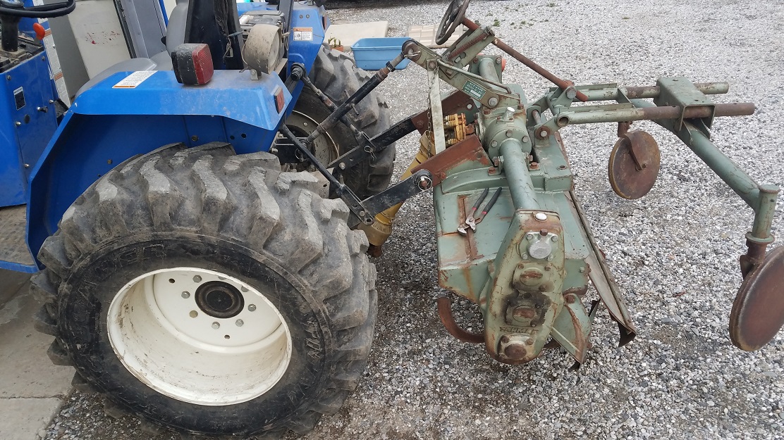

I think what you have there is a standard RS-series tiller but the version that mounted semi-permanently to a custom mount found only on Yanmars. Then someone cut off the custom front extension and welded on standard 3-point 'ears' to convert it to a universal 3-point implement. That's not a problem, just a 'feature' :) - beyond perhaps needing a custom length driveshaft.
Yanmar at the same time also made a lot of RS tillers with standard 3-point configuration, RS1300 is 1300mm wide and RS1400 is 1400mm wide. These were sold up through the late 70's (?) then they went to red paint and '1401' etc to distinguish the next series.
My guess is your RS135 is 1350mm wide. Aside from the welded on mounts it looks identical to my RS1400, see my sig photo below. I'm pretty sure yours shares parts with the 3-point RS versions.
As for tines, the Yanmar tines are more slender than an American tiller, they have more of a slicing action that was probably to cut up rice roots, since the original application was to till rice paddies. But they work fine for an American vegetable garden or small farm. I don't think a few tines missing makes much difference at the slow forward speed used for tilling. Hoye dot com has tines if you need them.

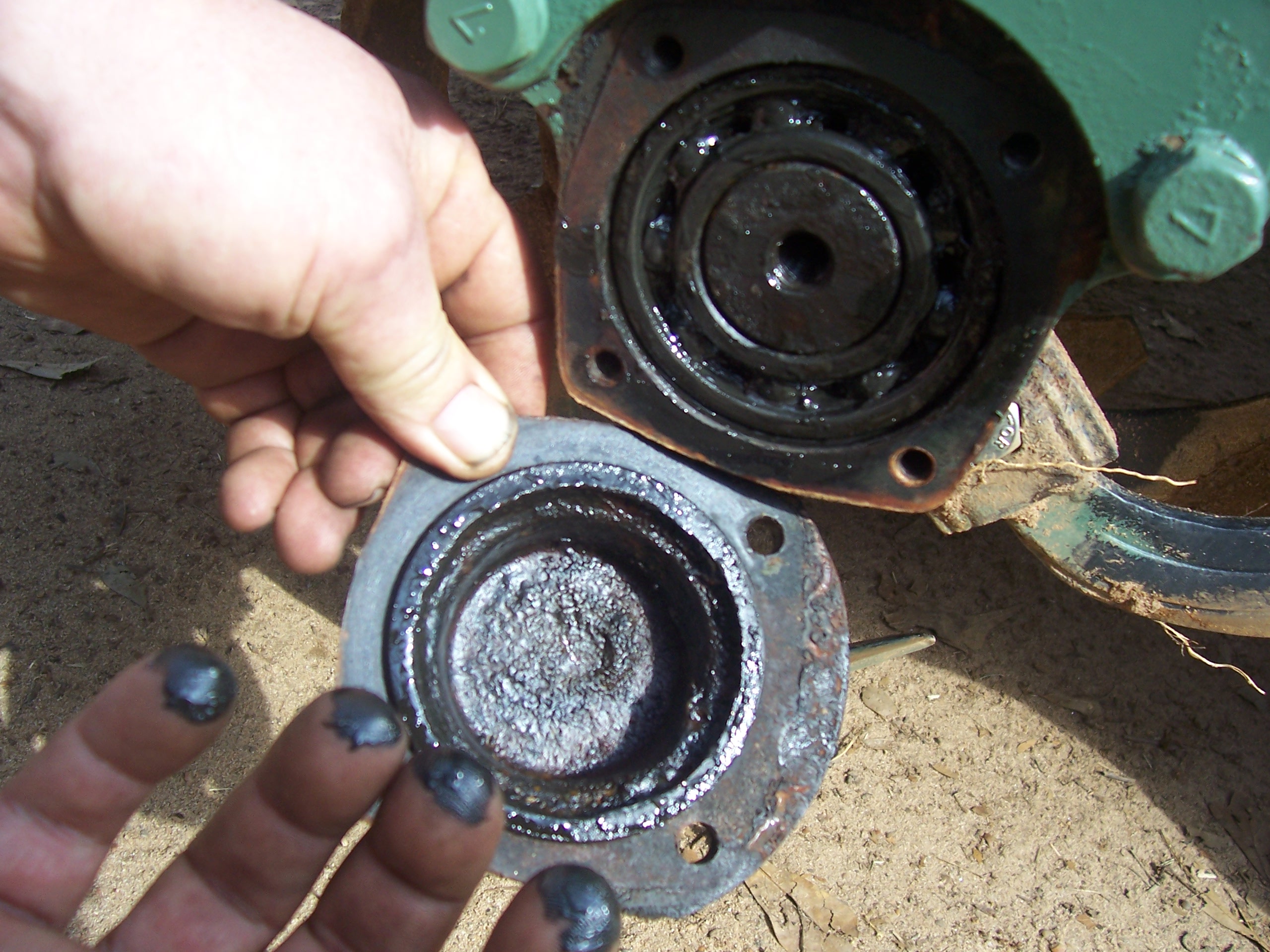

These tillers always have water in the bottom of the gearcase due to 40 years of condensation. (Plus a first application of running half submerged in a rice paddy). It is recommended to drain and refill the gearcase a couple of times to get the water out. Normal 80~90 wt gear oil. And the bearing over on the non-driven end of the tine shaft is often found to be rusty. If it seizes it will tear up the mounting area. So dis-assemble that side and repack with wheel bearing grease, or better, marine water resistant grease. It's a standard bearing if you need to replace it.
One last point: I see your rear 'training wheels' (depth control) are mounted with the part that extends down to the axle, like half a bicycle fork, on the inner side of each wheel. I learned I had to swap wheels to put that half-fork on the outside before the wheels would track properly through a curve. That's counter-intuitive because they are more likely to gouge my orchard trees that way - but that is the configuration shown on the decal on my tiller. And I do like the wheels for depth control, because my smaller tractor can be stalled if the tiller goes too deep.

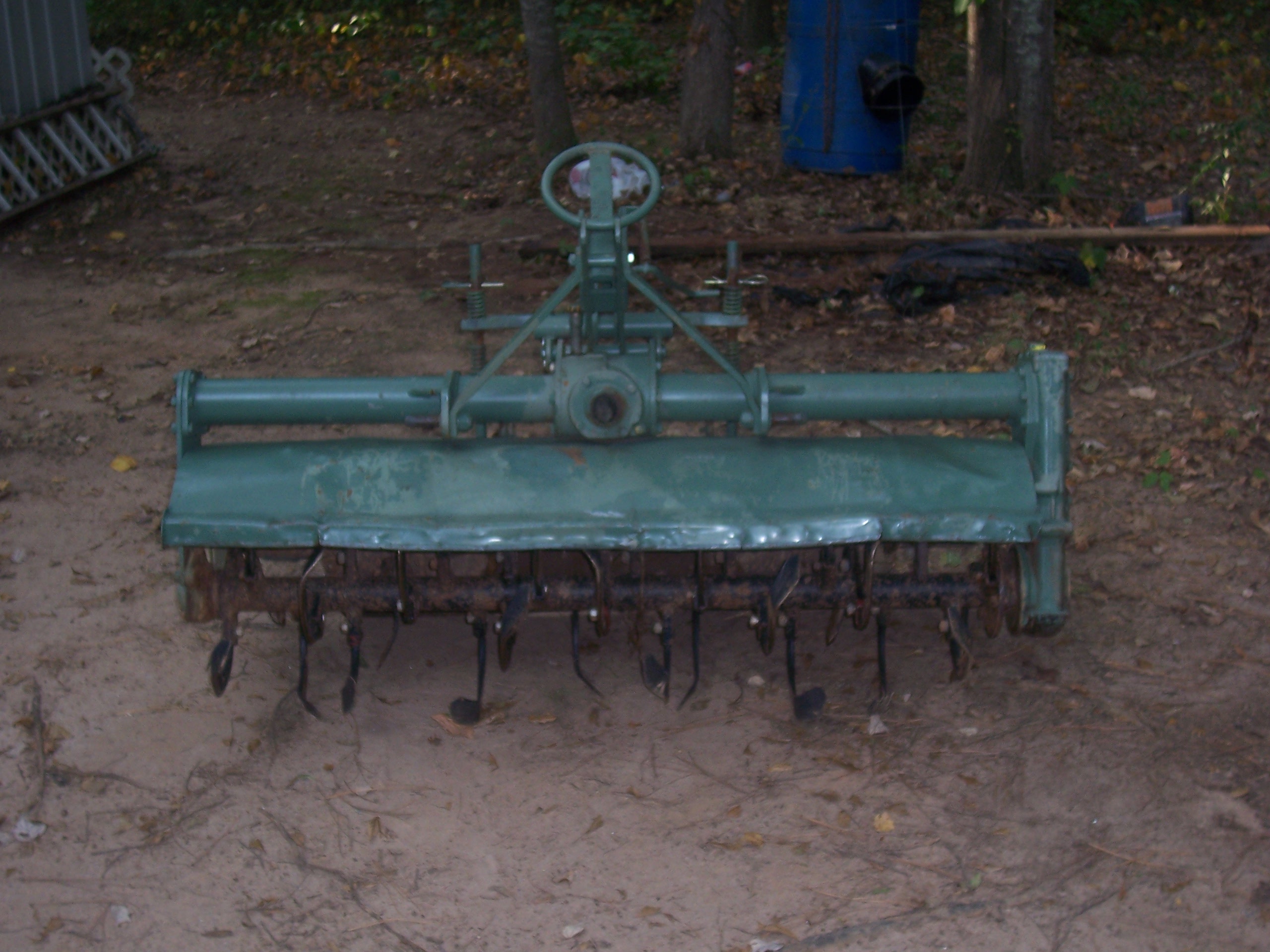

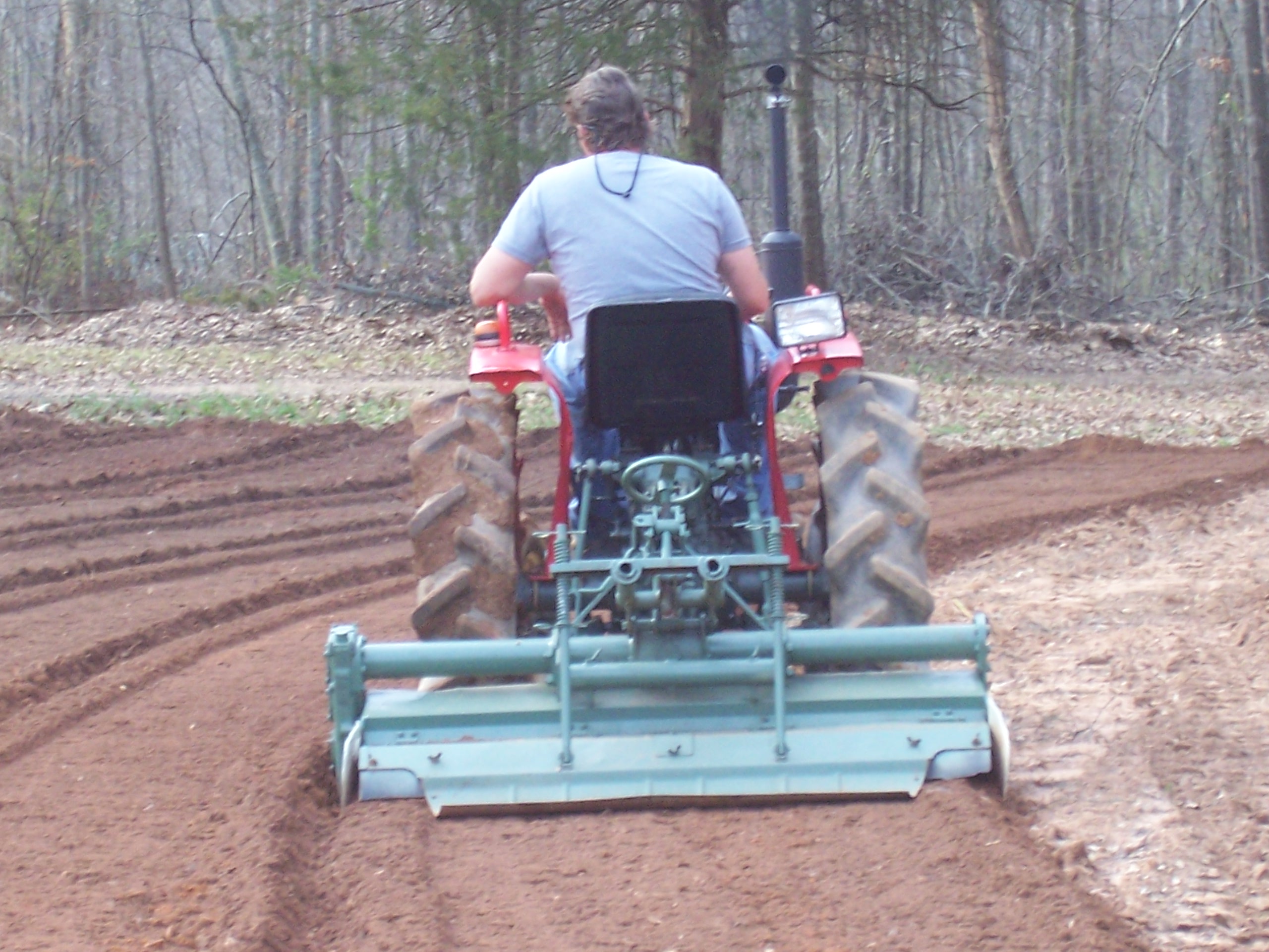

I kept A 1400 Series which is what Fredricks called it. Worked great for the time I used it on my mothers Garden with a Ym.2000. 20Hp.@ the pto. and new Tines. The pic. is a first turn of the Yr. I read on here Yrs. ago about the Bearings not long after I bought it and wasn't happy in what I found.

I did give it a test run. Over 50% are missing and most are on one side. These were some the owner bought, had to grind them down to fit. Most fit loosely in the slots too.
Nick
