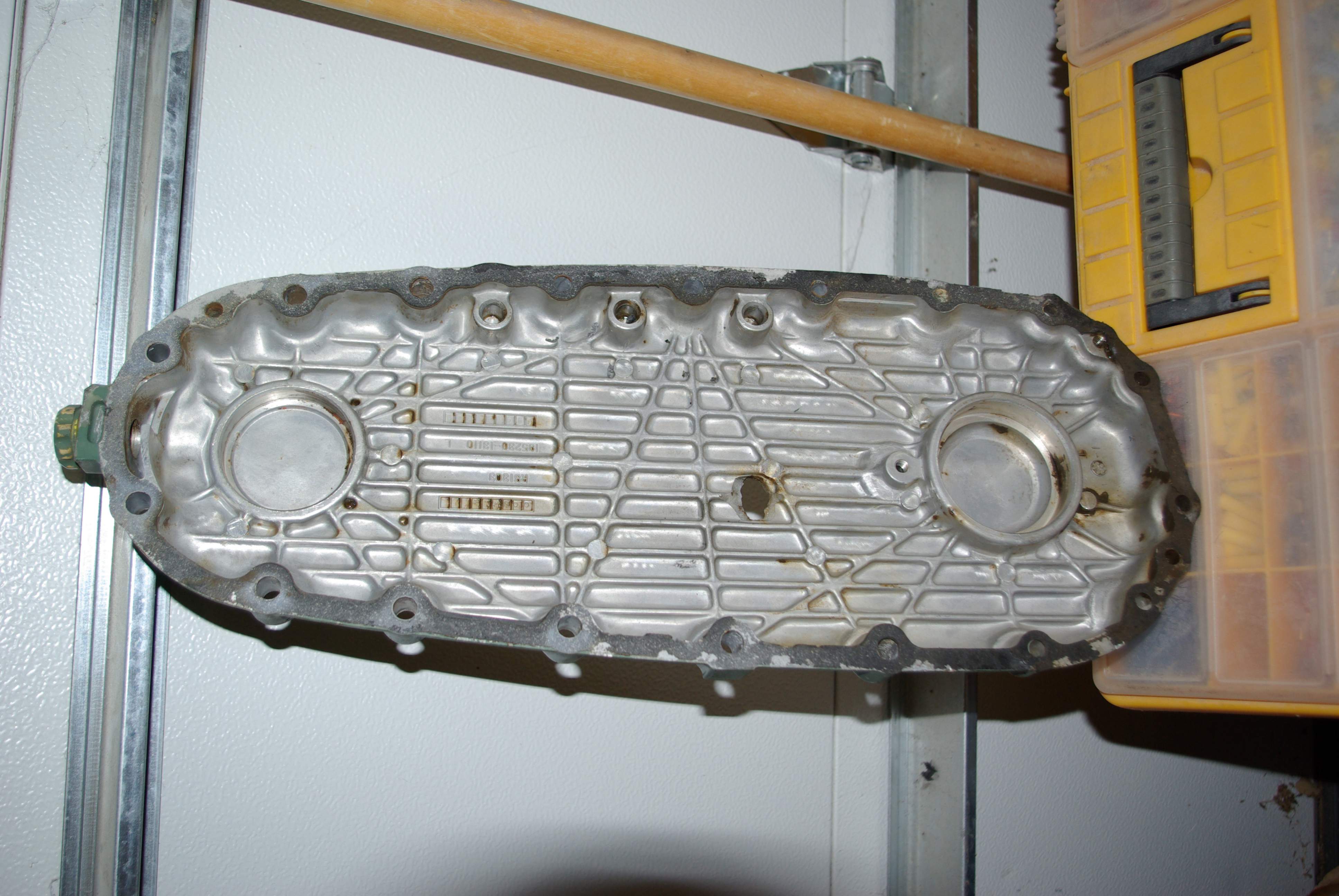

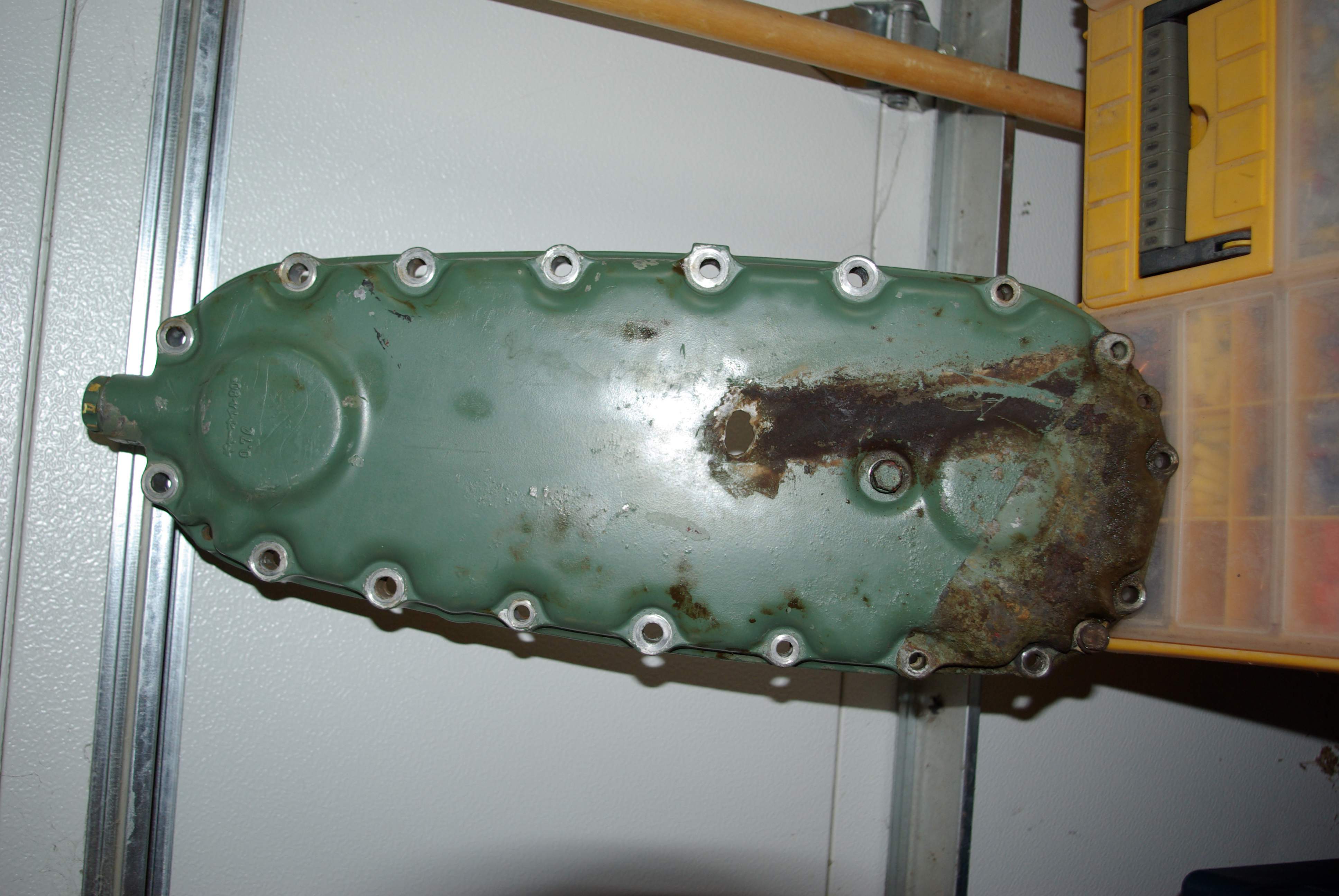

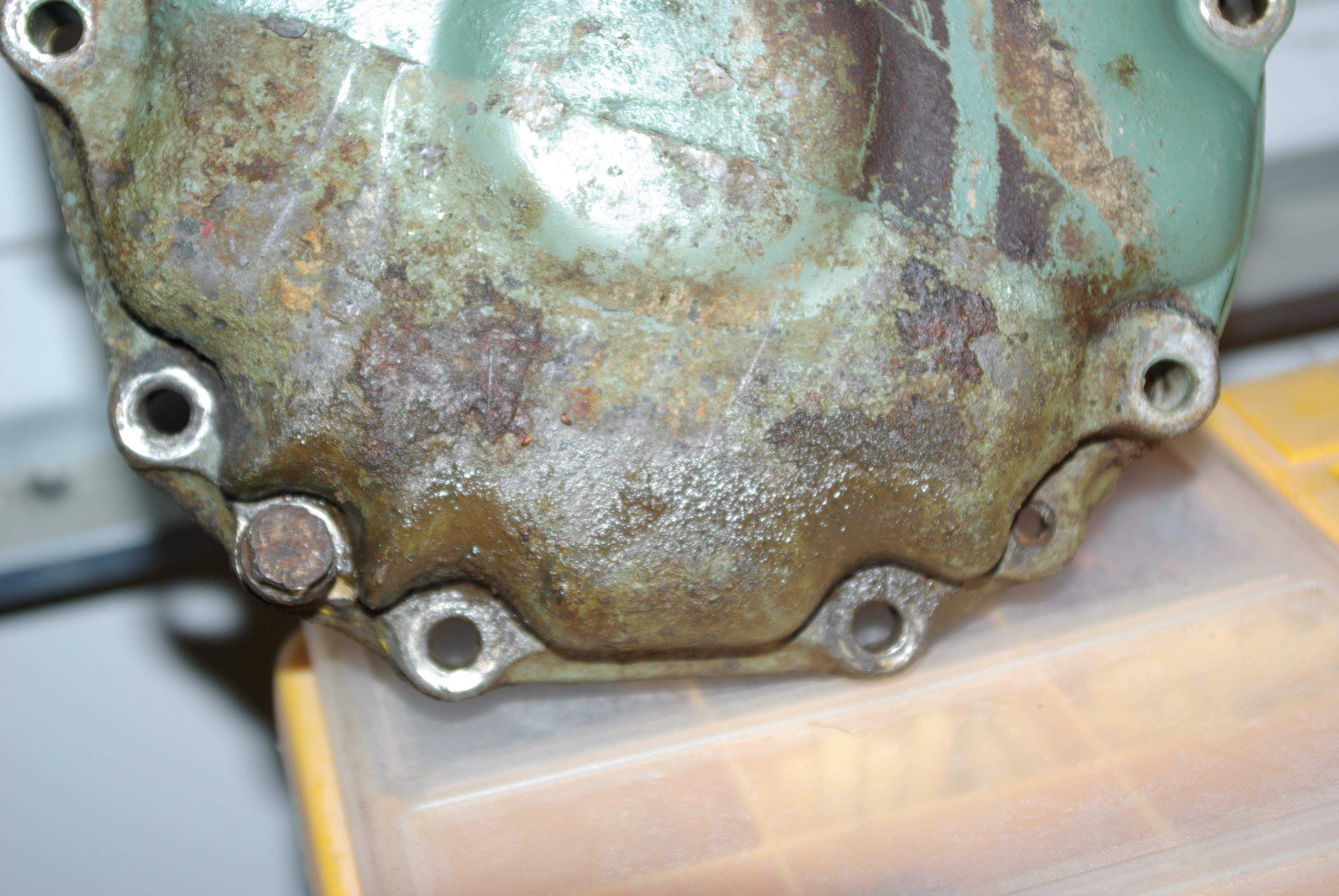

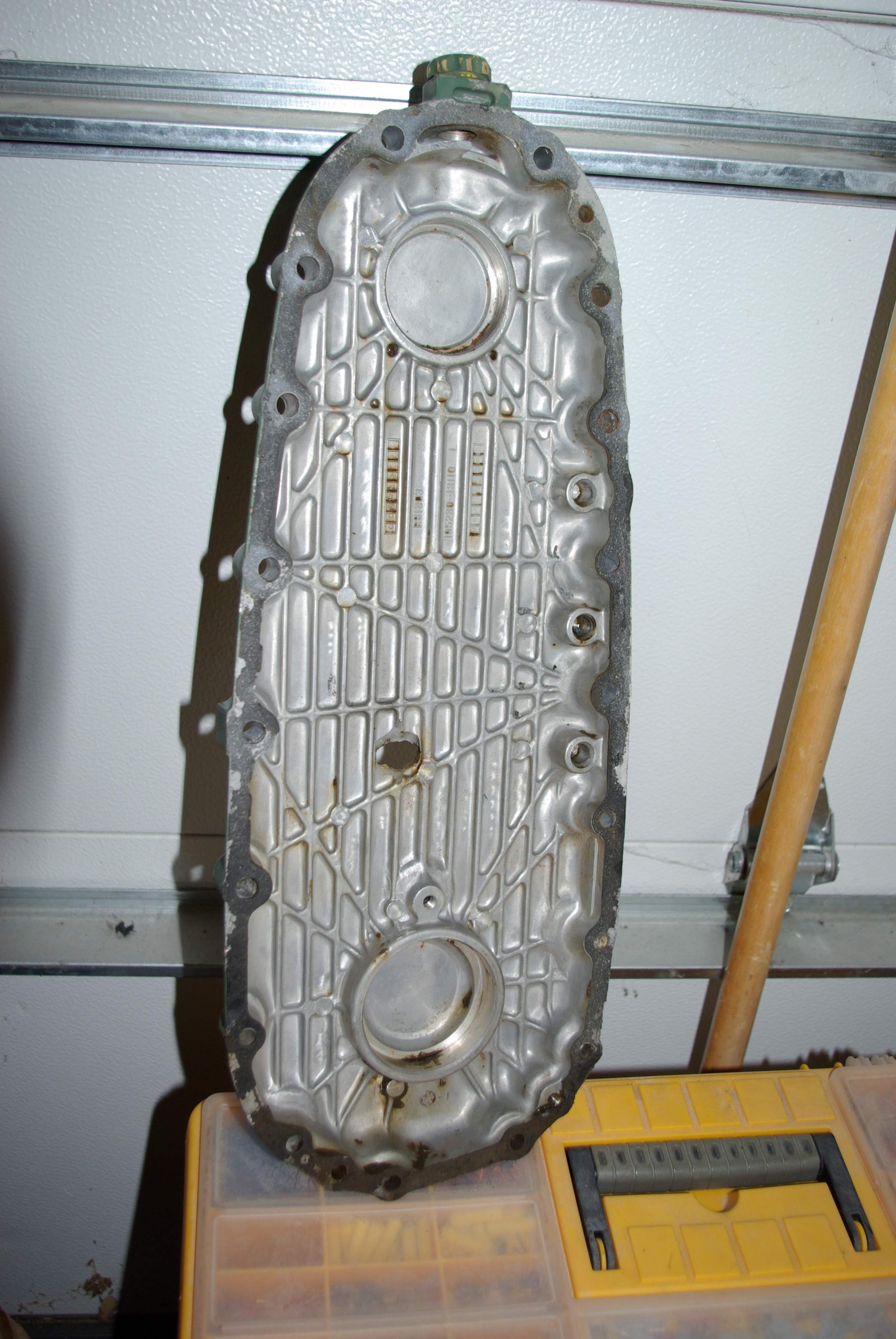

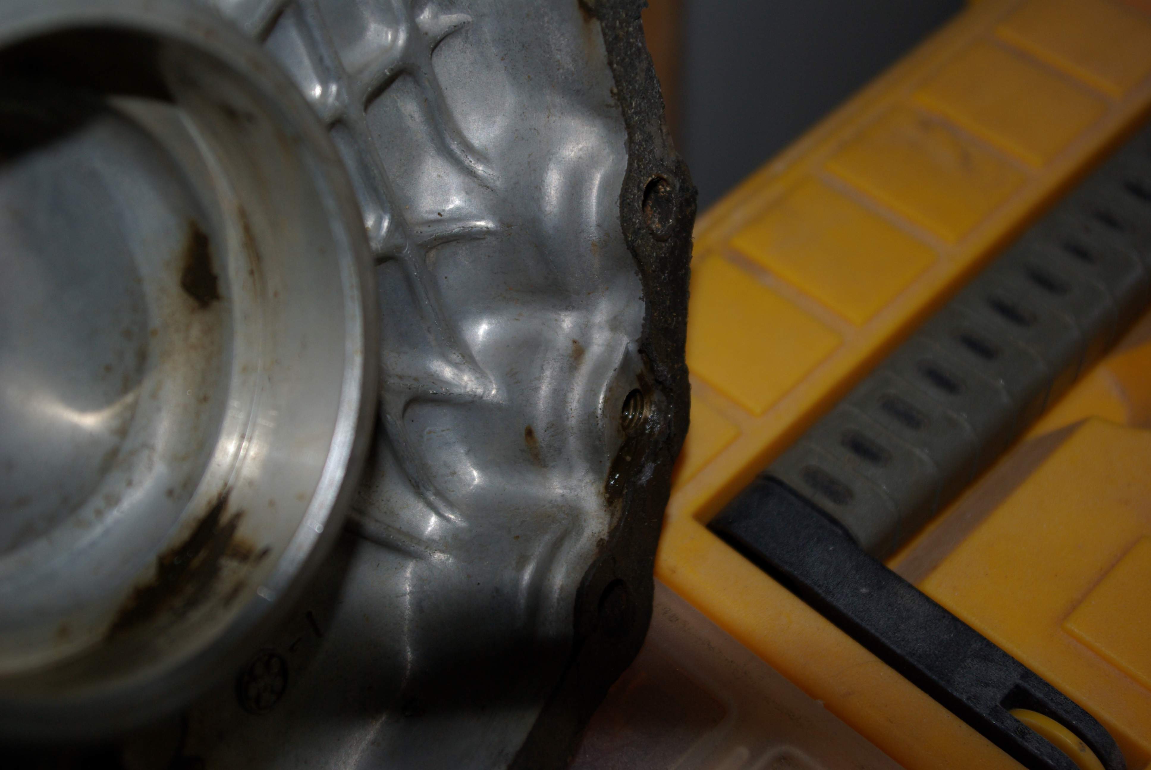

Actually, there is an oil drain plug. I have an RS1303, had it for several years, bought with new tines, used it a little, worked pretty well. PTO shaft would bind up when I turned while tilling (probably not smart), so I only till in a straight line, no damage.
So I started to use it again recently and I noticed a bullet hole in the chain box, I guess a ricochet since I tend to target practice in the same area.
So I had to pull off the chain box cover. That was not easy, given the age, I had to destroy a few bolts, but one of the bolts is an oil drain plug. At the bottom, there are three screws on the front, three on the back, the middle front bolt is an oil drain hole. Pictures of the cover attached, I put the oil drain screw in so you can see it.
The chain appeared to be in good condition, despite water in the case, and a pile of sludge in the bottom. I was surprised by the amount of sludge. The bearings sounded a bit noisy but that may be normal.
I will reseal with RTV. But the chain box is in three pieces (a center piece and a cover on each side) and to take off the center piece (to seal between it and the inside cover) I would have to take the chain off and sprocket, I think I'll just let it leak a little for now, that's way more work than I want to do.
Also, surprising to me the gear box is made of aluminum. To fix the hole I'll just screw a plate over it and seal it. I might weld but I've never welded AL. I did find a little shrapnel (magnetic material) in the sludge at the bottom, hopefully from the bullet and not a failing bearing. I think lead and AL are non-magnetic so this would be copper, but it was so sludgy I didn't clean it off to see what material it was.

I should have known that. Will have a better idea when I get it back together. Its possible something like rebar just bumped up against it and cracked the AL cover.
   / Yanmar RS1303 tiller, help! Something is binding internally #10

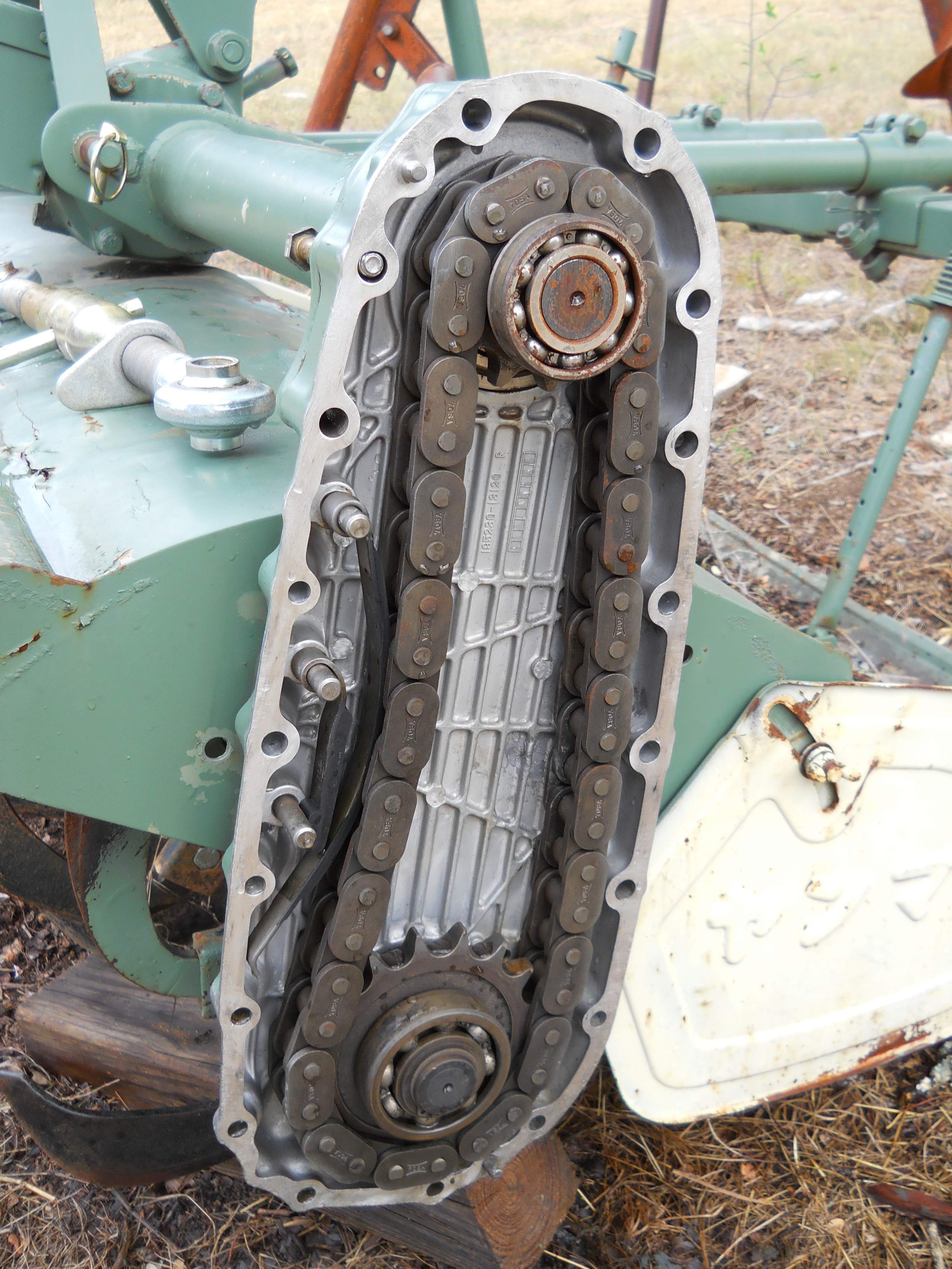

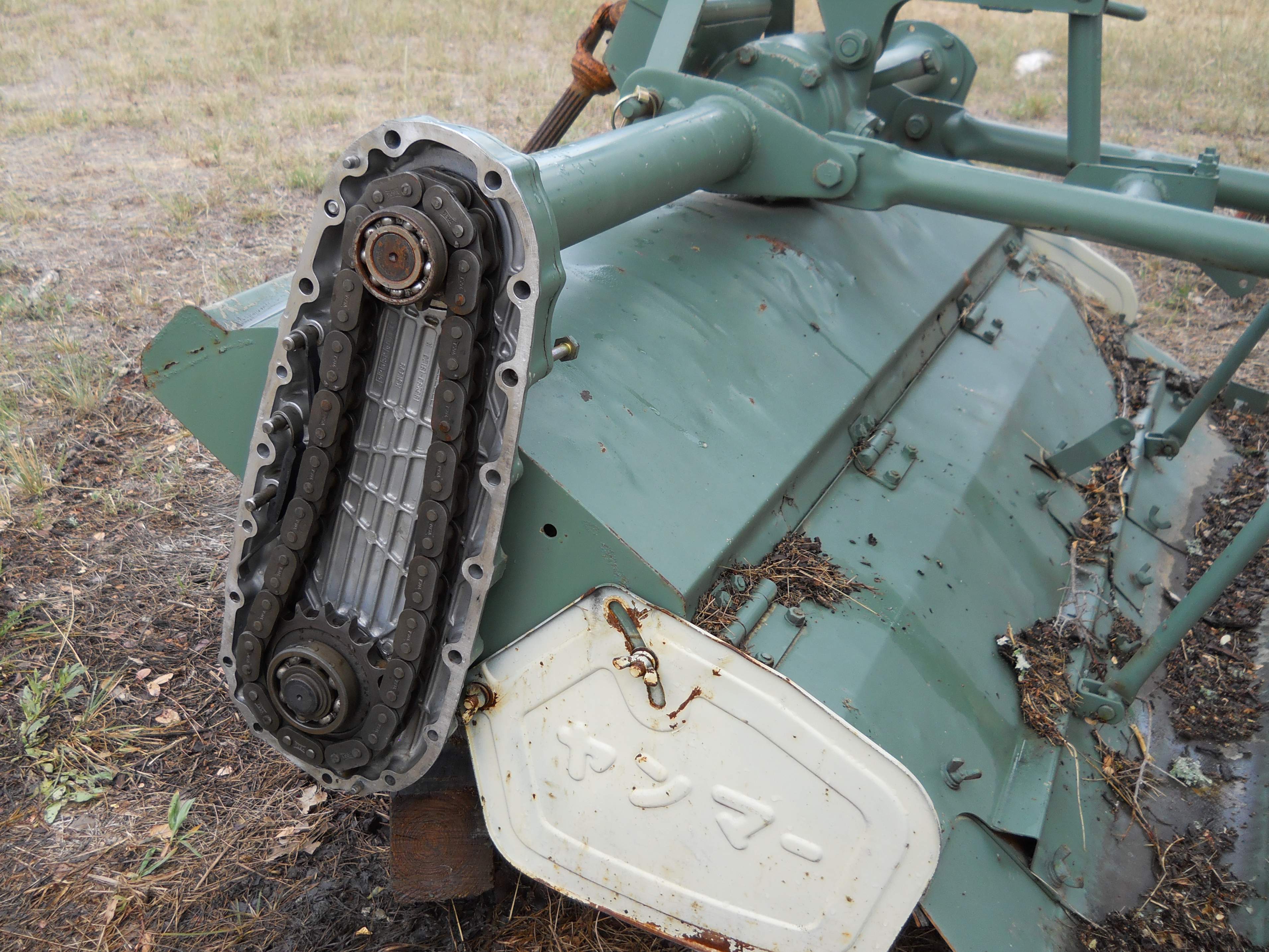

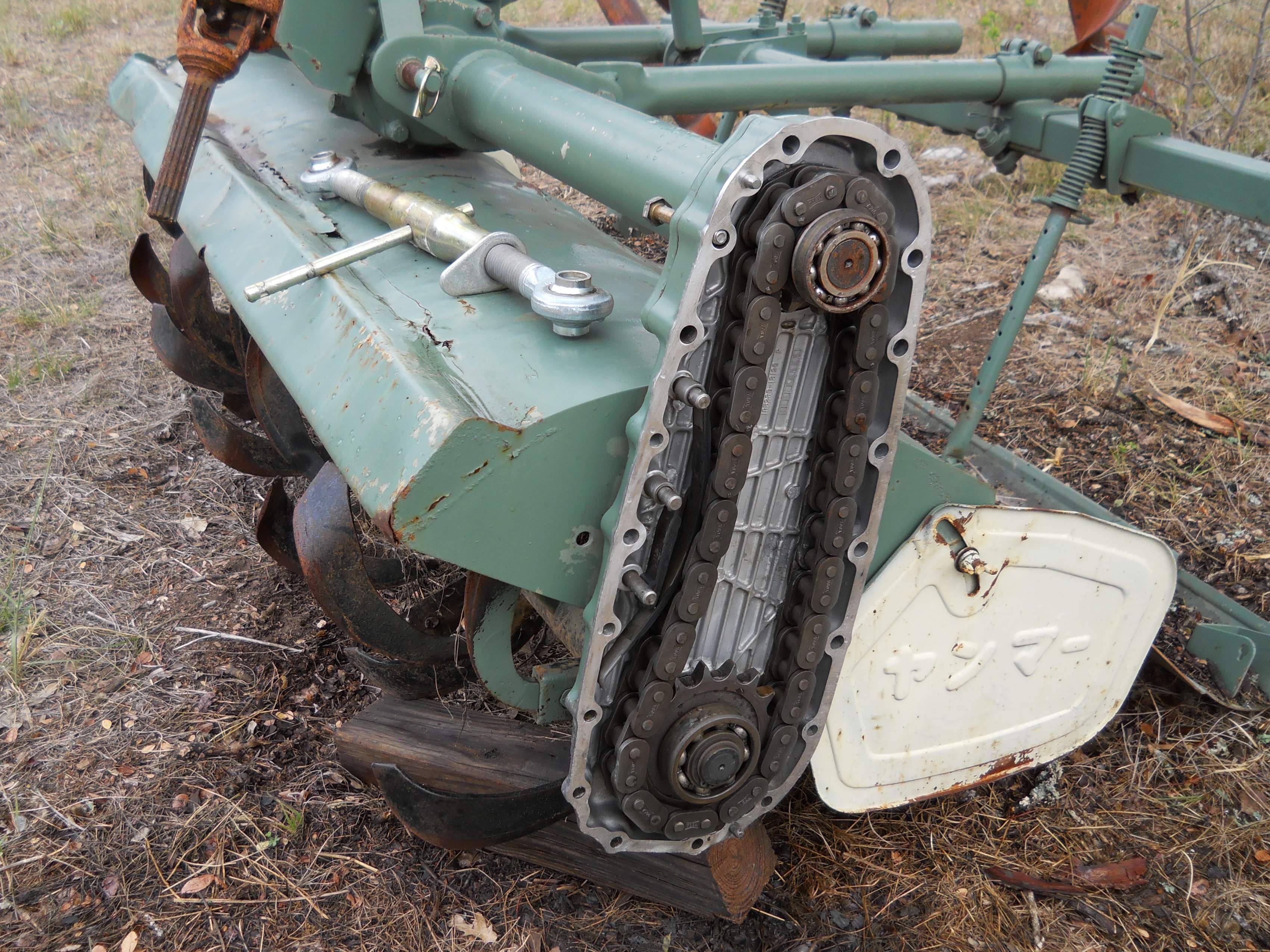

Pictures of the RS1303 with the cover off. Slightly rusty from being filled with water, but the rust is very superficial. No chance I'll every find a gasket so I'll use RTV for the first time ever.
