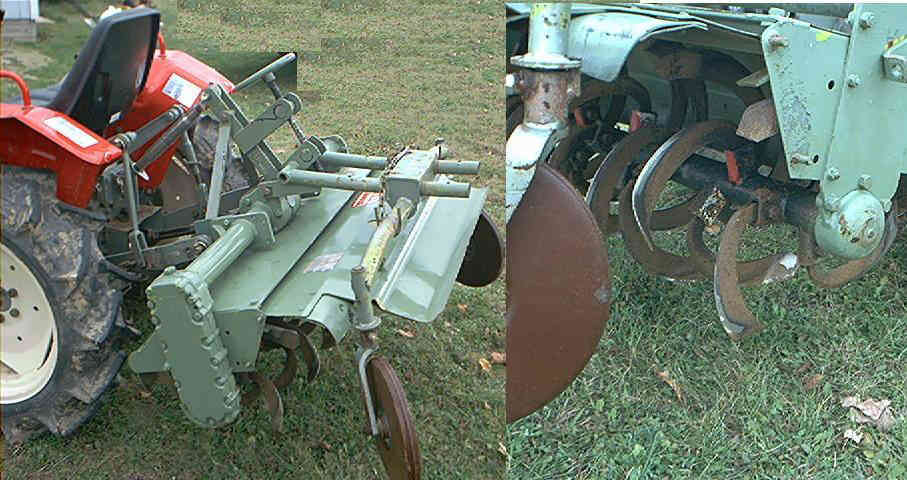

The RS 1200 tillers I have are 2-point. They mount on the rear of the tractor frame with special pins and have a very short drive shaft. It would be very difficult to convert to 3-pt.
Attached is a picture. Notice the pins on the mounting flange.

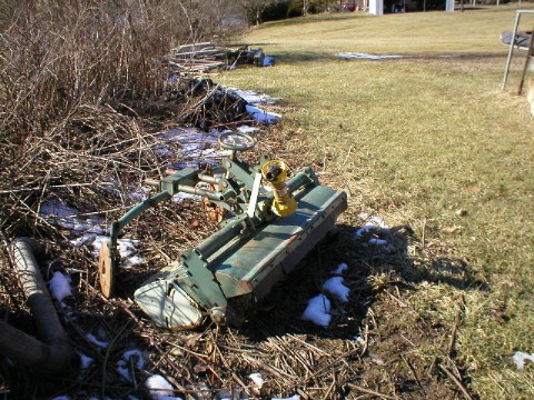

Curt,
I too have a RS1200 tiller and it's definately working on my TC18 with 3PT hook-up.
First pic.......notice the 2 lower pins and the top link connection point

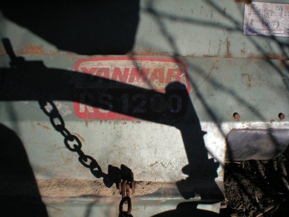

   / Yanmar RS 1200 Tiller #4
Beneath the shadow it does say RS1200 /forums/images/graemlins/confused.gif

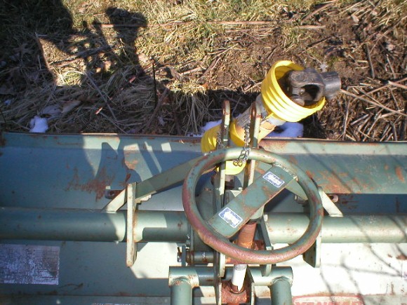

   / Yanmar RS 1200 Tiller #7
Most RS1200's are 2-point, some are three-point. As Jim has stated, the 2-points are hard to convert, the three-points work once you get the correct length toplink and driveshaft.

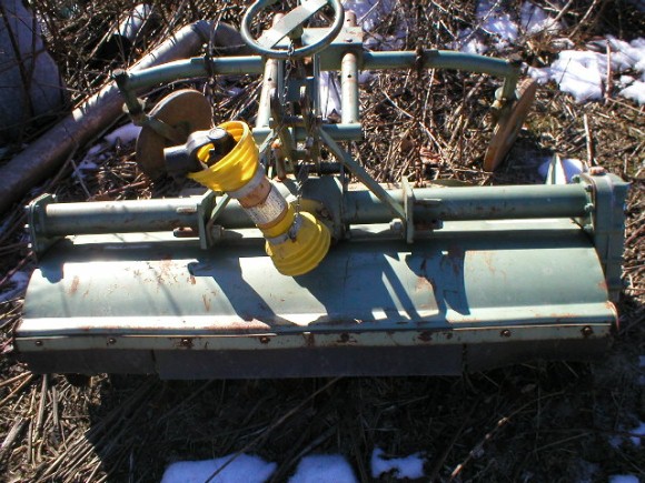

Thanks for the help. I have a friend who believes anything can be made to fit anything if you're crafty enough. I believe he's right, but I'm just too lazy to make this any harder than it needs to be.
Thanks for all the help and posts, I've attached a pic of the one I'm looking at.
Curt
   / Yanmar RS 1200 Tiller #9
If that's the tiller you are looking at, it appears it already is set up for a 3-point. Should work fine if you get the driveshaft length right.
   / Yanmar RS 1200 Tiller #10
The only hard part will be getting the PTO shaft correct
The rest is already done /forums/images/graemlins/grin.gif
