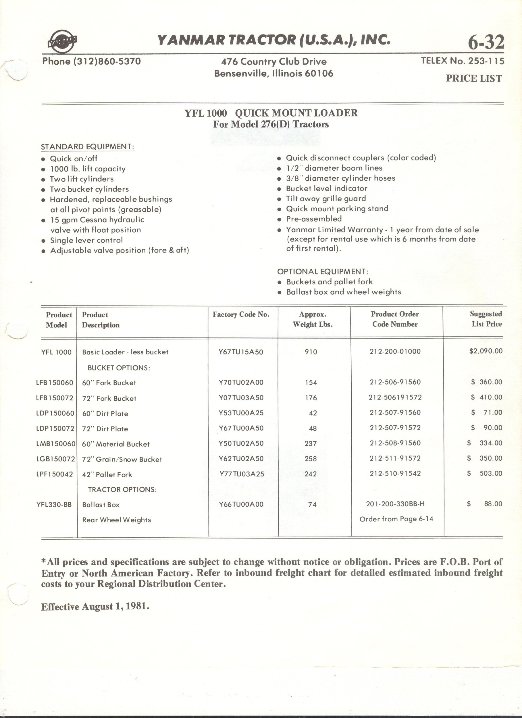

Here is an old price sheet for the optional loader.

Thanks for the info and cool old documents. Yeah I have the a later model with the YFL 1075. We love that tractor.
