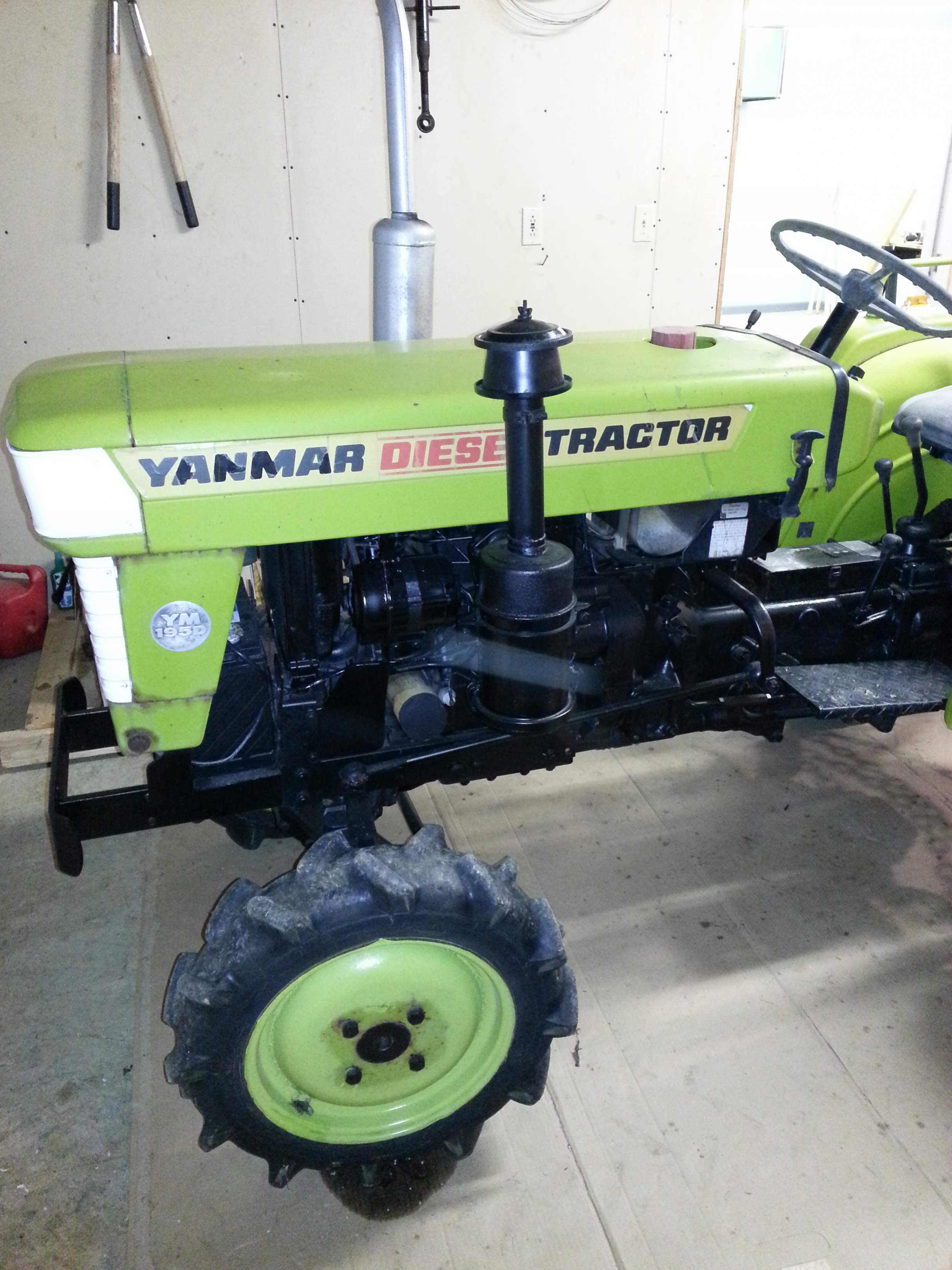

Just purchased a 1979 195D last month. I was told it was a 79, but I have no idea how to verify that and really it doesn't matter to me what year it is. It is in really good shape if it is in fact that old. I do however at some point want to repaint it. Does anyone know where or have a number code to match the "lime green" paint on it? I've already visited Hoyetractor, they are out of stock on the paint. I'm wanting the hood and fender paint, not the frame. I understand this is a "grey" market tractor, whatever that means? I'm happy with it, and the price I paid, I think it was well worth it. It seems to be a little work horse for no bigger than it is. Also any you guys know where I might luck onto any attachments for it? I was wondering about a front loader, it came with a 60" finish mower. Thanks in advance

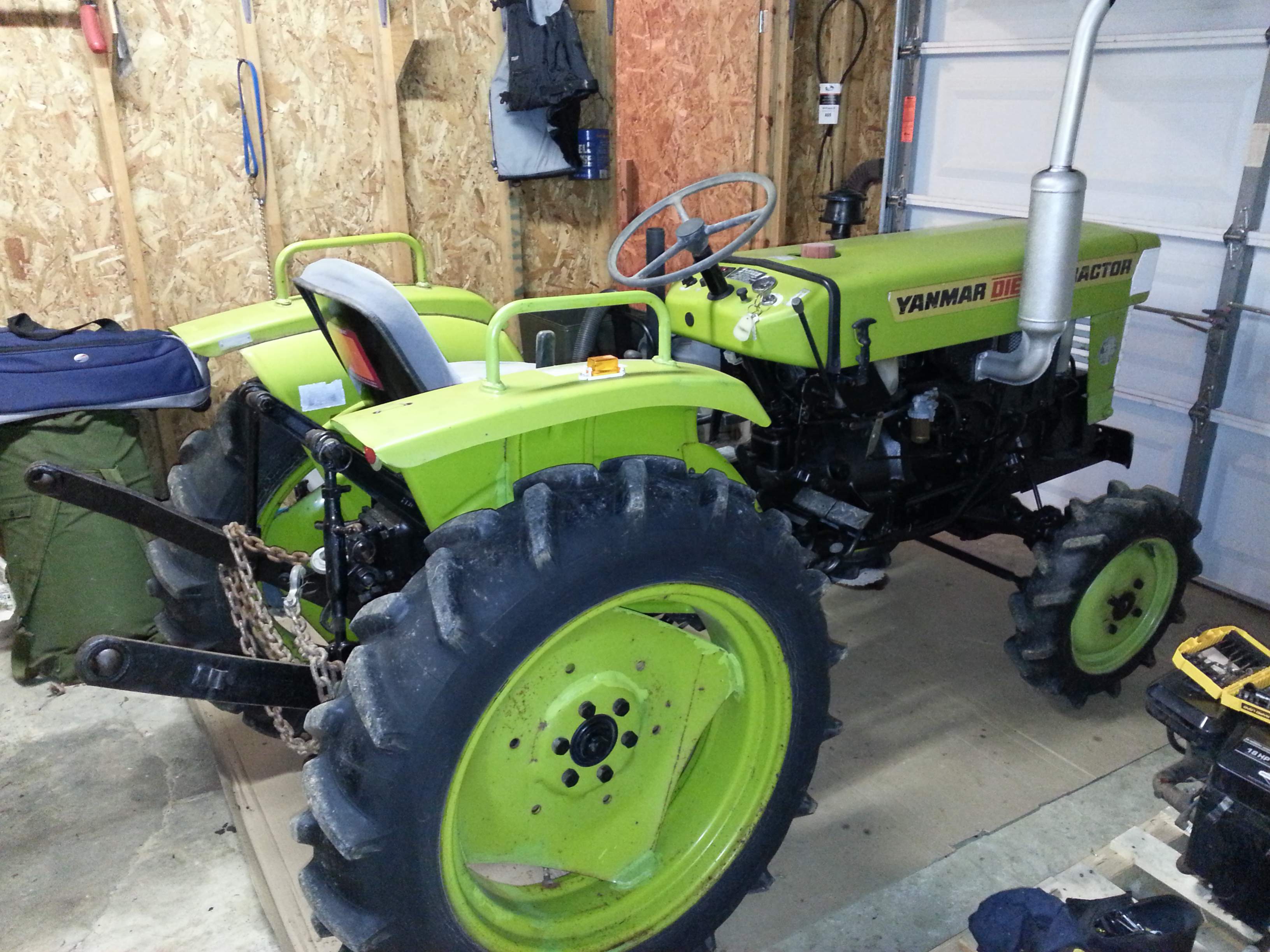

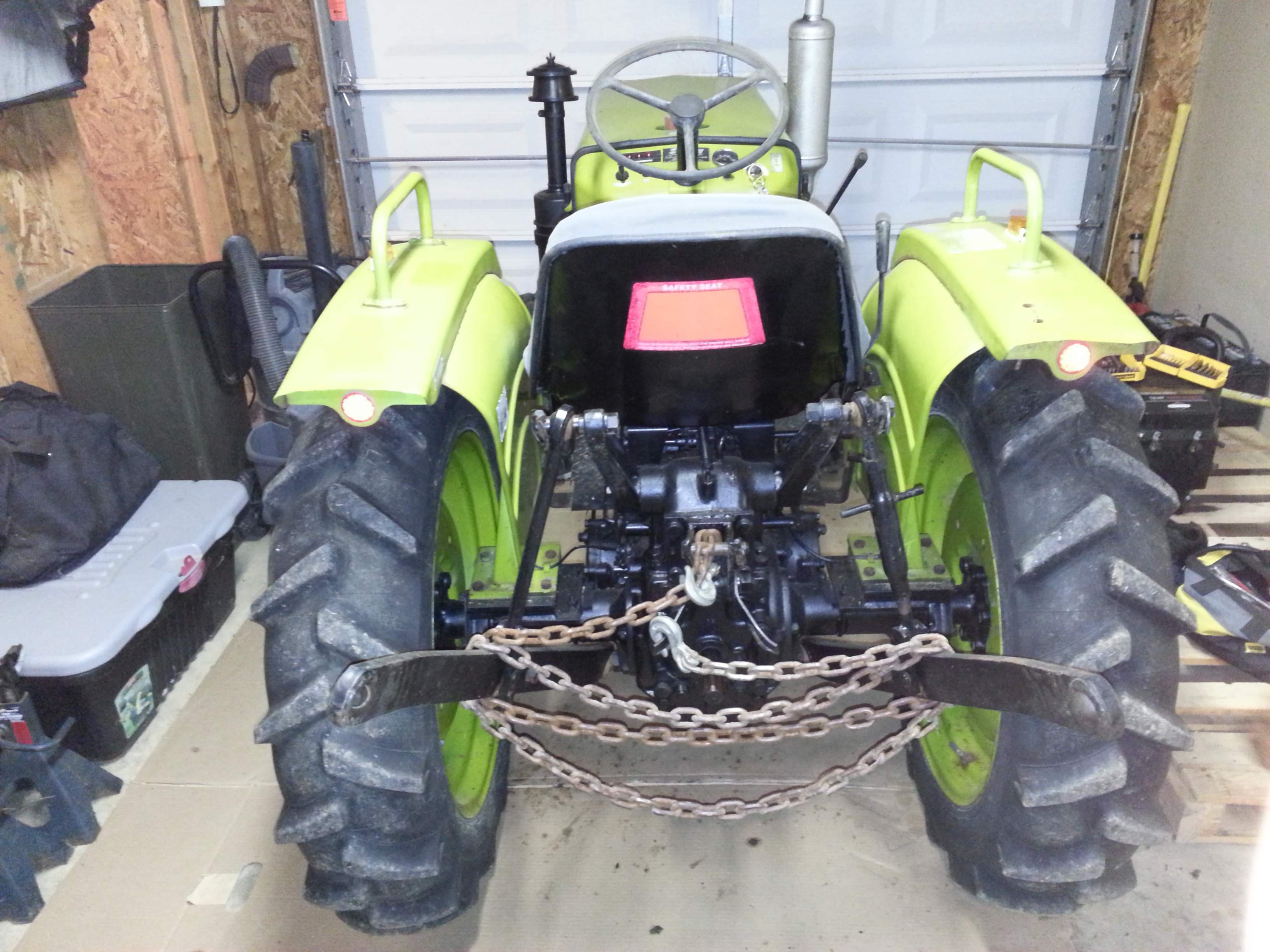

Here are the pics, I went ahead and took them tonight

And I think you have the final year version, 1981, because your external air cleaner was only used on the final update.
Paint it??? That's the cleanest one I've seen. Most US Yanmars look more like my sig, below. I tried to get a VN refurb shop to go over my YM240 and they told me it was too rough, they wouldn't do it. It runs like new so I guess that's all that matters.
