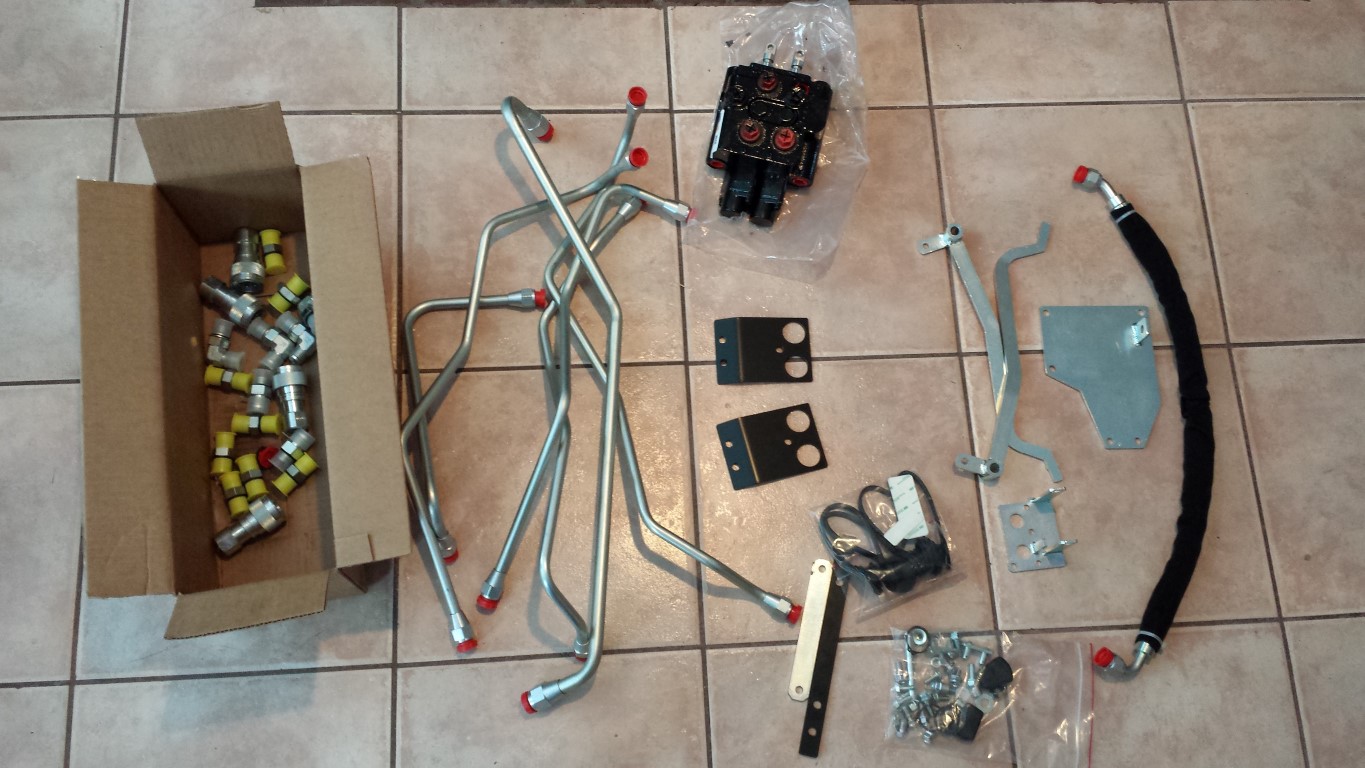

I finished the install of the rear remotes kit on my LX this weekend. I wanted to share the pics and experiences with others who may be interested in doing the same.
Here's the kit:
Here's the documentation that came with the kit:
Yanmar_LX_remote_kit.pdf 5.5MB
Note, I did not follow the instructions verbatim. The operator seat, fuel tank, and fenders were not removed as its says to do in the intructions. I basically started on page 12 and ended on page 23. Overall the documentation was good, but the quality of the pictures were terrible and I think some of the steps needs updating.

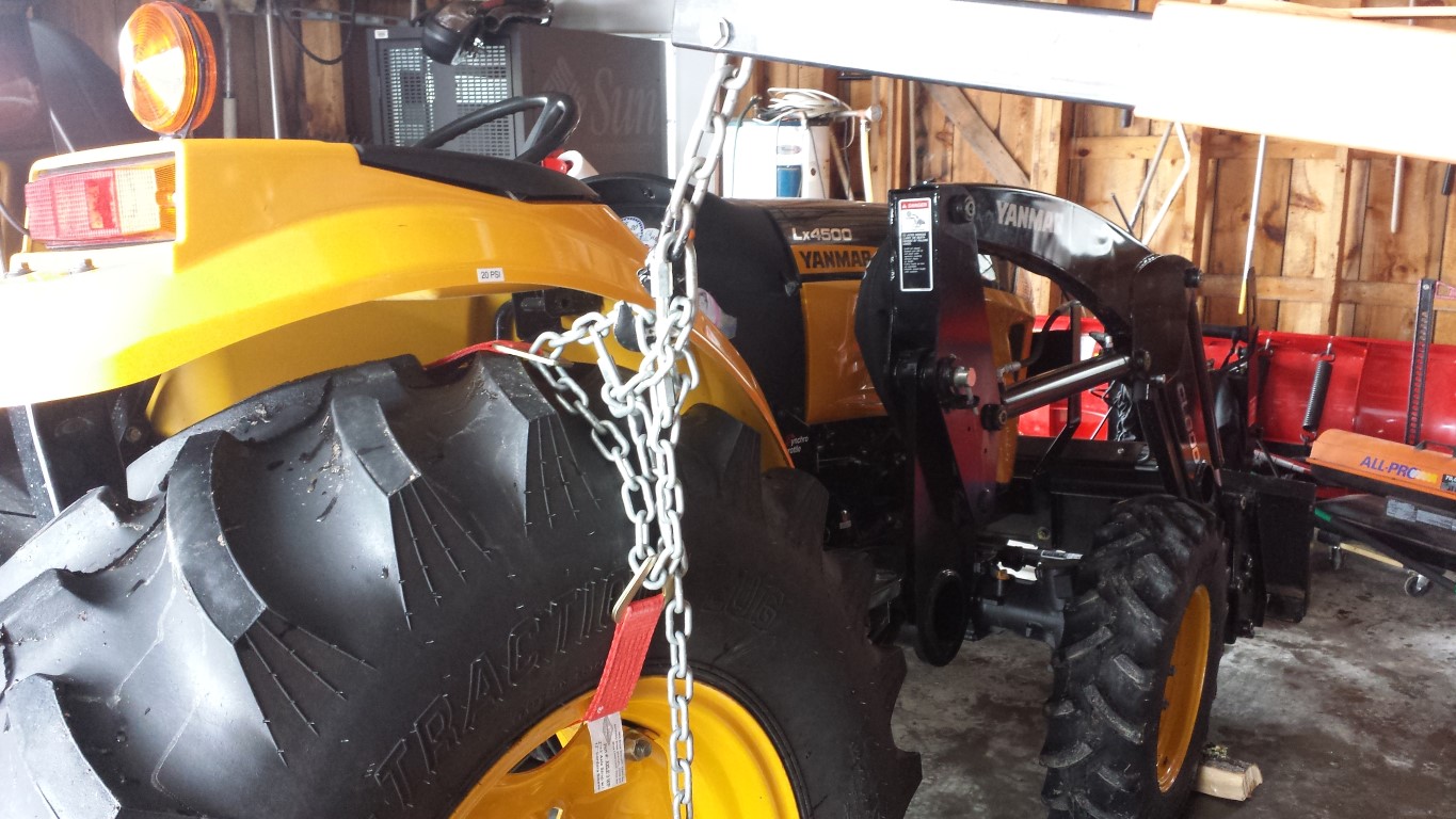

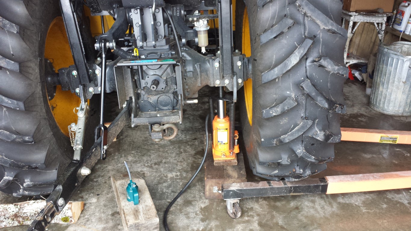

First, you need to remove the rear-right tire. A pneumatic jack and shop crane made this easy. The tire is loaded with a water/methanol mix. My wife supervised any handling of the tire in case anything should have befallen the writer of this post.

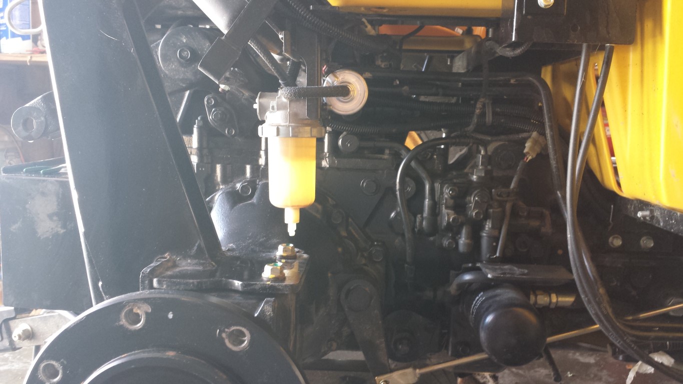

Here is the general area under the fender where the kit will be installed:

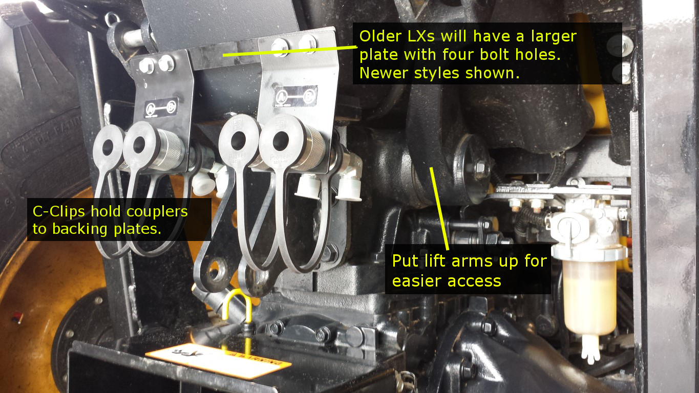

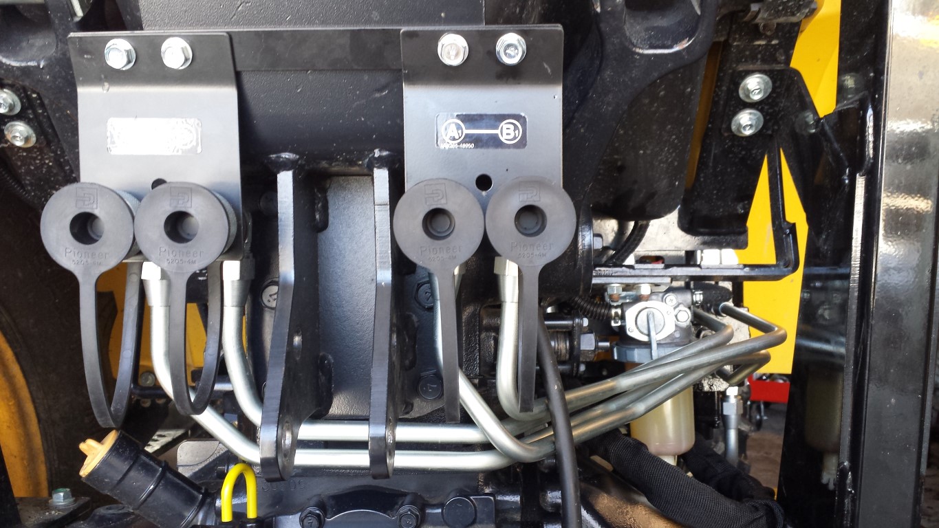

The first steps in assembling the couplers was easy. The couplers are fastened to the backing plates with c-clips. I put them in a viced-crescent wrench when I torqued on the right-angle fittings. I've made a couple notes on the picture.
   / Yanmar LX Rear Remote Kit Install

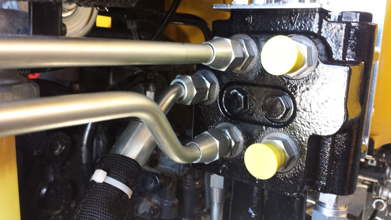

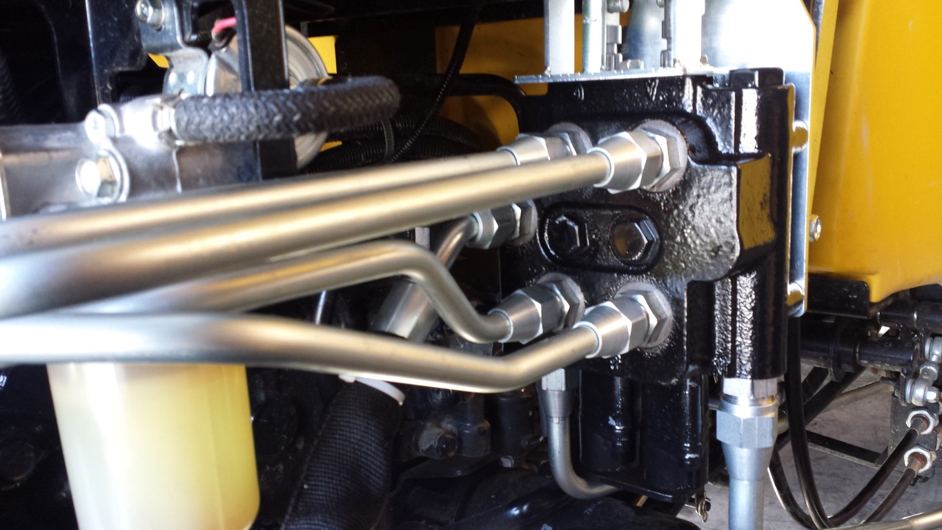

Next you torque the line-connector fittings onto the valves. The only part where I was confused was the lower fittings. The instructions reference a #18 connector and some other fitting. In the end, I used two #18 fittings. The two bottom fittings connect to larger lines than the 5 other fittings.

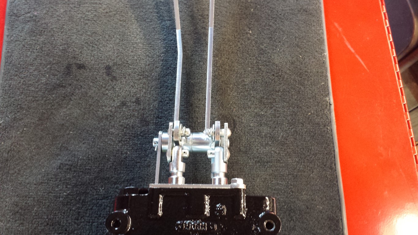

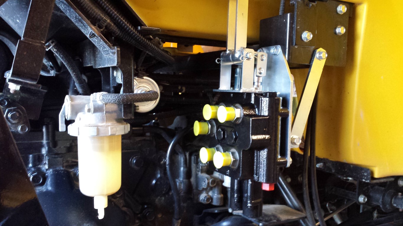

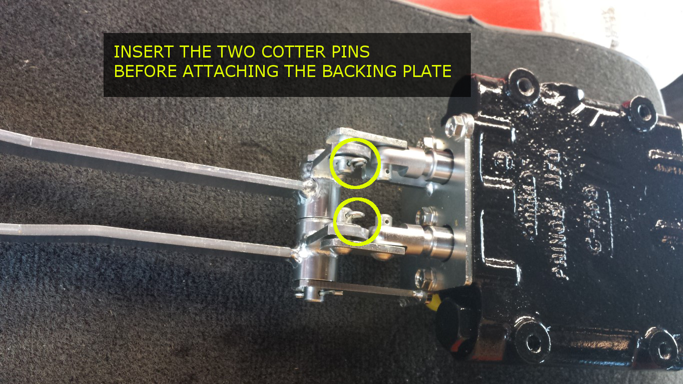

The handles and valve links weren't too difficult to assemble, but here are some better pictures.
I used a bench vise to press the four bushings into the bottom of the two levers.
Tip: attach the "valve stay assembly plate" after the levers are fully assembled else you're going to have a heck of a time inserting the cotter pins.
Last picture is mounting the valves under the fender. No issues here, lots of room.

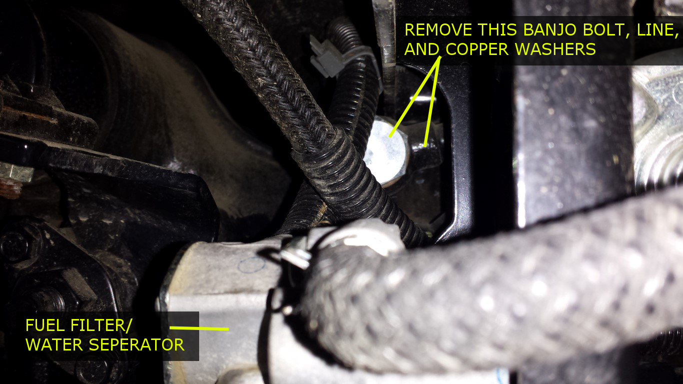

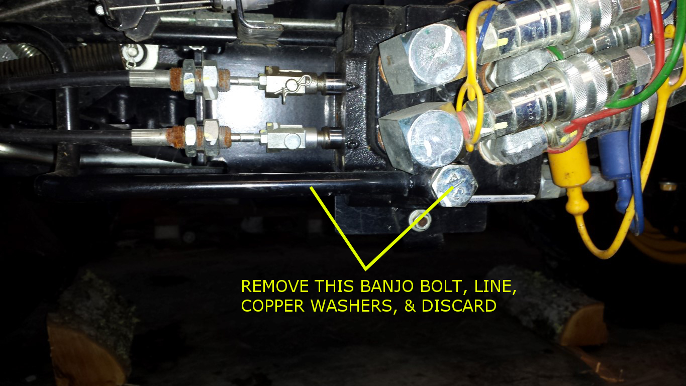

There is one line on the tractor to remove and discard. This line goes from the loader valve to the rear lift-arm housing under the fuel tank. You will be removing two banjo bolts, copper washers, and the line. Use a breaker bar with a long socket extension to get to the banjo bolt under the fuel tank. You will need to thread and torque line connectors into both of those open holes.

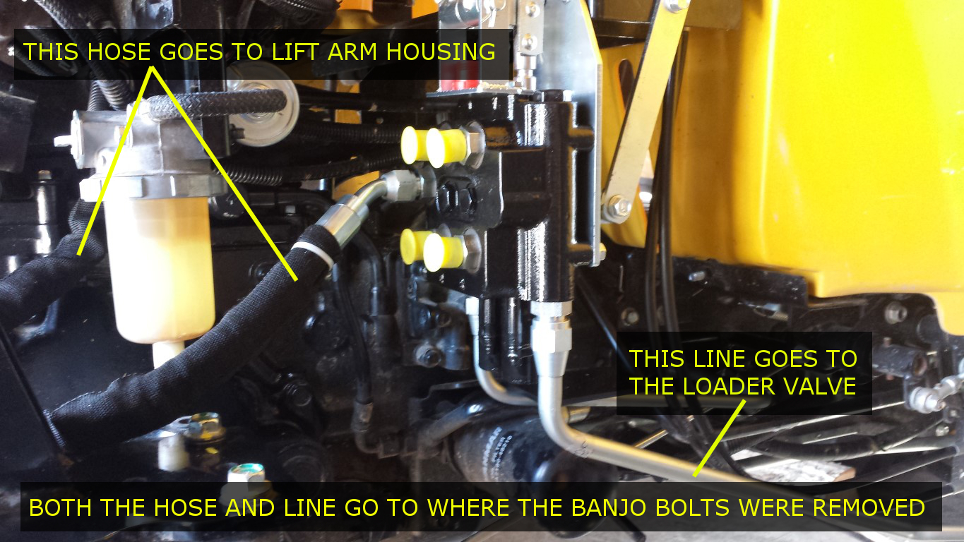

Install one line that goes from the rear remote valve to the front loader valve.
Install one hose (there is only one in the kit) goes from the rear remote valve to the lift arm housing.
It helps to unbolt the fuel filter and pump to wrench into that tight spot under the fuel tank. I was able to torque on the line connector pretty easy with the long extension and a 30mm socket. Tightening the line after was a bit more challenging. Here's where I cut up a 7/8" 12 point wrench to use as a line wrench. Make sure the hose necks are rotated away from the three-point lift lever and other fittings on the remote valve. I was able to do my final torquing with a proper 7/8" line wrench.

Attaching the four lines to the couplers was last and pretty easy. Tip: Identify each line according to the documentation and label them before starting. Also, loosen/tighten the bolts fastening the couplers to the tractor as necessary to attach the lines and torque them down. The documentation will tell you what order to go in when attaching the lines.
