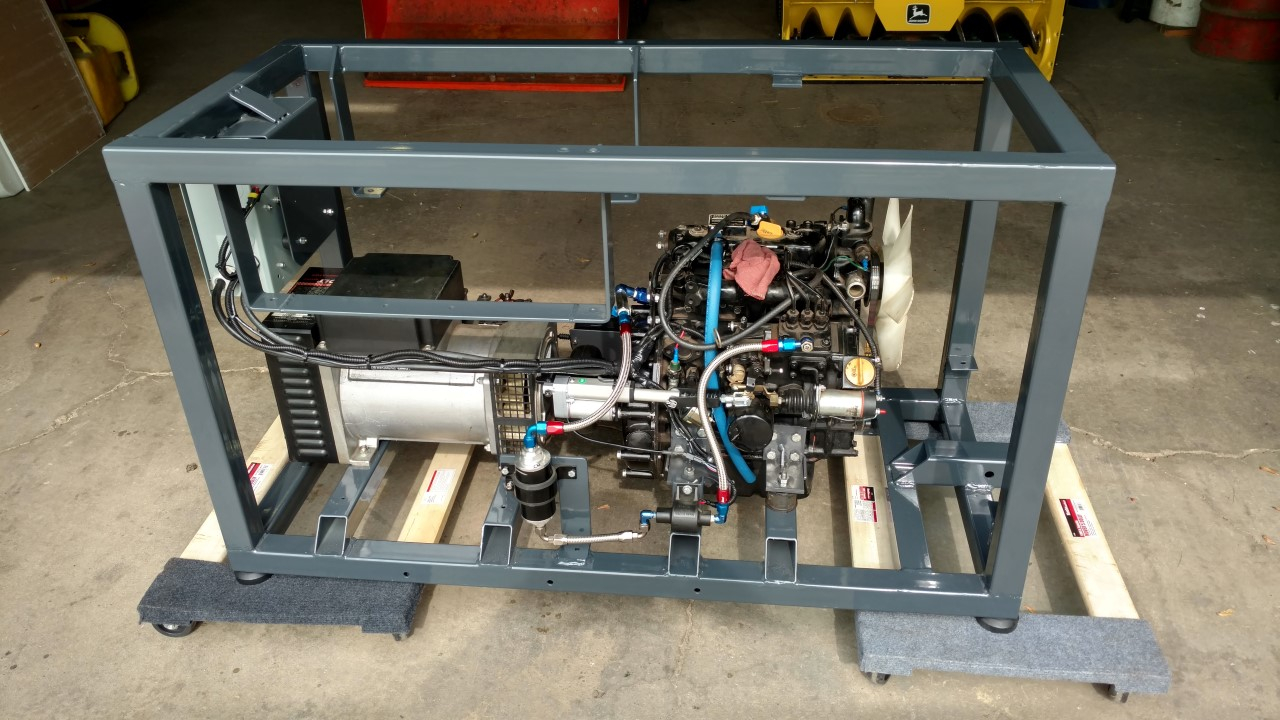

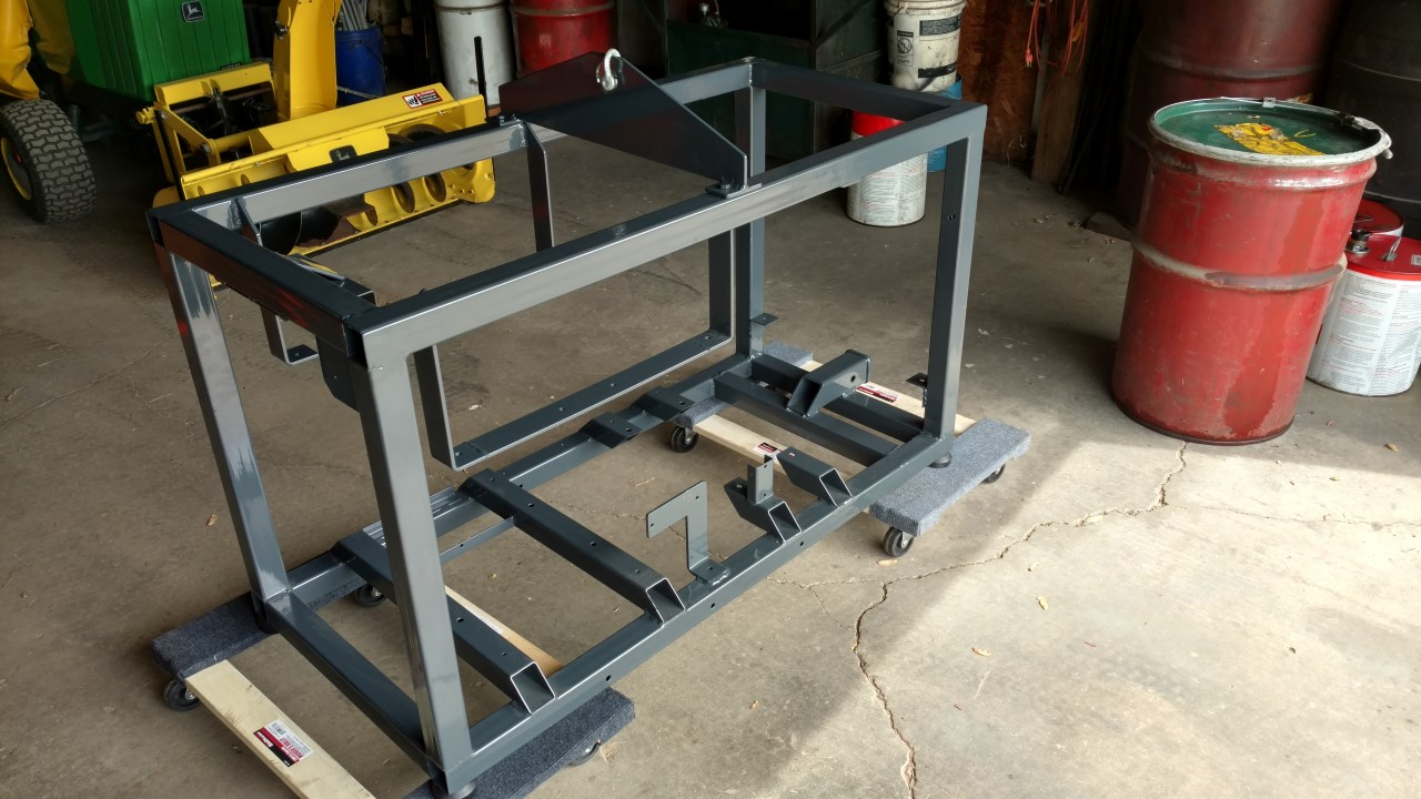

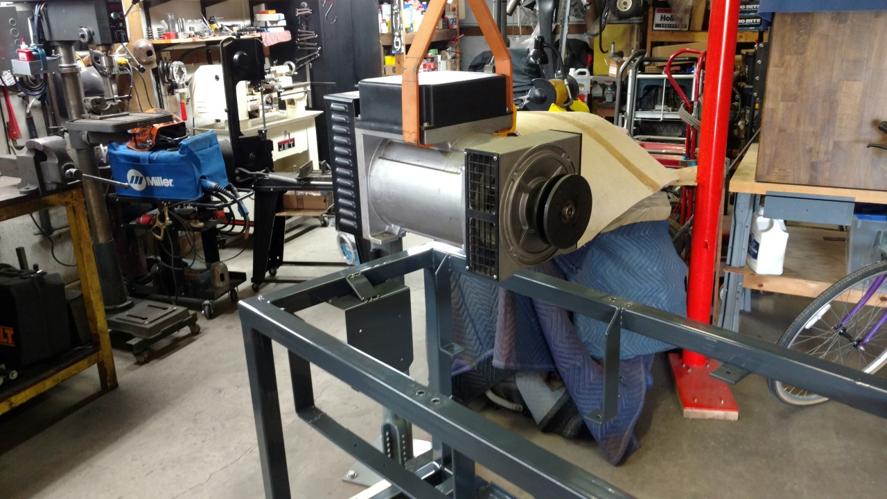

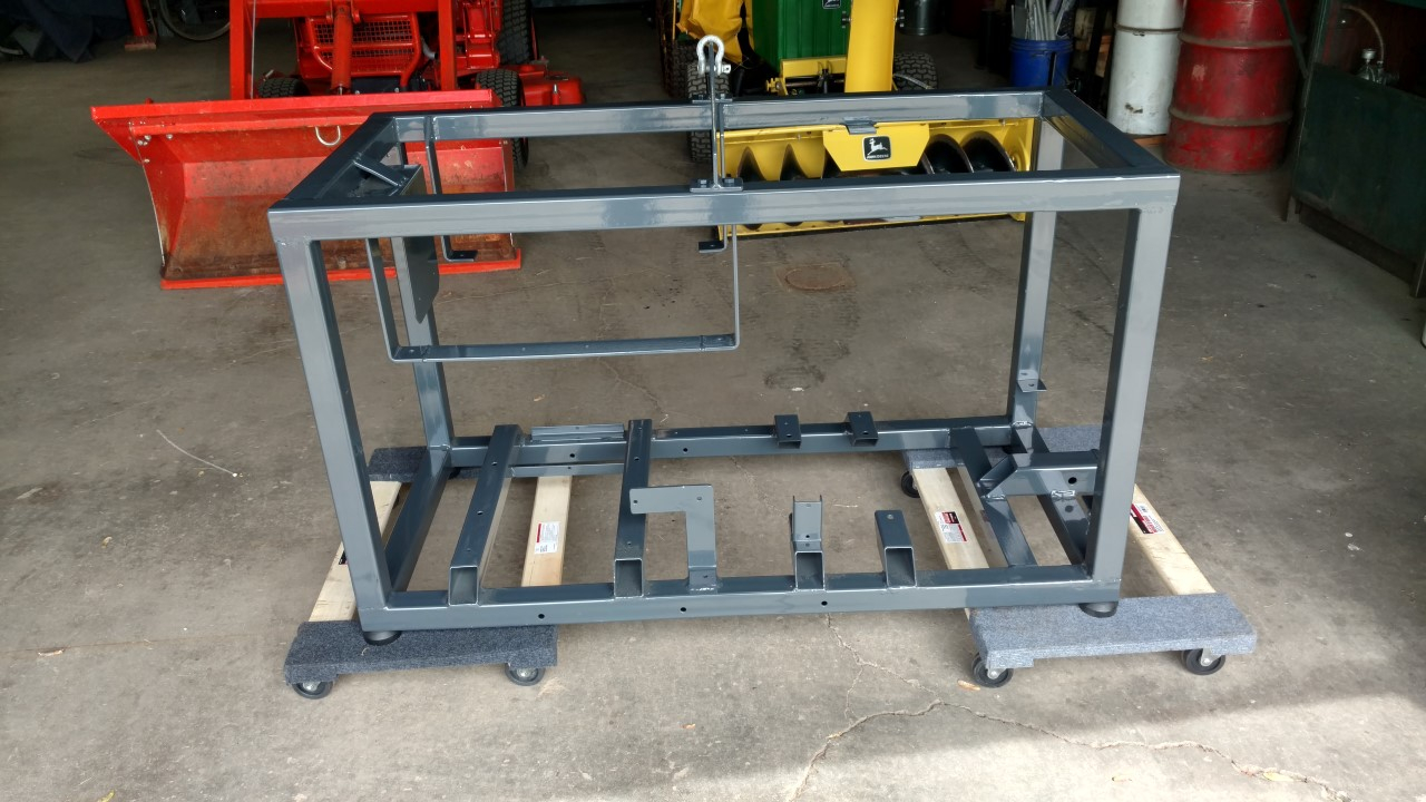

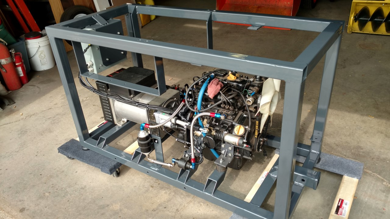

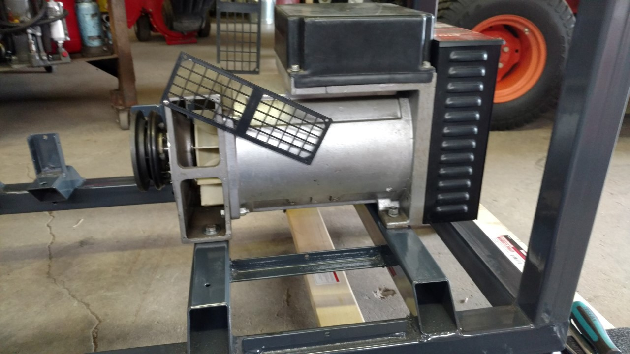

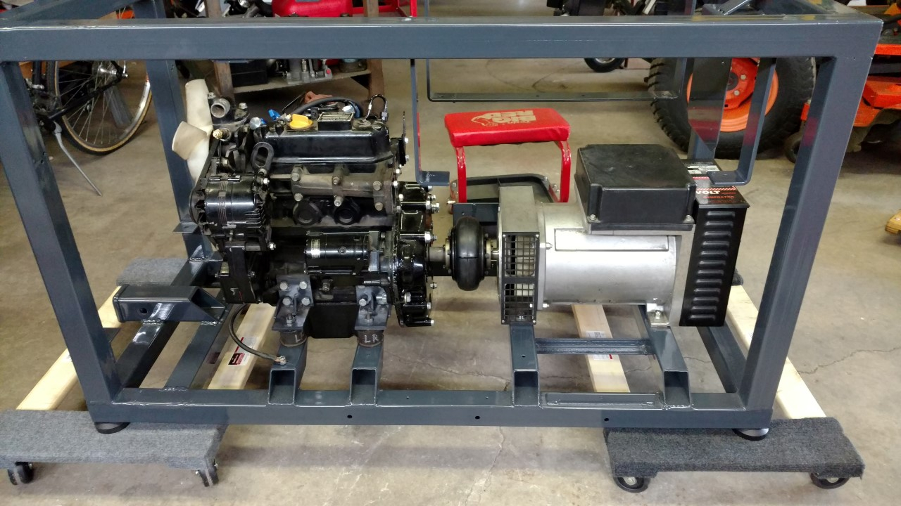

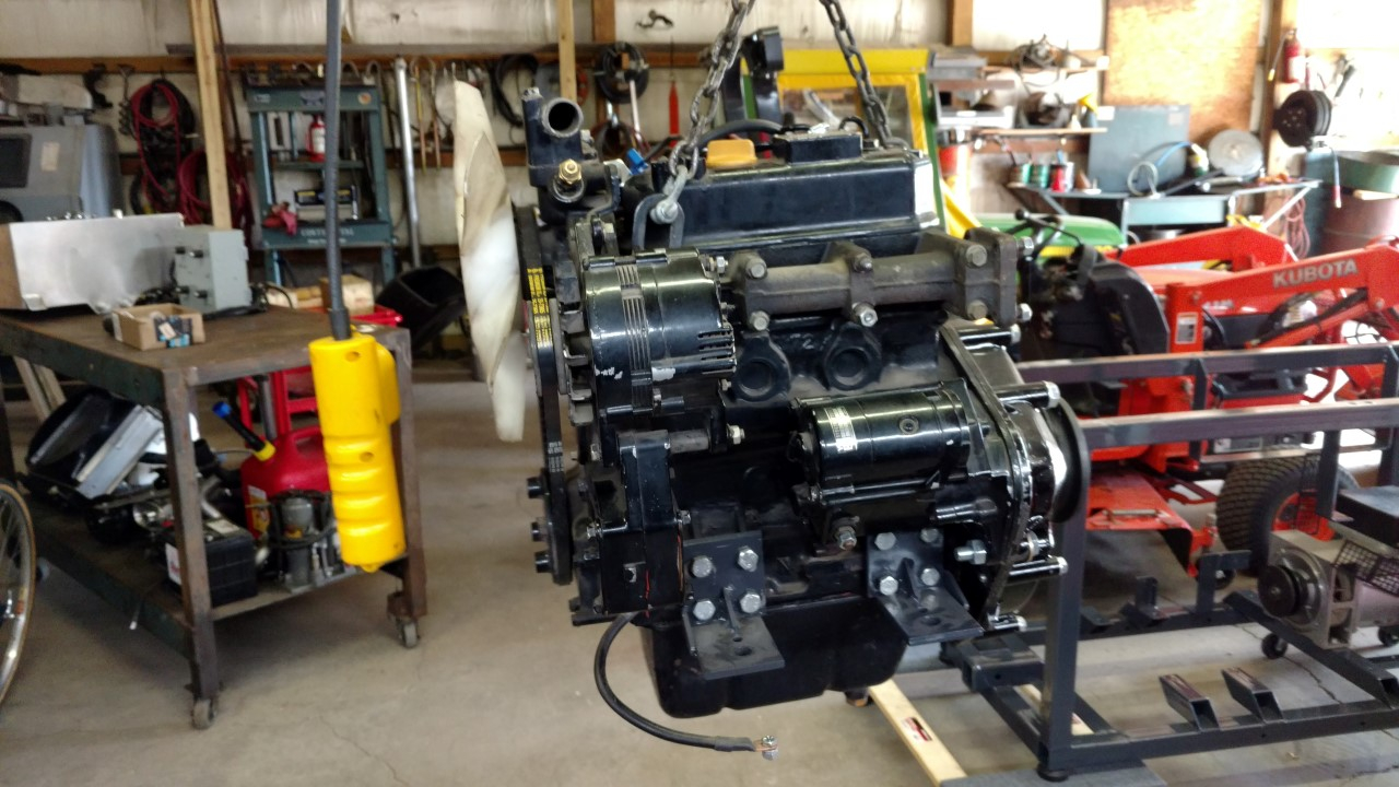

After I finished up building the Yanmat 3TNA72 powered generator I have been working on for 20 years, I took it all back apart and took the frame work to the local fab shop and got it powder coated Kubota ROPS gray. I picked it up yesterday and it looks great.
Today I started putting it back together, and got the generator and the engine aligned coaxially and bolted down. So sometime soon the project will finally be finished up.

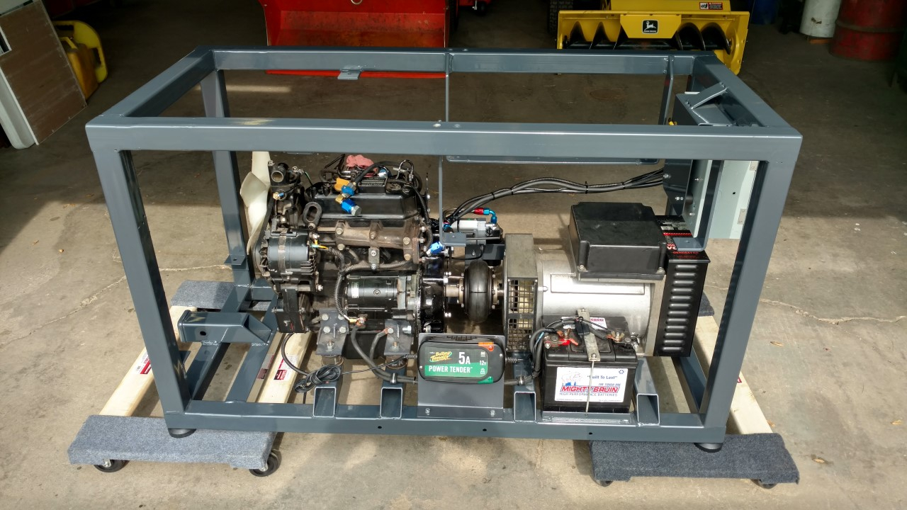

Worked on it this afternoon for three hours installing the electrical system, throttle servo, and fuel system, plus a few other little tweaks.
After powder coating, you have to ream out all the bolt holes if they are a close fit, and remove it at holes where an electrical connection is grounded to the metal.
Still have to put the fuel tank on, install the radiator and hoses, exhaust system, air intake system and the axle and subframe.
And yes, I'll remember to take the rag out of the air intake.
