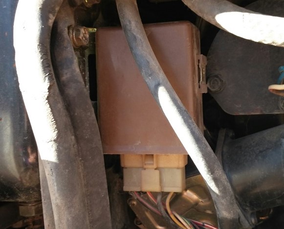

As posted in my first thread here:
http://www.tractorbynet.com/forums/yanmar/392470-yanmar-f215d-help.html
I am working on a model F215D belonging to some friends of mine. It is apparent that the owners are not that familiar with their own tractor even after 5 years of ownership. As is likely typical for a grey model they received it with no documentation.
Aaron at Hoye Tractor has been kind enough to provide a wiring diagram in response to my solicitation in the above mentioned thread. Upon studying the diagram provided it is apparent that some form of pre heat is present along with what may be an associated timer or relay. Since only a single heating element is depicted rather that three as I would expect for glow plugs I am wondering if this model uses the Yanmar thermostart system. While I wasn't looking for it, I nonetheless do not recall seeing the little fuel container that is associated with thermostart. Is it possible that Yanmar uses some type of heater in the intake airstream without burning fuel as is the case with their thermostart system? My questions are as follows:
1) What form of pre heat does this model use and does it have an associated timer?
2) If it has a timer is there an associated light on the dash that should illuminate during the heating cycle?
3) I am still hoping someone can identify the function on this electrical device located near the voltage regulator

Look for a wire that reaches the manifold, investigate. It my go back to your mystery (timer) box.

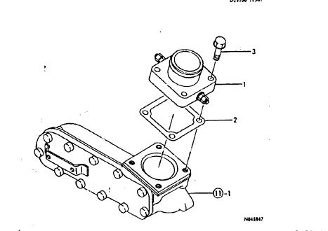

It looks like it uses an intake heater plate like a lot of the other newer diesel engines.
