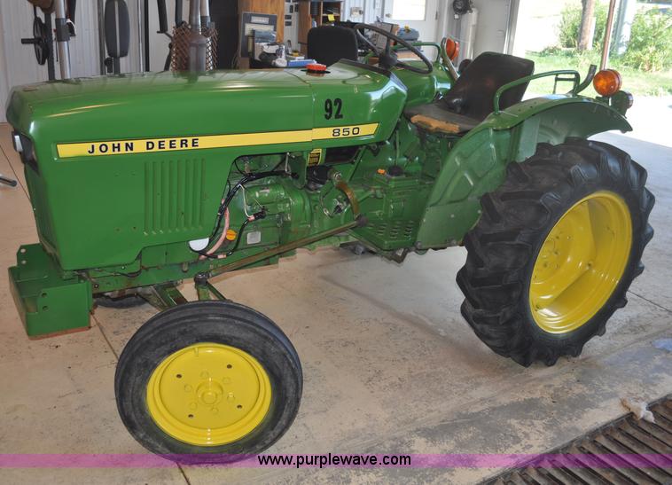

ym2500_JPG.jpgA5964.JPGWelcome to the Yanmar forum Texas John. :welcome: I live in the Gilmer area. Your 2500 is very similar to the John Deere 850.

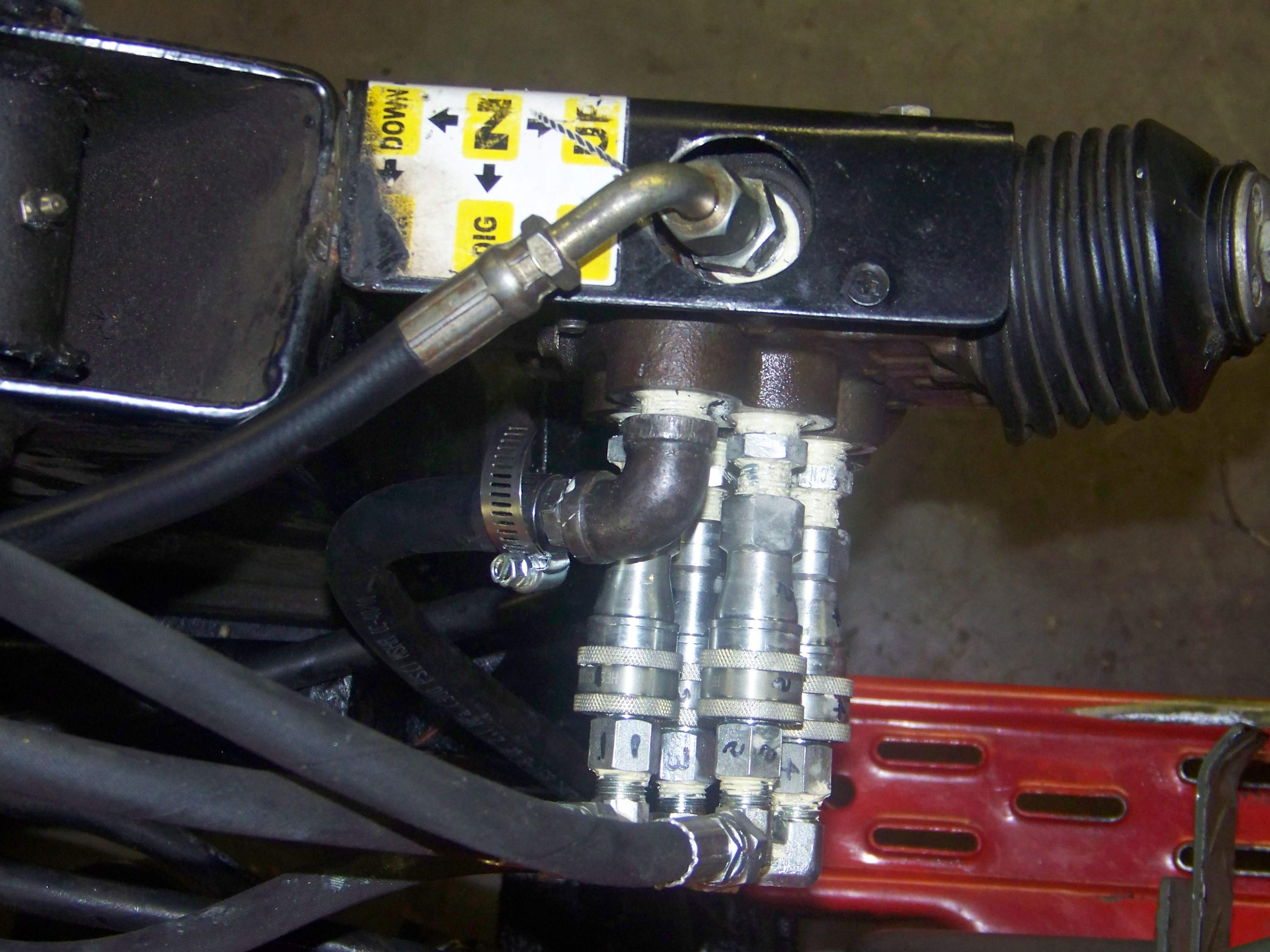

I do have a question about the bucket. The hyd system has no quick disconnects. If I ever want to change front attachments how would I do that ?
