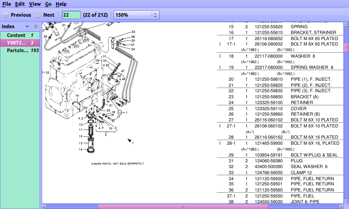

I have a Yanmar 2620 grey market
the one of the 2 bleeders sucks air
chances are it's the one right on the fuel pump
the bleeder itself looks like it is pressed together
suggestions?

these bleeders are spring loaded push button
it did come apart, I added a washer under the spring on the bleeder on the pump, which has seemed to work

Where did you get that parts diagram?
I'm glad you got it figured out.

to follow up on the fuel problems
I replaced the orings on the bleeders
most of the return fuel lines had been replaced, but the original spring clamps, replacing with screw clamps was the final piece of the puzzle
no more sucking air/fuel starvation
