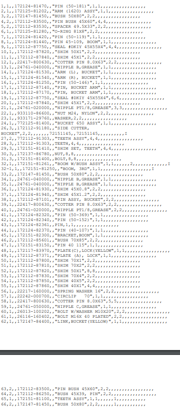

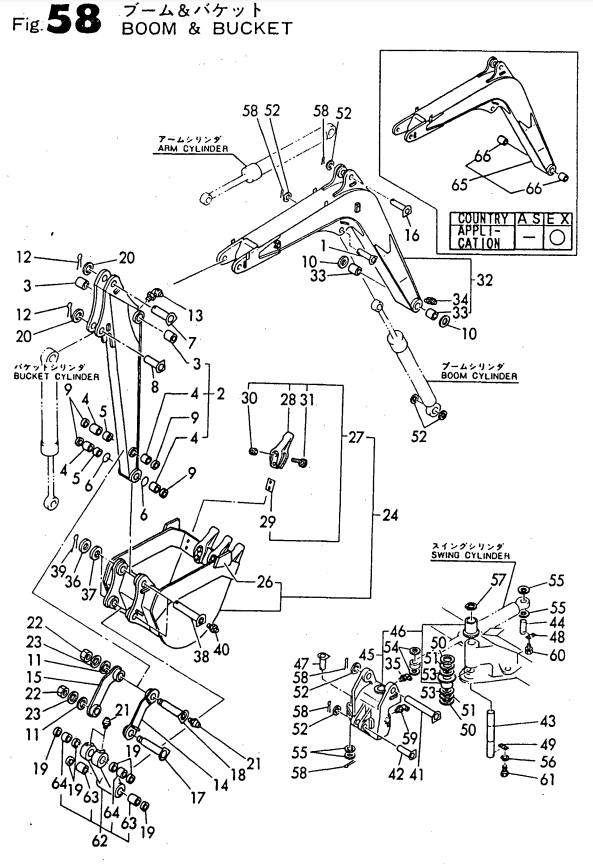

This would actually make a lot of sense! Didn't even realise they had bushings. Are you able to tell me what part from this diagram is the correct bushing?
My amateur guess would be No. 63 & 64?
Thank you!!!
   / Yanmar B50 Bucket Pin Size #4
Yes 63 and 64 for your bucket link . You'll also want four of the #4 to replace in the bottom of stick

I am having a hard time finding parts. Where can i get the kit that surrounds the main bucket pin? Parts, 9, 4, 5, 6, 6, 4, 9? Thanks.
   / Yanmar B50 Bucket Pin Size #6
Find the nearest Yanmar excavator dealer near you and have them order them
   / Yanmar B50 Bucket Pin Size #7
Go to a steel supplier and buy a stick of the required diameter and make your own and as far as bushings go, buy a length of 660CA bronze bar stock with the center hollow and either turn a set or have a local machine shop turn a set and have spares for the future. Both items are easy to make, or have made if you don't own the machine tools.
