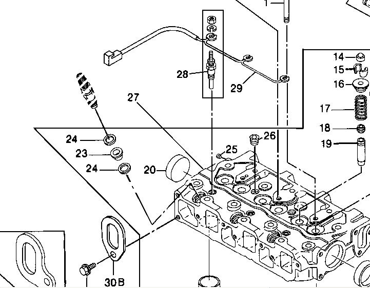

My JD 4100 has a Yanmar 3TNE74 with 750 hours. It used to start instantly but now takes several trys. I have the throttle at half, battery cranks strong, lots of black smoke out the exhaust. I cranks several times and it eventually starts. I have replaced the fuel filter and the fuel appears clean. I'm ready to drain the fuel tank and put in fresh fuel. I have a 55 gallon tank that lasts the season but maybe the fuel went bad.
Does this engine have glow plugs? The manual doesn't list any.

Yes, it has glow plugs, just no glow plug indicator light. The glow plugs activate simultaneously with the starter being engaged. You can activate the glow plugs before engaging the starter by pulling out the yellow PTO button, then turning the key to the starter position for about ten seconds, then pushing the PTO button in and cranking the starter. That should take care of much of the smoking at start-up.

Ron - thanks for the info. I called the dealer the next day as well. I drained the fuel tank and put in fresh fuel. As you suggested, I pulled out the PTO and turned the key for about 10 seconds. Still didn't start as easily as it once did. Do you or anyone else have drawings as to remove and test the glow plugs? That's the next area I will investigate.

jdparts lists the glow plugs as part # AT110814
Shown here as item #28
