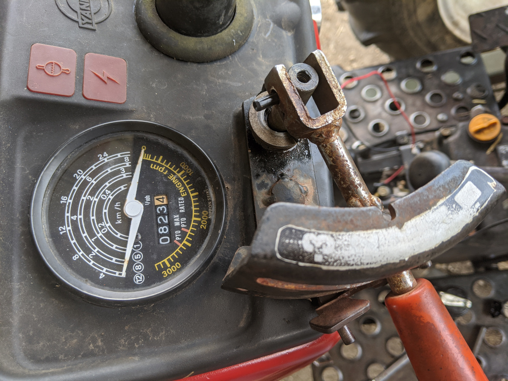

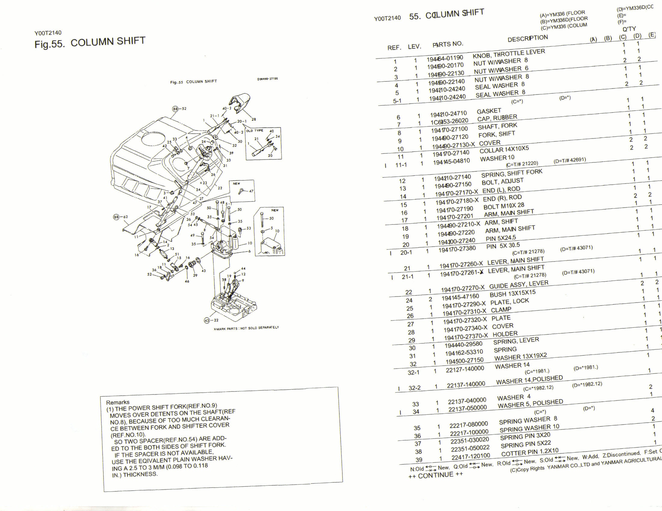

The 336d powershift column shifter was removed and not exactly sure exactly how it all goes back together.
Mostly does anyone have pictures of one assembled correctly. The spring is also a question I have. I do not know where the spring attaches.
Here is what I have:

Don't know this will help but all I got.
I went out and took a photo for you. The inner end of the spring goes to a cotter pin.
Also on mine there is a loose-fitting pin that allows the shift handle to swivel, at the top of the vertical shaft that goes down through the dashboard. If that's a rollpin in there on yours, it doesn't match what I have.

Thank you both for the reply. That was very helpful. I am back up and running.
