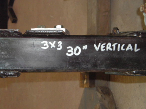

Hi everyone,
I wonder if some one could help me: I’ve got a Yanmar 3110D which was supposed to have the front end loader. It comes with all hydraulic gear and tubes for front loader and the support for it as well. The question is there are no arms. I would like to build my self the arms but no idea of size and angle for the arms. Can some send me the draw? I’m in Mozambique (Africa), and it is very hard to get anything from here…

Jose, I have some pictures that might help. They are of a FEL, about the equal to a Koyker 80 model in dimentions. As I dont want to clutter the board I will include a few. It will require you to modify the numbers to accommodate a much bigger tractor, but may be as simple as adding in inches, length, width and material thickness. Regards, Mark

As you can tell (hopefully) that it may seem a little complicated but, if your equipped and have access to the materials, It shouldnt be too difficult. Good Luck, Mark
