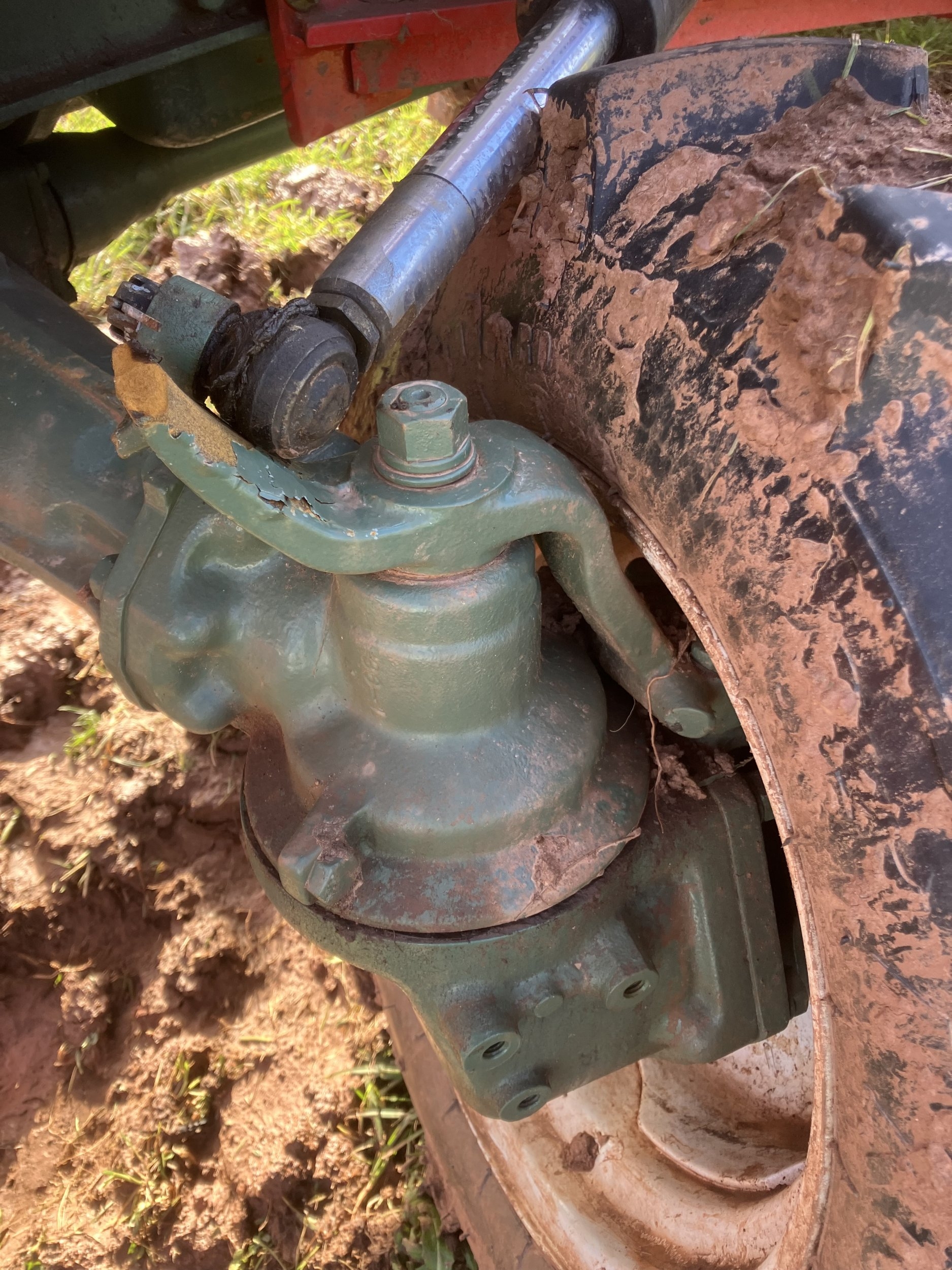

Hi All.
I am trying to find a replacement steering arm for my yanmar 2310d. May have to get one cast.
Any ideas where I could get one?
Many thanks
   / Yanmar 2310D steering arm. #2
You could reachout to these folks it has new owners now but supplies used parts Yanmar Tractor Parts
You can also look under the Yanmar form specifically for a couple of other providers good luck
   / Yanmar 2310D steering arm. #3
If it's 'cast steel', I'd weld it. If it's 'cast iron', it's a lot more tricky. Might not meet the standard for going to the moon, but a good weld would probably outlive me.
   / Yanmar 2310D steering arm. #4
Had same break while loading my BIL Yanmar tractor to borrow. The new part was much heavier cast. From the local JD Yanmar dealer.
Brazing cast repair might last.
   / Yanmar 2310D steering arm. #5
Before having one cast if you can't find a replacement from Fredricks or Hoye then I suggest finding a good weld shop. That arm can be repaired by brazing for sure and maybe by welding. Properly brazed the part will be most likely as strong or stronger than original. I know that if it was my tractor I would braze it myself because I am good at brazing and am confident that it can be brazed as I have successfully brazed highly stressed cast iron parts in the past.
