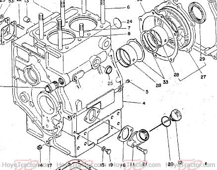

How do I check the oil level if there is no actual dipstick? Just put enough in that I can see the oil? Thanks.
   / yanmar 2000 #2
Which oil level are you checking (engine, trans, 4wd)? They all have a dipstick.
   / yanmar 2000
Engine. I swear I can't find an oil dipstick. All I see is like a filler hole. That's it. Thanks.
   / yanmar 2000 #4
The oil fill plug should have a dipstick under it. It's the lower one in this photo. I posted this when an owner mixed up his transmission and oil dipsticks and asked which is which.

I feel like a dumb***, but this really the only one I see. The only other one is below the front seat. Thanks.
   / yanmar 2000 #8
so do you see it or not? its on the engine on the starter side and is under the cap...made onto it/. The trans stick in ontop of the transmission below the front of the seat?
