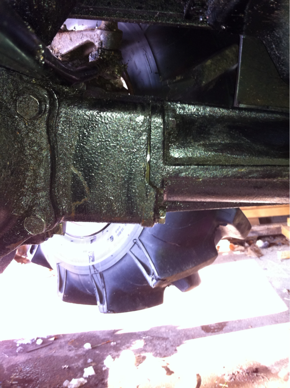

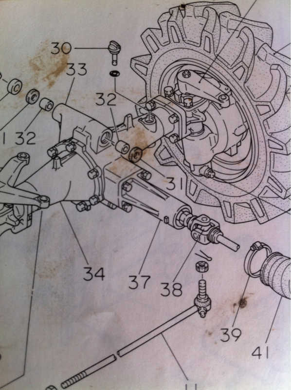

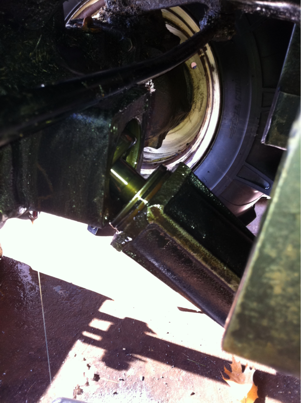

I did some of the tests you-all suggested and it seems the front wheels are still linked. Rotate one and the other counter-rotates. Blocked one and the other held firm. Found evidence of the trouble (see photos): there are four bolts holding the "pinion holder" (part 37) to the "axle case"(part 33). The two lower bolt flanges of the pinion holder are cracked off and the pinion holder is no longer in perfect alignment with its seat on the axle case. The two remaining bolts at the top won't hold parts together properly.
When I hold the pinion holder tight to its seat (just tested this with the two remaining bolts torques down and the shims, about 1mm, removed) all the gears seemed to mesh. If the bolts back out even a bit (1/16"-1/8") or the pinion holder is at all out of alignment the gears don't engage properly and I hear the sound of grinding gears.
When I disconnected the pinion holder I thought the pinion would pull out but there that's pretty big bearing that is too large to exit the rear of the axle case, so I cannot see the condition of the gears inside. I could see a damaged snap ring on the shaft between the metal ring (bearing) and the shaft inside the pinion holder. It must have been pushed off whatever groove it was in and is just riding on the shaft loosely doing nothing. It slid away and I can't get at it to show you.
Any thoughts on what to do next? Get someone to weld the flanges back on? Pull the whole axle off and take the works to a machinery service center?

Id figure it out, how to take it apart, inspect all the pieces and then get someone to weld that flange up prfessionally, and replace the damaged or worn parts. But your going to have to dig at it and figure what holds what in place and get inventive, unless someone with personal exp taking that apart chimes in.
   / Yanmar 187D - 4WD just quit on me #7
Ouch. I don't see how anything short of replacing the tailshaft housing ("pinion holder") would restore original strength.
If you simply can't obtain that part - is there enough meat left for a blacksmith to fabricate a strap across there that transfers the bolt stress to the remaining good iron? I don't see how just welding the ears back on would be sufficient.

I know pictures can be decieving but it sure looks like that bearing is about the same od as the opening. Not meaning to question you, just asking if it could be a slide fit in that housing? You have a nice drawing of the outside, do you not have a drawing of the inside? For sure a used tailshaft housing would be the best solution. If one is not available a "good" welder can do a lot.
OK, after a little more thought, I believe you can remove the u joint, remove a nut or whatever is on the pinion shaft and probably a seal, then snap ring against a bearing and then slide the pinion housing off of the pinion shaft. The bearing will come off with it. Talking about an outer bearing now.

Thanks Winston1 and California. I tried to work that bearing out through the hole - they are nearly the same size but it wouldn't come through. I may try one more time. The strap idea may work. There's a little "meat" on the pinion holder left that the strap could grab. The other thing I might try is to fabricate a collar around the pinion holder, and make it out of epoxy resin and carbon fiber or Kevlar fiber. With longer bolts it might work.
The other thought is to simply weld the pinion holder to the axle casing. I know this sounds weird but if it ever has to come apart again the weld can be ground off. As long as the rubber O-ring seal doesn't get cooked from the welding this might work. Maybe a MIG or TIG welder would run cool enough.
Please let me know if either idea makes sense. Getting the tractor to a shop involves 40 miles of driving with a trailer, and I don't have a trailer.
Getting the pinion holder off the shaft by removing the rear nut looked risky- the nut is held in place by a special washer that engages the shaft spline groove. The washer has six tabs that are folded up against the six faces of the nut so it cannot turn. I'm guessing that this nut also controls how far in or out the pinion gear is set against a bevel gear. In other words it's a factory-set tolerance.
   / Yanmar 187D - 4WD just quit on me #10
You are probaby right about the setting on the pinion shaft. You can adjust that when putting it back by simply feeling the back lash between the pinion and ring gear. As long as you allow just a little back lash you would be OK. I got this idea from looking at a John Deere drawing of a 650 which has that same set up.
