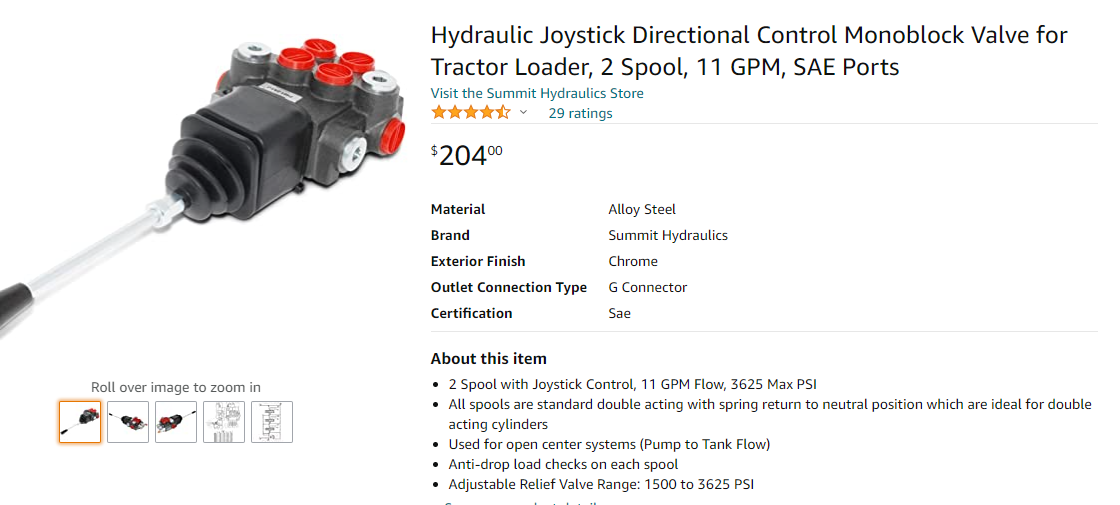

Had a "big" snow (7 inches!) here in DC yesterday and the single-stick bucket control handle decided to snap before I even moved, leaving me to run my Wheelhorse 418 to plow it all out.
I'm not a hydraulics whiz, so I need some help with getting a new control block installed.
Currently on the existing block I have an in/out from pump, a return to the filter on the transmission, and the 4 quick-disconnect hoses for the cylinders.
Here's the new control Amazon page: Amazon.com: Hydraulic Joystick Directional Control Monoblock Valve for Tractor Loader, 2 Spool, 11 GPM, SAE Ports : Industrial & Scientific

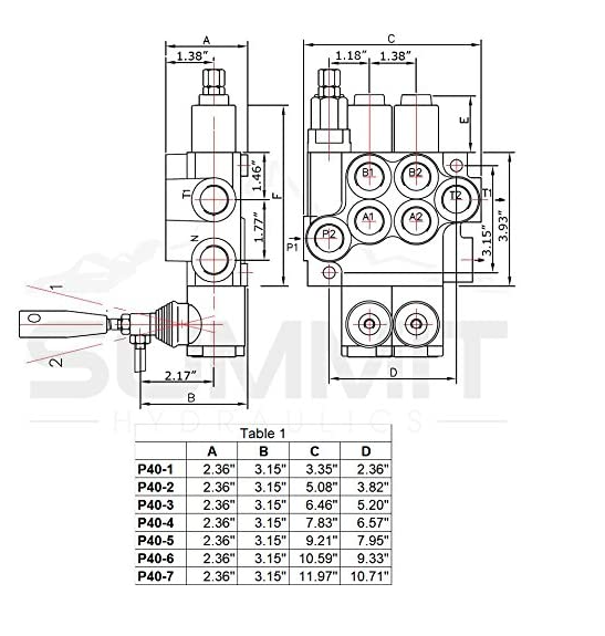

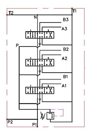

The help I need is to decipher the various ports on the new control to plug in the hoses. I see six plastic plugs on the new control, but I've got 7 hoses - what goes to what?
I've included the hydraulic page from the service manual and the schematics from the new control.
Much appreciate your expert guidance!

So, on the new valve you have the 4 work ports on top, that should be easy to figure out. Next, you have 3 ports on sides marked as: P, T and N.
P is pressure in from the pump
N is power beyond that will feed the 3 pt
T is tank.
The N port comes blocked with a plug, that will have to come out. One thing I didn't see you mention is the power beyond sleeve for that valve, that will go on the N port and then the hose will attach to that sleeve.
This power beyond sleeve looks like this one (image below) and it has to be the right one for the valve you bought.
Hopefully this info helps you figuring this out.
EDIT: Here is the link for the power beyond sleeve for that valve: Amazon.com: Power Beyond Adapter Sleeve for P40 & Z50 Series Summit Monoblock Valves : Industrial & Scientific

Do you have a hydraulic circuit schematic for the YM186D? There is one in the Yanmar shop manual. It will tell you important things like how the hydraulic pressure is distributed between the FEL and the 3pt system. There are several ways it can be done.
BTW, your YM186D has open center hydraulics. Be SURE to clean the cleanable strainer in the transmission sump. I'll look up the flow gpm. Do you have the optional power steering?
When you order the control valve, be sure to get the optional Power Beyond capability and both the sleeves - the required PB sleeve if you end up using power beyond, and the other sleeve that is required if you block the PB port. That costs little additional and gives you all the options.

That attached pic is the hydraulic schematic from my 186D service manual, but I'm definitely not smart enough to be able to interpret it with confidence.
