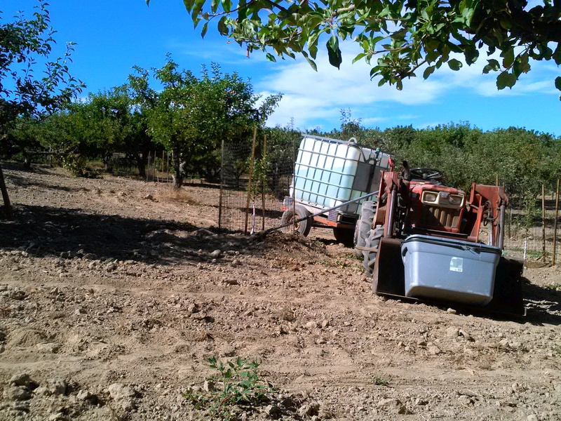

Its not acceptable to run a 6:00x12 in place of 6-12.
As Winston said, 6:00x12 has 6 inches larger circumference. At each revolution of the front tires, the front of the tractor tries to move forward 6 inches greater distance than the rear tires move forward. Tire slip - skid - is the only way the tractor can move at all. This mismatch will destroy driveline components.
Particularly with weight in the loader, both the front and back of the tractor have good traction so the stresses are huge.
That said, I'm running that mismatch temporarily on the YM186D that I use all the time - but I never engage the front axle unless the back tires are slipping, or when my safety on sloped ground is more important. I put on some used 6:00x12's until I can get around to buying the proper 6-12's. And I worry about it every minute I use 4x4.
Photo last week, watering new trees. There's so much weight on the rear hitch that the front end is light. 4x4 is needed for safety driving down the slope, and for turning here instead of plowing straight ahead. The water level in the tank is level, for reference.
