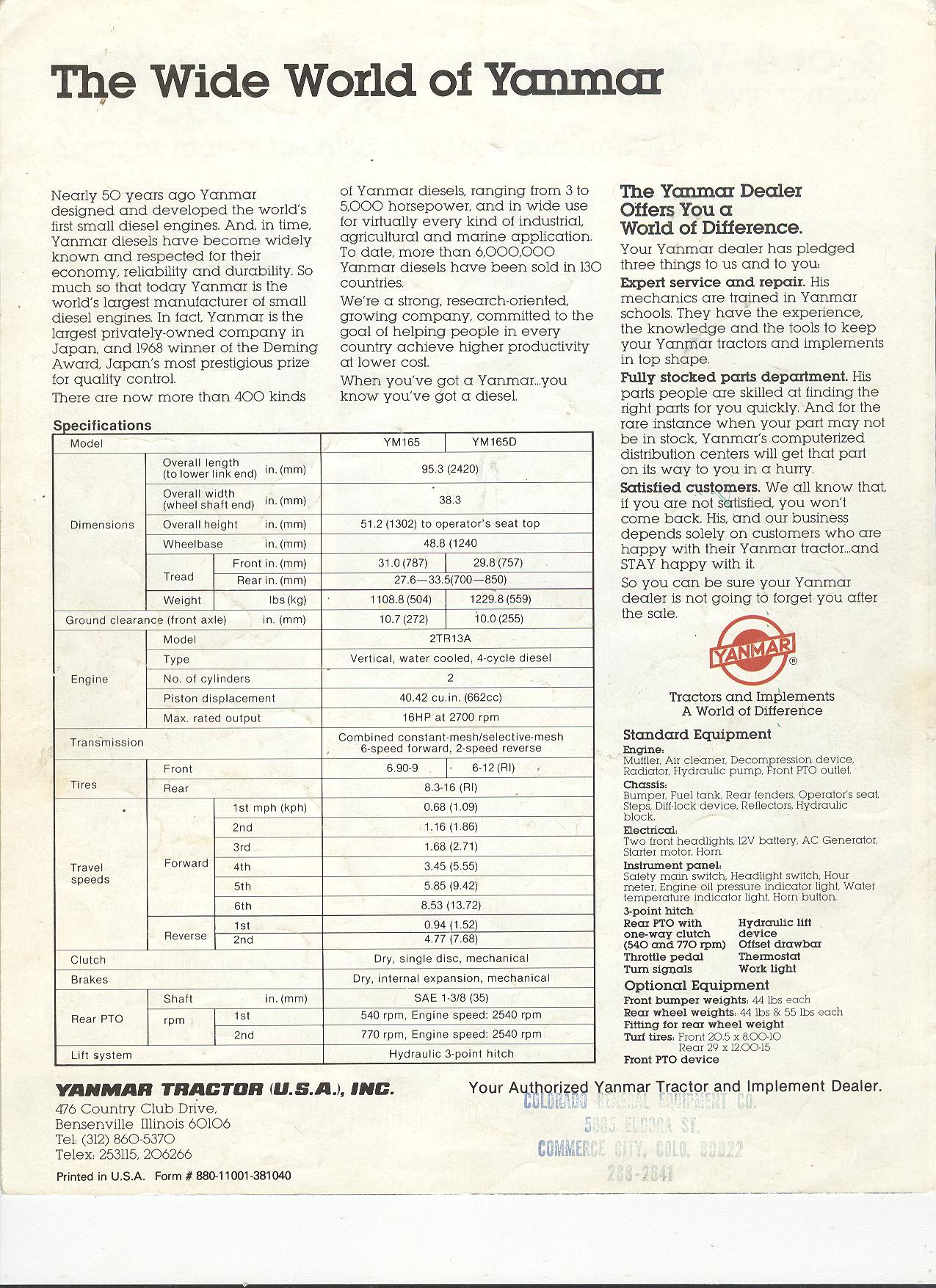

Here's some literature for your YM165D.
It was possible to run a loader -slowly - using nothing but the 165's internal hydraulics, but most used a small accessory hydraulic pump driven off the front of the crankshaft. That can be changed at any time, and it allows the loader hydraulics to be completely isolated from the tractor hydraulics.
The best loaders for any of these small tractors is one that has a subframe that runs from the front frame of the tractor all the way to the rear.... and ends up bolting to the heavy metal - in this case around the transmission case where the rear axles come out. Today, no loaders that I have seen are being made without that subframe, but a few decades back a few light duty ones were.
