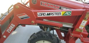

Hello...I just purchased a 1610D with FEL (Stock I believe). The bucket hydraulic ram seals need to be replaced as the bucket begins to lower when static instead of maintaining its position. The local shop needs the seal replacement kit information...any thoughts? I haven't received my parts / owners manuals yet from Hoye, but I need to get this repaired ASAP. Any assistance is appreciated!

Unfortunately, the manuals will not cover the loader itself because that is an add-on. Does the loader have any brand/model decals on it at all? If so, you might be able to contact the loader manufacturer or dealer for them. If not, we have always just taken the cylinders in to the hydraulic shop and they just matched up the seals there & rebuilt them.
   / Yanmar 1610d FEL loader hydraulic ram question
   / Yanmar 1610d FEL loader hydraulic ram question #4
Interesting. I don't think I have ever seen that brand before. Looks like a Japanese aftermarket loader manufacturer. Sort of like the Japanese version of Koyker or something.
株式会社 丸久製作所
They might be able to help but probably just easier to have a local hydraulic shop match the seals up.

Neither cylinder is leaking to the exterior and the loader itself works fine, just the bucket issue...
   / Yanmar 1610d FEL loader hydraulic ram question #8
Again not saying to not rebuild the cylinder, but if it is just seeping past the the internal seal when not running, you have time to try to find information about the loader and the cylinders.
As Aaron said, a good hydraulic shop should have no problems taking measurements of the cylinder components and matching up the seals and all needed to rebuild it. The only issue I could see would be if they used the cheap not rebuildable cylinders. It should be easy to figure out as the end at the rod will not be removable. If that is the case, plan to replace the cylinder. Measure the rod length, rod diameter, overall length extended and retracted, and cylinder diameter and the pin size of the ends (diameter) and length of the ends. Then start looking for replacements.
