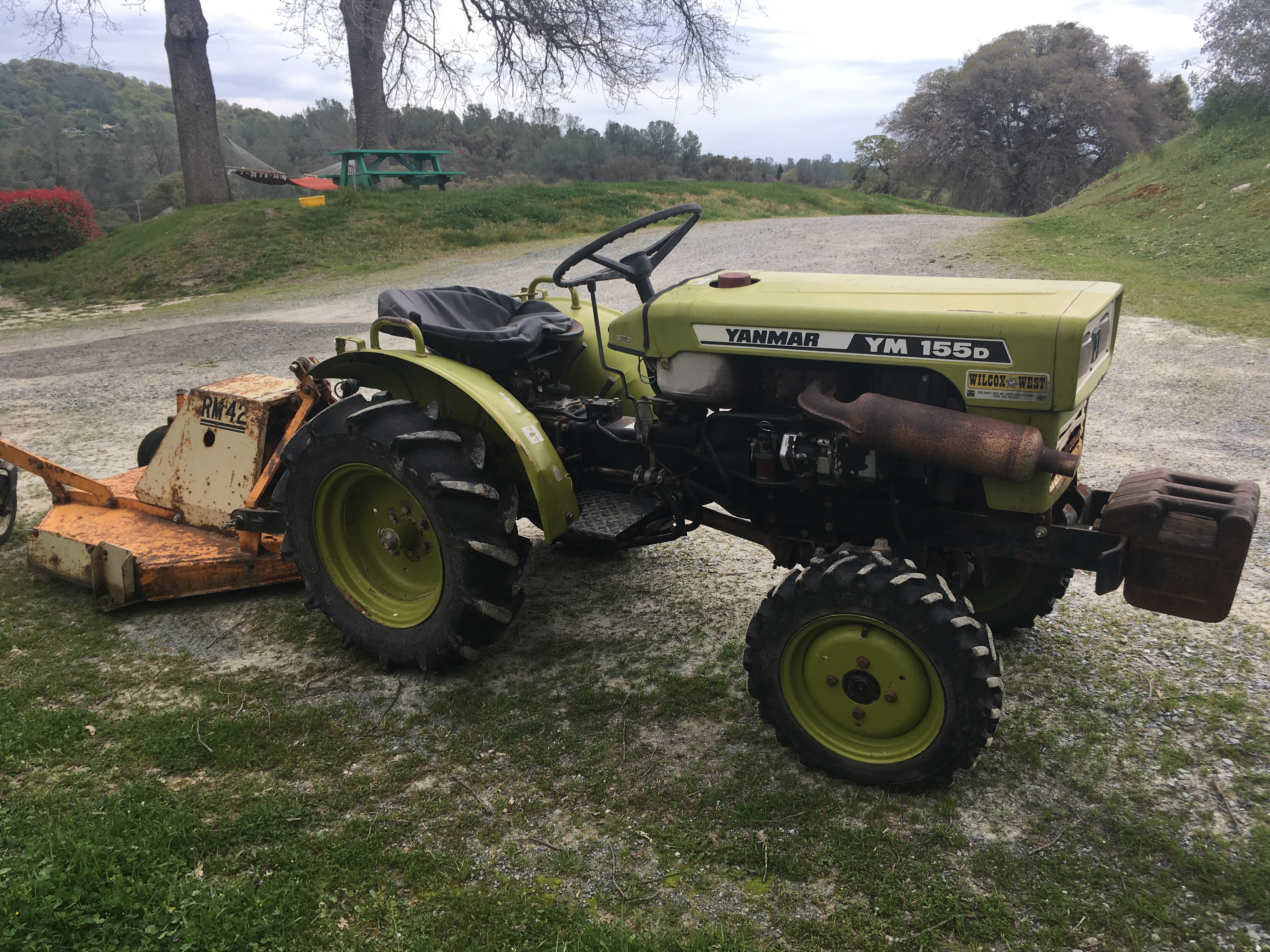

Hello and thanks for having me on the forum!
My name is Grayson and I have managed vineyards in the Sierra Foothills of California as my day job for a while now (currently with the boss's Landini 85F), but just moved on to my own small vineyard and have thus purchased my first tractor -- a Yanmar 155D, which my wife has named Jolly Green. I paid $3500 for the tractor, a Woods 50" (48"?) mower [EDIT: Woods RM42 = 42" mower], a rototiller (remembered the brand right up until I started writing this post), and a spring harrow. For CA standards I think it was a pretty good deal. It won't be able to do everything I need it to do right away (notably spraying) but it gets me pretty far and it feels good.
ANY commentary on the following is very, very welcome. I am also a new dad and haven't been able to do as much research as I'd have liked so far, but I'm taking a day off tomorrow to focus some tlc on the new machine. I can offer gratitude, vineyard advice, and maaaaybe some Landini semi-expertise in return :)
I mowed a few rows after trailering it home the other day, but I think it'll be wise to do as much fluid-servicing as I can before really putting it to work. First tune-up will include:
-garden-hose radiator and block flush. I am planning to do each separately first with motor off, then fill system with water and run, drain, then fill with coolant mix -- sound good?
-engine oil change (am i correct that engine and transmission/hydraulic lubrication systems are separate?)
-check transmission/hydraulic but not planning to change at the moment
-air filter change
-fuel filter looks new but will double check
-tighten fan mount, anything else I notice
-sharpen and balance mower blade.
-blow out cobwebs / tidy up
-What else to look out for?
Lastly a few questions:
-Anyone else use the Woods mower? The PO said to spin it at 540 but the mower itself says 800 (which I assume means 770?). The first cuts were not that impressive, hoping a blade-sharpening will help, but I probably want to use the faster PTO setting too?
-Can anyone point me to a dashboard diagram (indicator lights, etc) and a simple spec sheet (fluid quantities etc)? I've only been able to find the Service Manual online and it skips such basics.
-ANY other pointers / advice very much appreciated. $3500 might not seem like much for a tractor, but margins are tight for my little family and I want to keep Jolly Green running strong for as long as I can.

Welcome to the forum, very nice introduction and a nice looking 155D. :welcome: I will be sending you a pm. Might note these posts about the rm42 being rated for 2000rpm. Gary Jamison that stated that is very knowledgeable about the smaller Yanmars. I'm sure he would welcome a call from you and be willing to talk to you about the mower. Jamieson's Tractor Sales

California if I had my guess, I think that is a finish mower so blade sharpening would be wise. Also the higher RPM would also make more sense in a finish mower than bush hog.
Oops I think you are right. Graysonh listen to Clemsonfor, not to me!

After a little research I have another thought or two about your mower. Your mower picture shows it to be an RM42 which stands for 42" cut. The RM stands for rear mount. These mowers are classified as finish mowers. They have a single swinging blade like a rough cut rotary mower. They also have an over run clutch built in. Also seem to come in cw and ccw rotation. The on line parts manuals indicate different suffixes on the end of the RM42 such as YM-1, YM-2, KB-1, JD-1. I would believe that would indicate tractor manufacturer. Wondering if yours has one of these suffixes on it anywhere? Here is a good shot of the belt configuration. https://d323w7klwy72q3.cloudfront.net/i/a/2016/20161214ve/L4903F.JPG
The YM155 has a two speed pto and 2nd is 770rpm. I am guessing that would be the speed for your mower. Only an opinion, not fact at this point.
