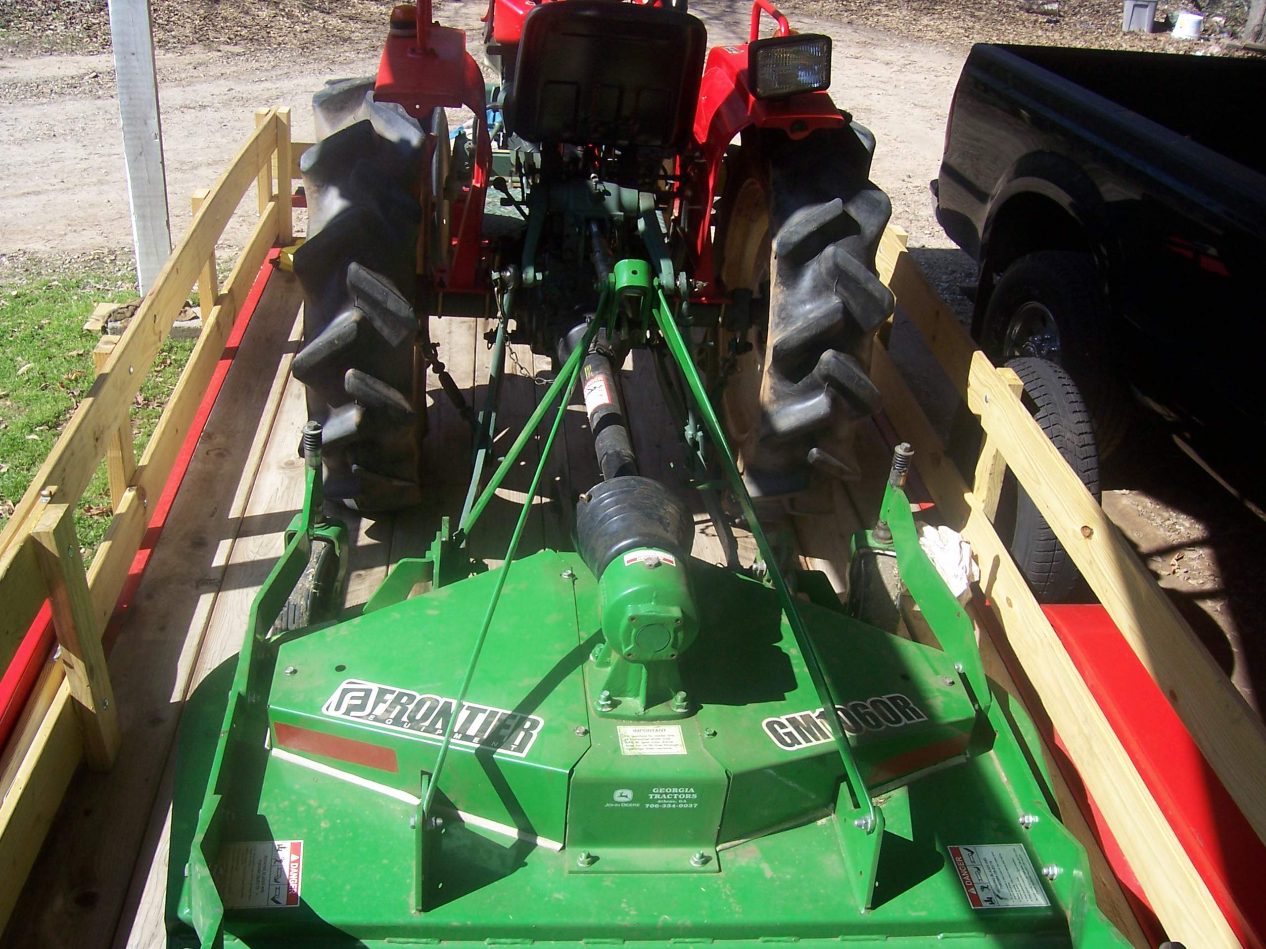

Frontier "Woods"GM 1060R 5' 611 Lbs. 1072-6' 678 lbs. 1084-7' 774 lbs. Absolutly love mine. It's BA. esp. with non lift straight blades and R Discharge. Best mower I've ever owned and prob.ever will. :thumbsup: Here's a 5' on a YM2000. I've never seen a 4' Woods but guessing easy 500lbs.
Carey, I purposefully took the lift off a set of my Woods blades, mainly because of the dust cloud in dry weather, but I wouldn't doubt it takes 5 less horsepower to turn them. I really can tell very little difference in the cut. They don't even sell the non lift straight blades for my mower. I looked by length, hole size, etc, etc, finally just cut the high lift off a set of gater blades. Not saying this is for everybody, but works for me.
