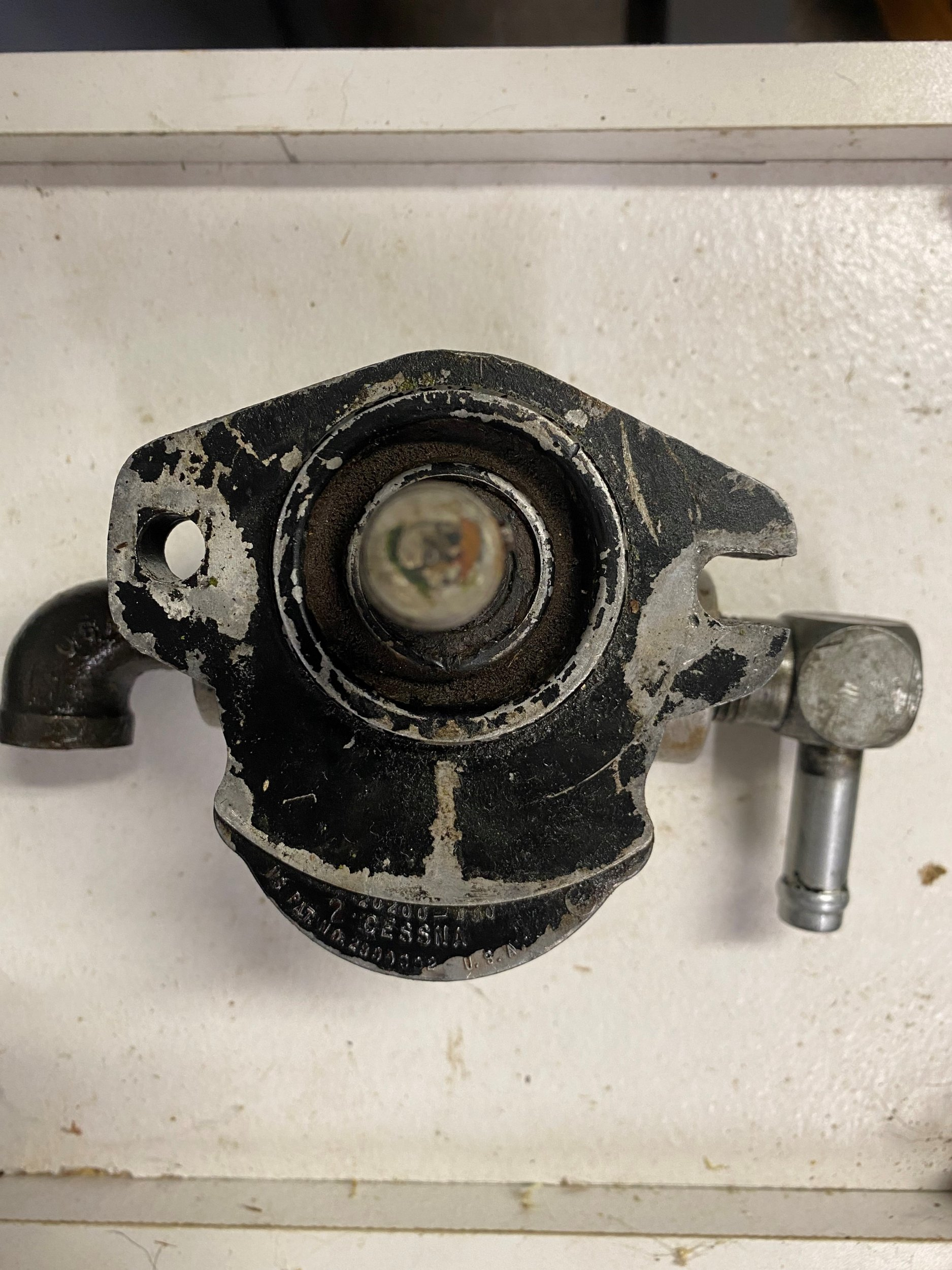

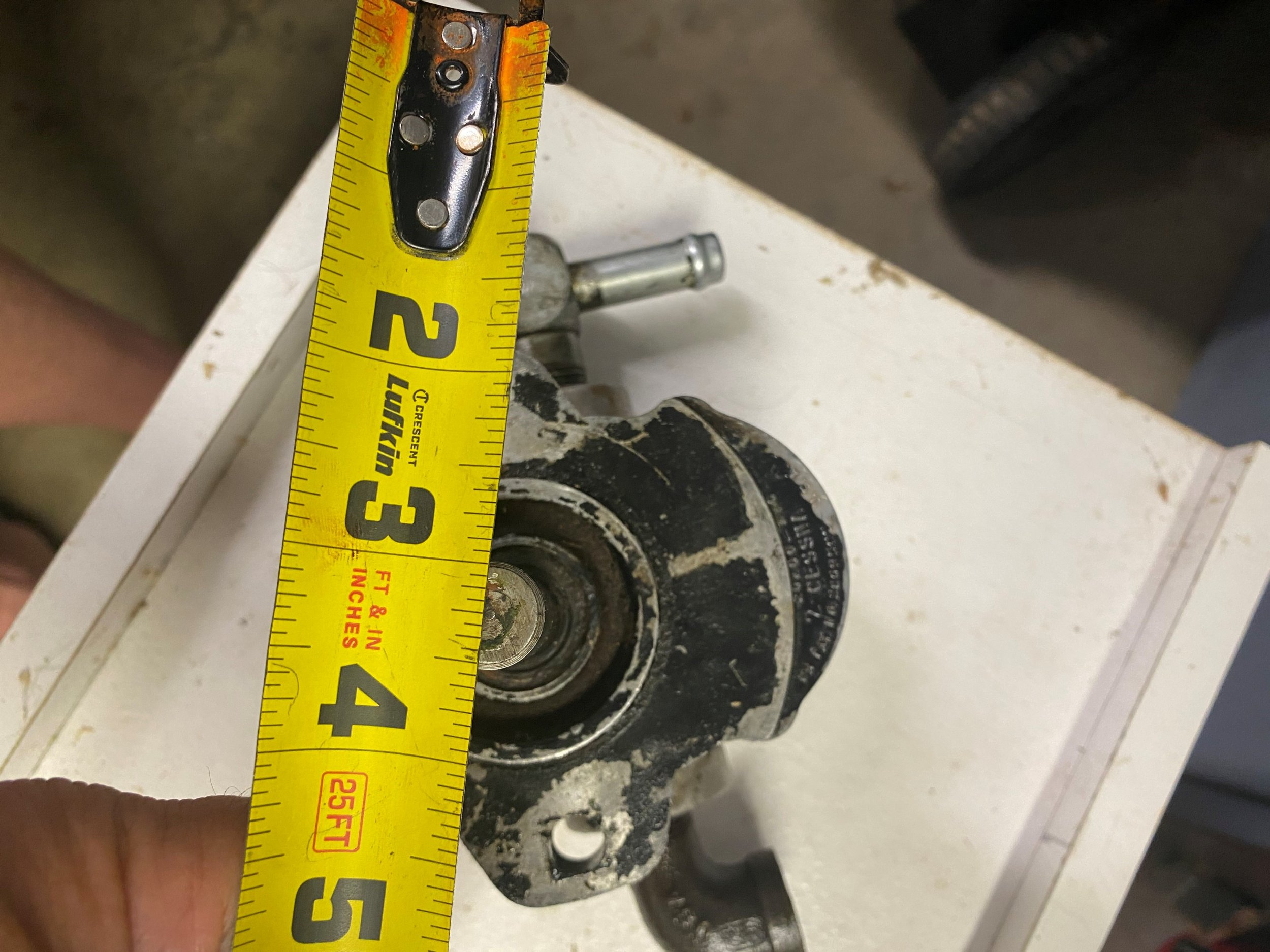

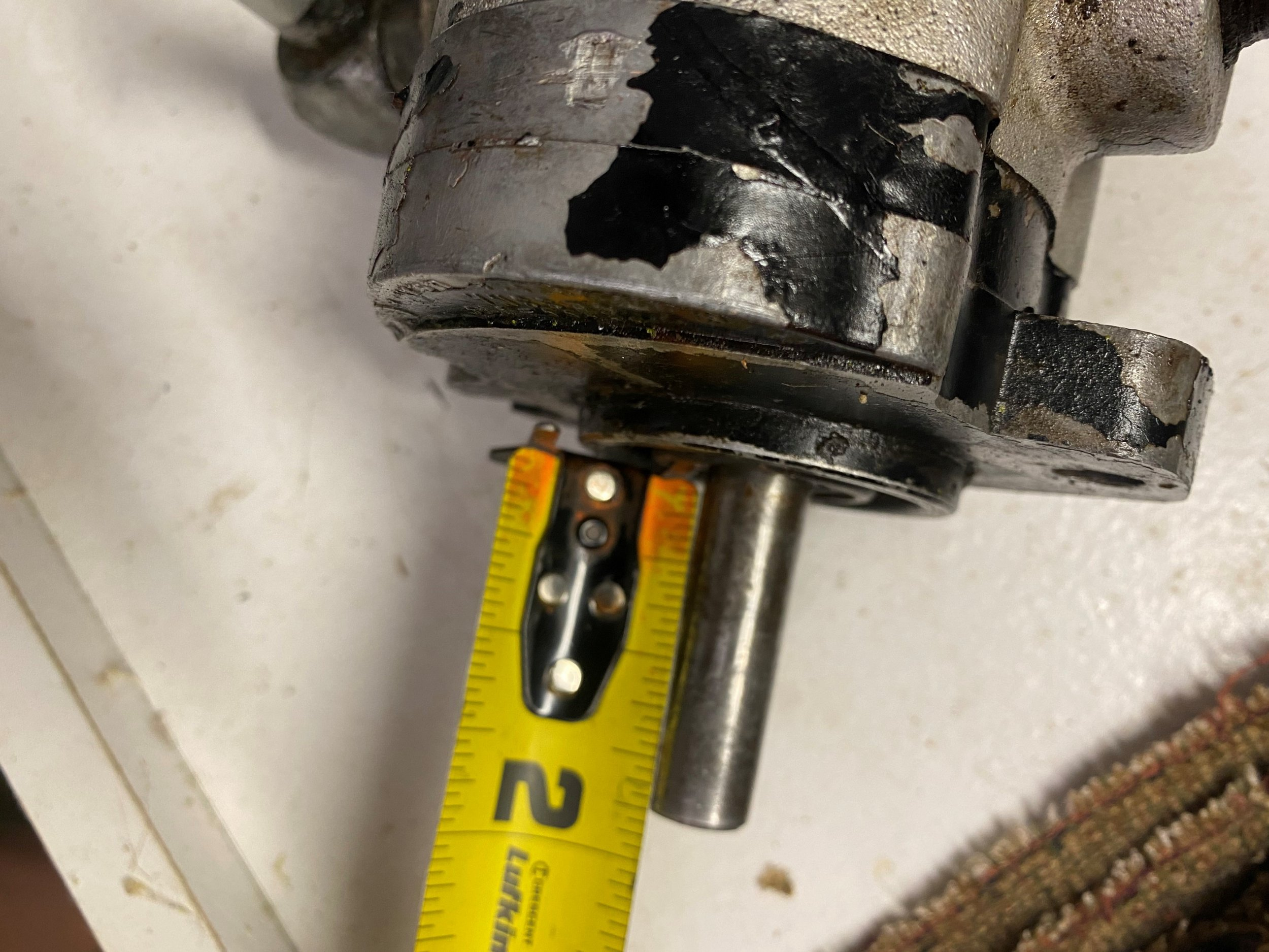

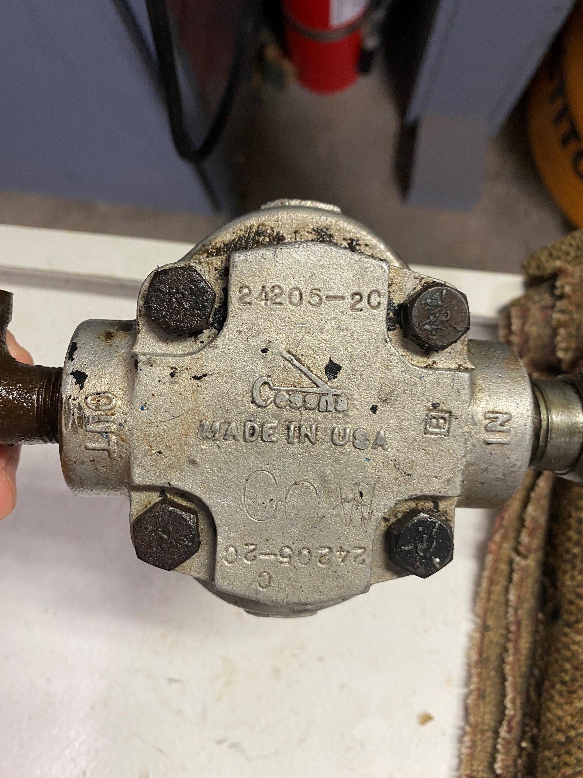

I need to replace/repair the hydraulic pump for the YFL-155 loader on my Yanmar 155D. The pump was made by Cessna (part no. 24205-2C) and seems to be "extinct". Plenty of hydraulic pumps out there, but want to make sure I get the right replacement. Any help is greatly appreciated!

Eaton purchased Cessna many years ago and now Danfoss purchased Eaton. You might be able to find the specs for that pump by searching under Eaton with that part number.
Unless something specific for OEM a replacement should be available.
   / Yanmar 155 hydraulic pump for loader #5

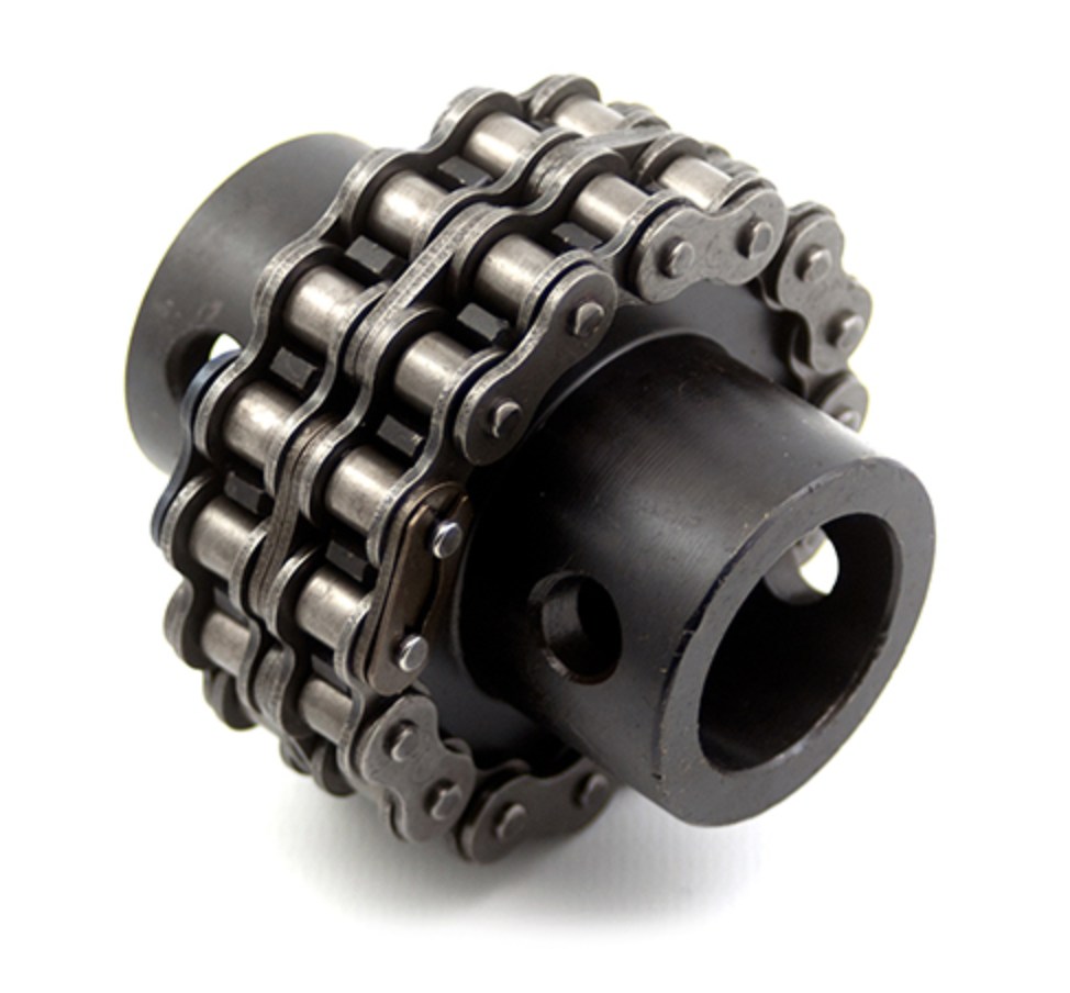

Is this the pump that attaches to the front of the YM155 motor with a double roller chain coupling? Pic below. If so, I may have some old reference material about that conversion.
It was actually an upgrade over using the YM155 internal pump.
What's wrong with yours?
There have to be a lot of hydraulic pumps that could be used there. Do you mind changing a few things to make a different pump fit?
