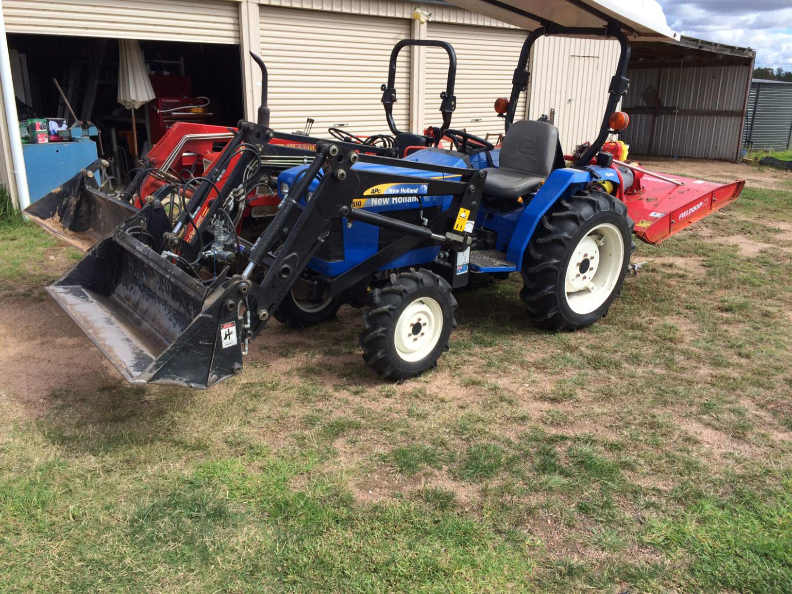

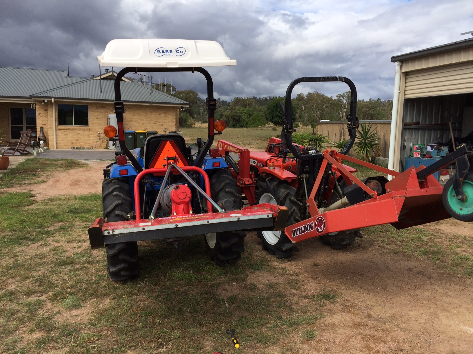

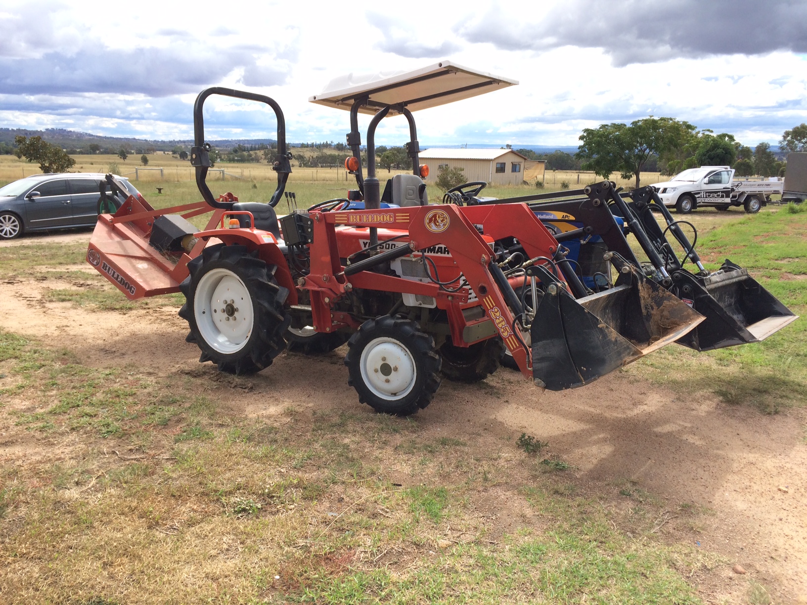

That Yanmar is now up for sale with a few interested buyers already. It's been a great back saving device. Only using it on occasional weekends, It's help plant over 200 trees and moved about 30 tonne (metric) of garden mix to help bolster the very poor decomposed granite soils I have. It also pulled out about 30 strainer posts (is that what you call them in the US?) and dug dozen of holes for the new rural fencing I had put in.
I upgraded to a New Holland 33hp 4wd tractor with a 4in1 FEL, it came with a 4'slasher, and I'm keeping the post hole digger.
This new one has shuttle drive so it's so much easier to use.
