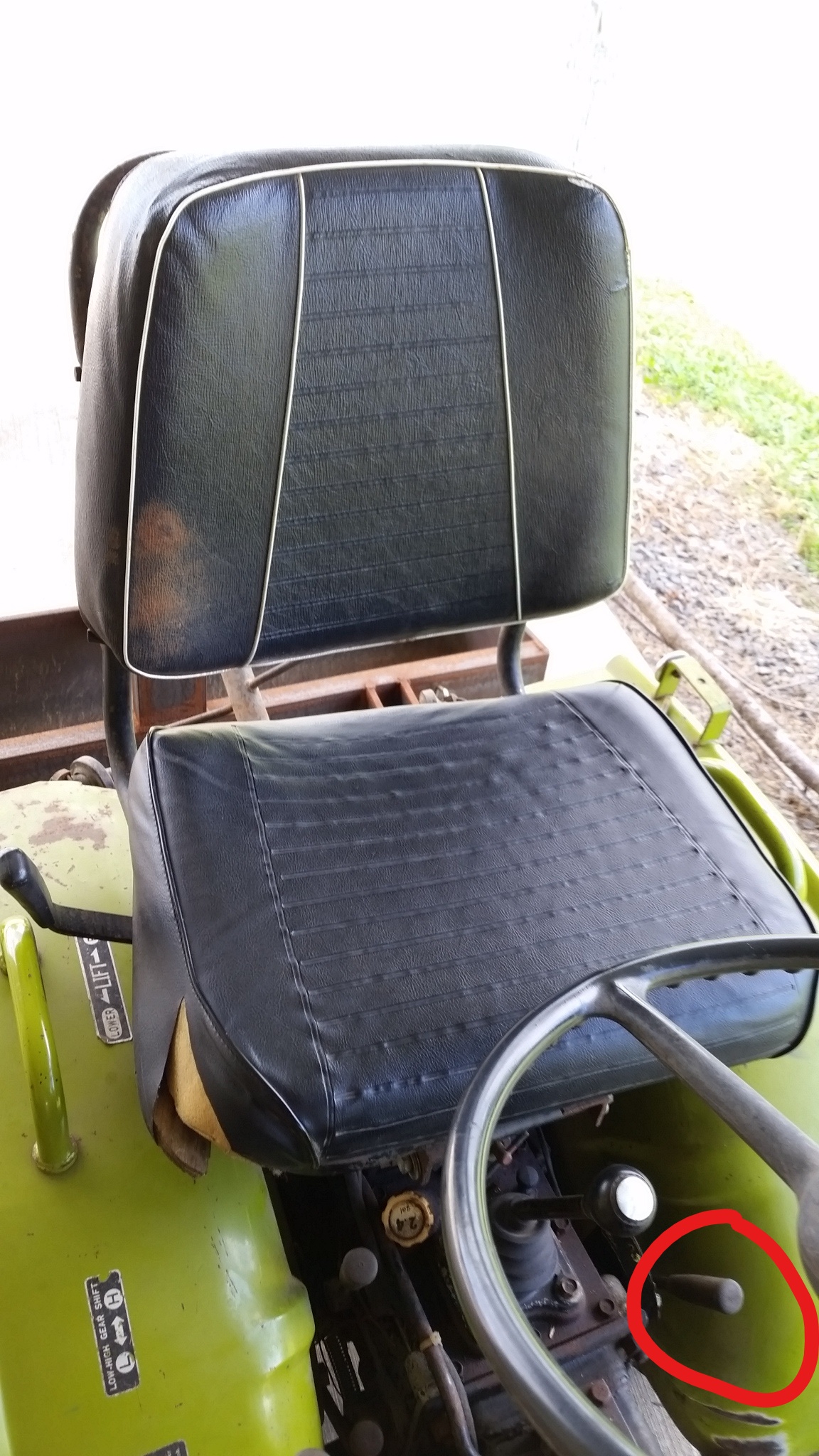

I have a Yanmar 135D 4wd. There is a lever on the left side next to the driver's seat and I have not been successful in determining what it does. The label is gone except for "PTO" so it must have something to do with the power take off. The PTO works fine for the rear lift. Can someone tell me the function of this lever (see pic)? Is this for PTO speed control? Thanks PTO Lever.jpg

That lever on the operator's left will engage/disengage the Power TakeOff shaft that sticks out the back of the tractor to drive a mower etc. That is separate and unrelated to the 3 point lift arms controlled by the lever on the operator's right side.
PTO will have a Lo speed about 540 rpm at 2200 engine rpm, and a Hi speed about double that. Any US implement will use 540 rpm and turning the implement faster is dangerous.

540 and 770 at 2540rpm. 540 would be achieved at 1781 engine rpm in high range.
