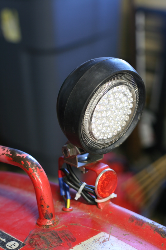

Has anyone ever come up with led headlight bulbs for this unit?
I wanted to have both forward and rear-facing lights on the existing headlight circuit, so I bought some of these 12v LEDs (they were sold as "Buyer's" rather than "TruckStar" when I bought them). In front, I bolted a couple pieces of 1/8" flat bar to the existing headlight mounts, and attached the lights to that. Then I mounted one in place of each of the turn signals in back. At about 1 amp each, the four combined lights draw about the same current as the two original 25w headlights used to, and they're brighter.
They do give a bit of a googly-eyes look to my 1510, though.
