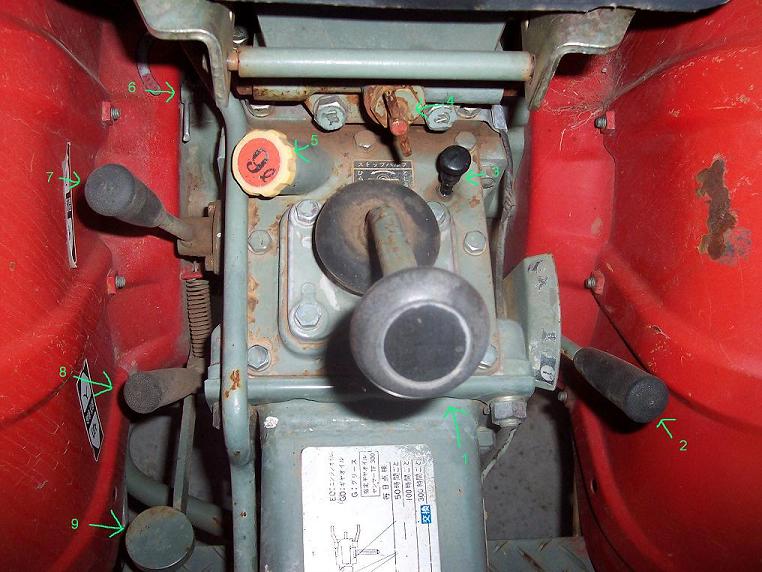

Hi all, its the Yanmar noobie again.
I'm about to order a manual from Hoye as soon as they get radiator caps back in stock (want to save on shipping).
In the mean time can someone help me out on identifing the 9 controls I marked on the attached pic. I know the following, but the rest ????
1. gear shift
2. PTO speed
3. Hyd/trans dipstick
4. ?????
5. Hyd/trans filler (what does the symbol mean?)
6. ?????
7. Hi/Lo range lever
8. ?????
9. ?????
Would appreciate any help til I get the manual.

Steve,
4. Hydraulic implement lock....locks the hydraulic lift arms in any position (for maintenance or travel).
5. Viscosity symbol, Here in the U.S. it is JD 303 or equivalent hydraulic fluid.
6. Hydraulic fall-rate valve. Set the speed of the lift arms when lowering with implements.
8. FWD - 4X4
9. Differential Lock...locks both rear wheels when actuated with your foot for traction.
Regards, Mark
