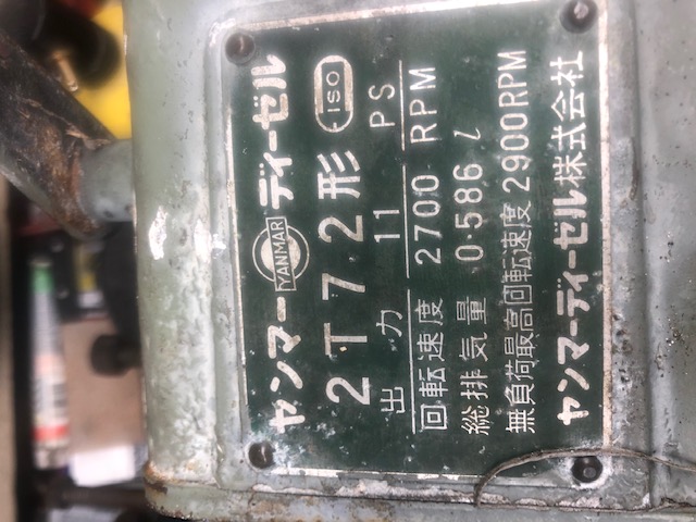

Good day to you all.
I managed to pick up a nice little 1100D cheap but it is missing the injector pump.
Does anyone know where I can get one? I have been looking all over the world with no luck.

If you have not try HoyeTractors in TX, Spaulding in GA, or Fredrick’s in AL.
You may also reach out to thepumpguy on this forum.
Hoye also has a ymowners forum that you may ask on. Of course watch craigslist and marketplace for parts tractors (although I have no ideal if it shares a FI pump with other models).

I did find this. "Did You know?
The "D" at the end of the Yanmar model number indicates that the tractor is 4wd.
The 1100(D) is a 13 horsepower tractor that was only originally sold in Japan. It is very similar to the YM135(D) that was sold new in the USA.
The Yanmar 1100(D) was built between 1977 to 1982.
The YM1100 does not have a water pump. Coolant mixture is very important to prevent overheating. Use a 25% antifreeze 75% water mixture during the summer and whatever is required to prevent freezing in the winter." so try a pump for a YM135(D).
   / Yanmar 1100D Injector pump
Thanks for that.
From what I read this particular engine has no interchangeable parts with any other make or model.
I will have a look and see if I can find any pumps for the YM135. The tractor is to good to scrap just for a stupid injector pump.
