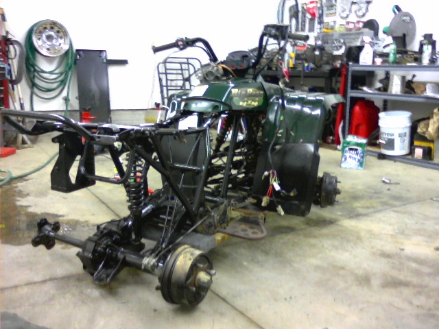

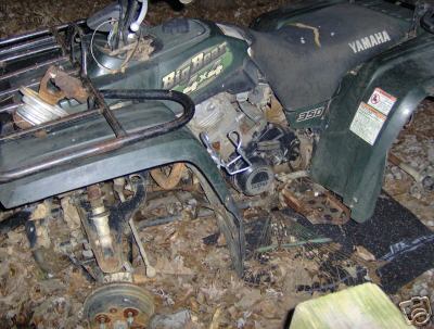

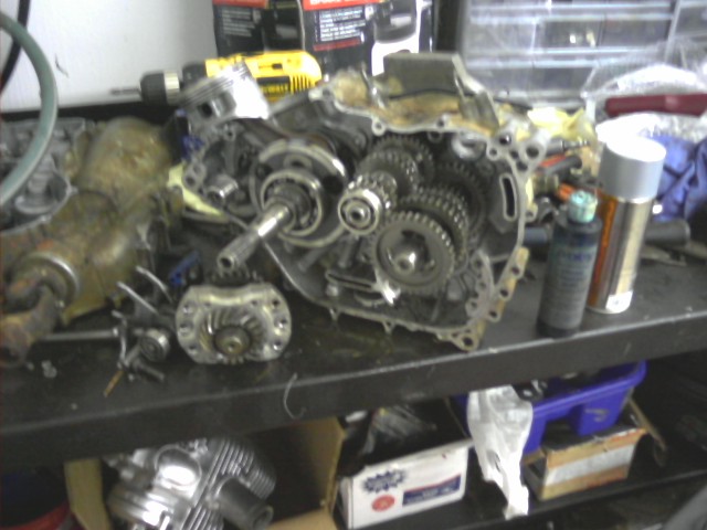

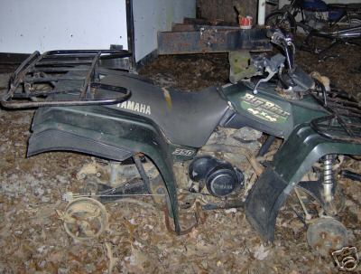

About 2 weeks ago, I bought a 98 Yamaha big bear to restore. It was in pretty rough condition as it had sat outside for a year or so, and had been stripped of its wheels and tires. It also had a transmission issue that turned out to be a launched bottom end. I probably should have passed, but I love challenges, here are a couple of pics from the ebay auction, they are the before pics, and also a few of the work in progress. I found a complete engine bottom end in mississippi, it should be here next week. So far I have steam cleaned and sandblasted and painted the frame and susension components, Removed the tree sap and polished the gas tank cover and front fender with a air buffer, and reassembled the chassis. Hope to start the engine and trans reassembly next week. If there is interest, more post and pics of resto progress to come

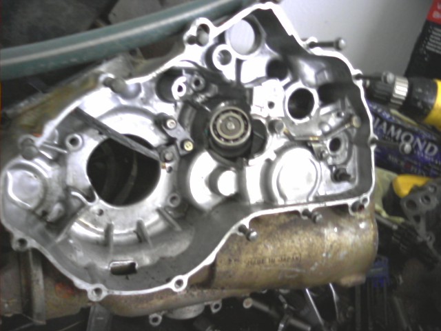

What do you mean by "launched"? What is wrong with that gearbox?

No , I drove 5 hrs to Kentucky from North Eastern Ohio to pick it up. The bottom end is blown up beyond repair, it has a trans gear that is seized to the counter shaft, which bound the trans. and blew a bearing mounting boss out of the left center case, taking the shifting mech and starter gears with it. Many of the parts are still good, including the crank, clutches, magneto, oil pump, etc. However, due to the extent of the damage, the most feasable and economical way to fix it was to replace the entire bottom end with a good used one, I may rebuild the replacement when it arrives, or may just use it as is. We will see how it is when it gets here

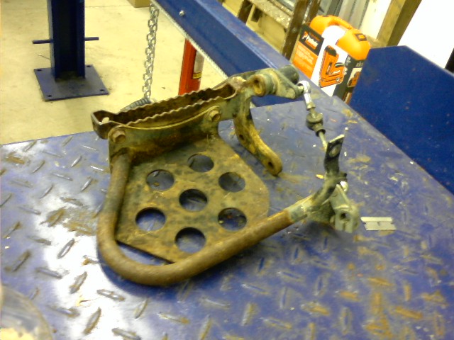

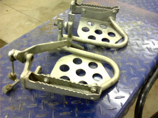

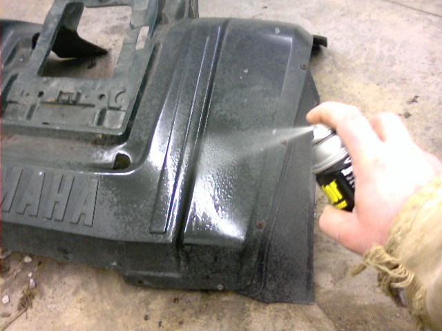

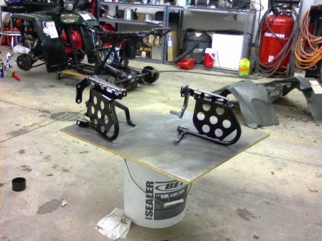

Worked on the big bear a little more today, finished all my sand blasting and painting, all that was left were the footpeg assemblies. I also finished stripping the 1 years worth of tree sap from the rear fender and polished it with the buffer. I was going to blast the racks to, but they would not fit in the blasting cabinet, looks like I will have to sand them instead. I also included a picture of the broken case that nececitated replacing the bottom end as you can imagine how much damage there was to the trans components and starter gears that used to mount where the hole is blown through.
