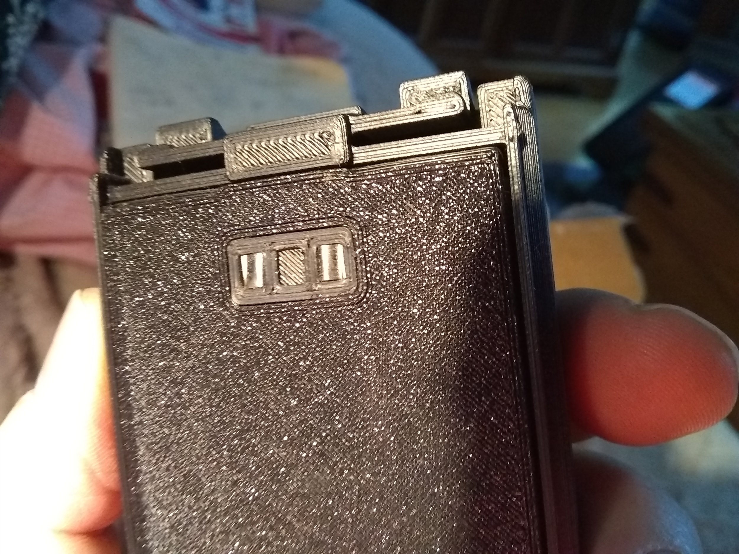

Reviews..... I look for appropriate balance when reading reviews, and want to reciprocate here....
Some guys nit-pick like they are judging Pebble Beach, and I'm mostly not like that. Kevin is a good communicator - describes the reality of low-volume 3D casings well - if somebody is looking for exact factory-matched finish, move along...
Me, as long as the case is structurally solid and functional, it's a Don't Care for me. YMMV, but the case itself is fine IMO.
What I did correspond with him about is the battery terminals. A limitation of the material he is using at this time is that some deformation can occur during assembly. It's fun being around a startup like this... it reminds me of my Olde Days..... I've only started dealing with him recently, but have seen him implement rapid business improvements and website changes in this short-time. In that spirit, I made a suggestion on material to prototype on future terminals. The sense you get reading his site for the first time is correct, he is committed to iterative design-improvements.
My OCD kicks in a bit, on terminal contact-area, but that comes from being around REALLY high-current contacts in a different world. I agree with the discussion Kevin and I had concerning the contact-materlal he is using currently (pun intended).
I did some 5w range testing with my FT5D, and agree, no impact on performance in this application.
In the picture attached, you can see the deformation in the left-contact. This is a fantastic product for these FT radios, and I only offer this feedback as full 411, and perhaps to save Kevin some time dealing with a duplicate query. I would not hesitate at all, to buy this product as produced now (I plan to buy another in the future, when he can get ahead of his present backlog).
Rgds, D.
