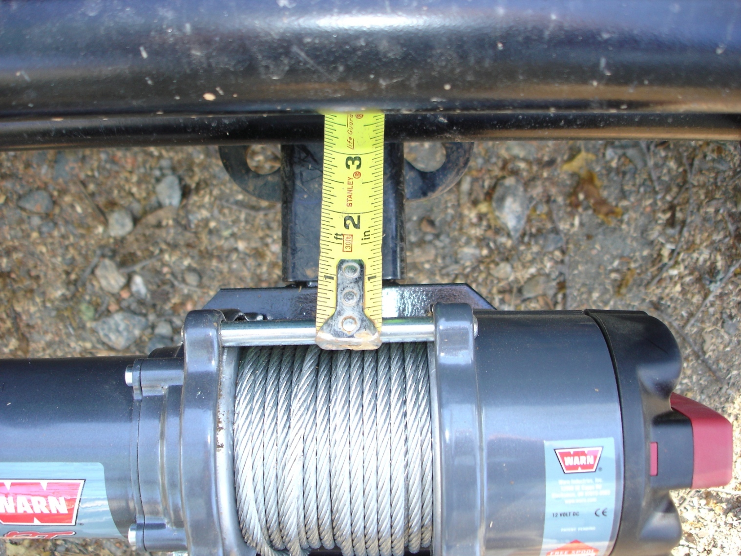

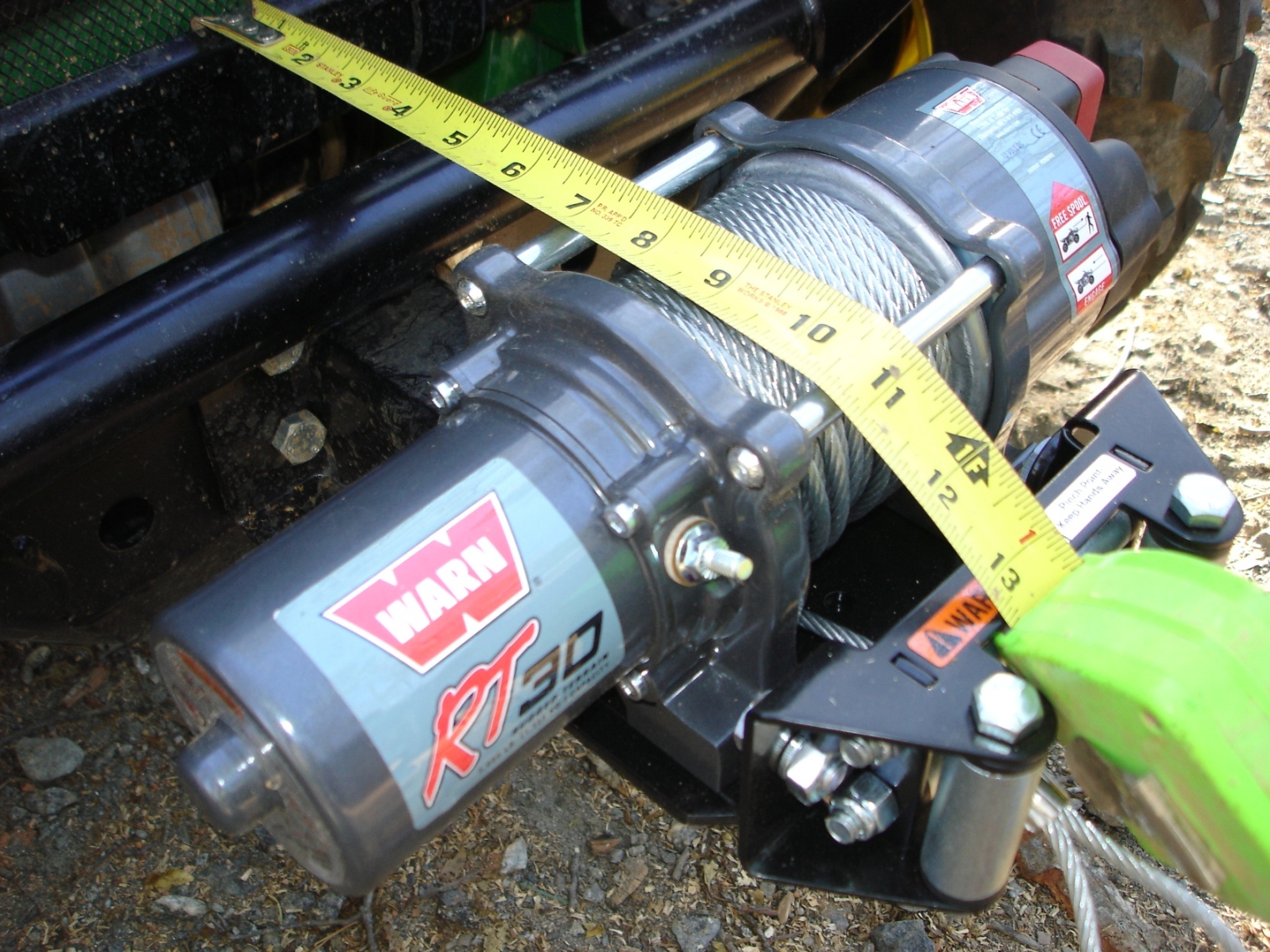

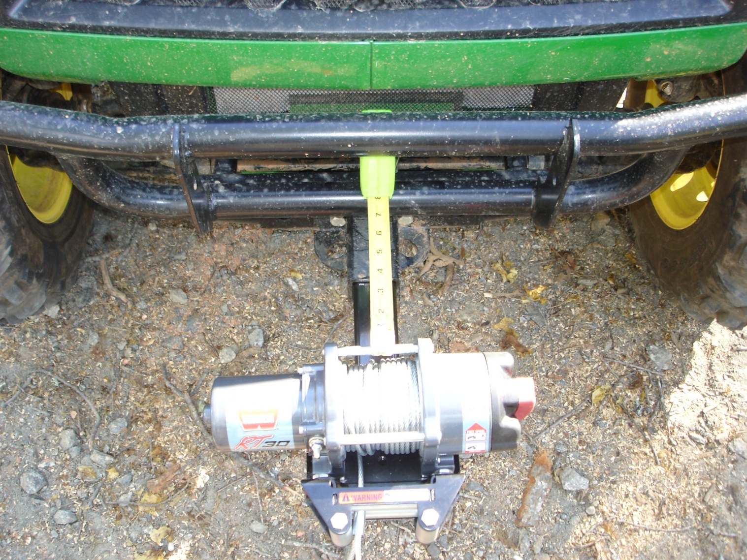

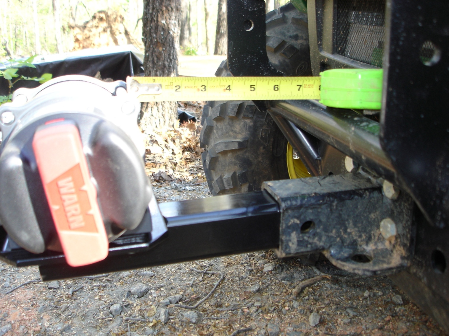

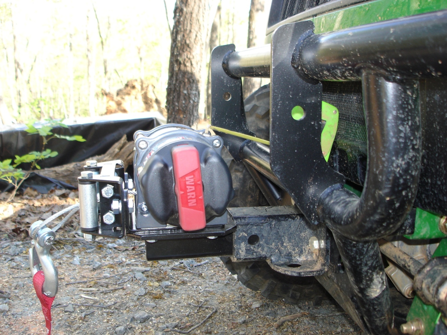

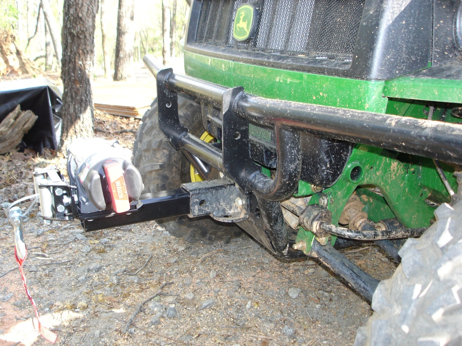

Here are some pix of my winch mounting plate before and after cutting it shorter. The final installation is very short. You can see that the back of the winch is only a few inches from the bumper. The pix with the tape measure hanging has the front hook along the grill screen, which is several inches behind the bumper. The first three are before shortening and the last three afterwards.
You would have to be attempting to start up a 70 degree hill for this to be in the way.
