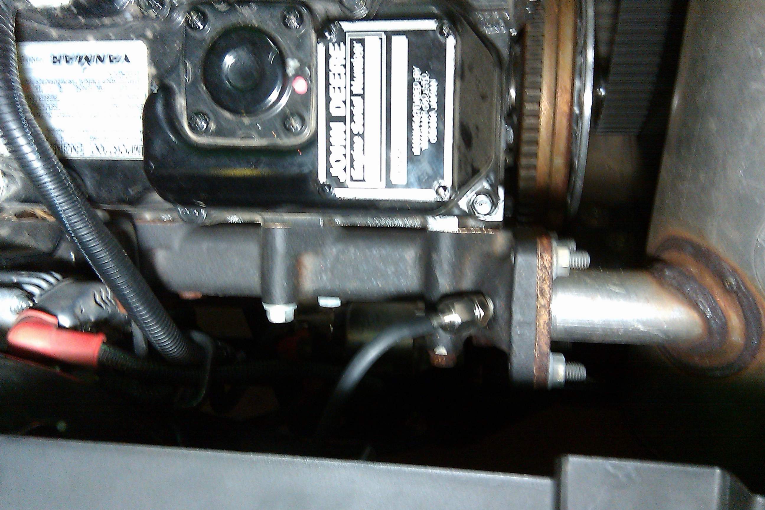

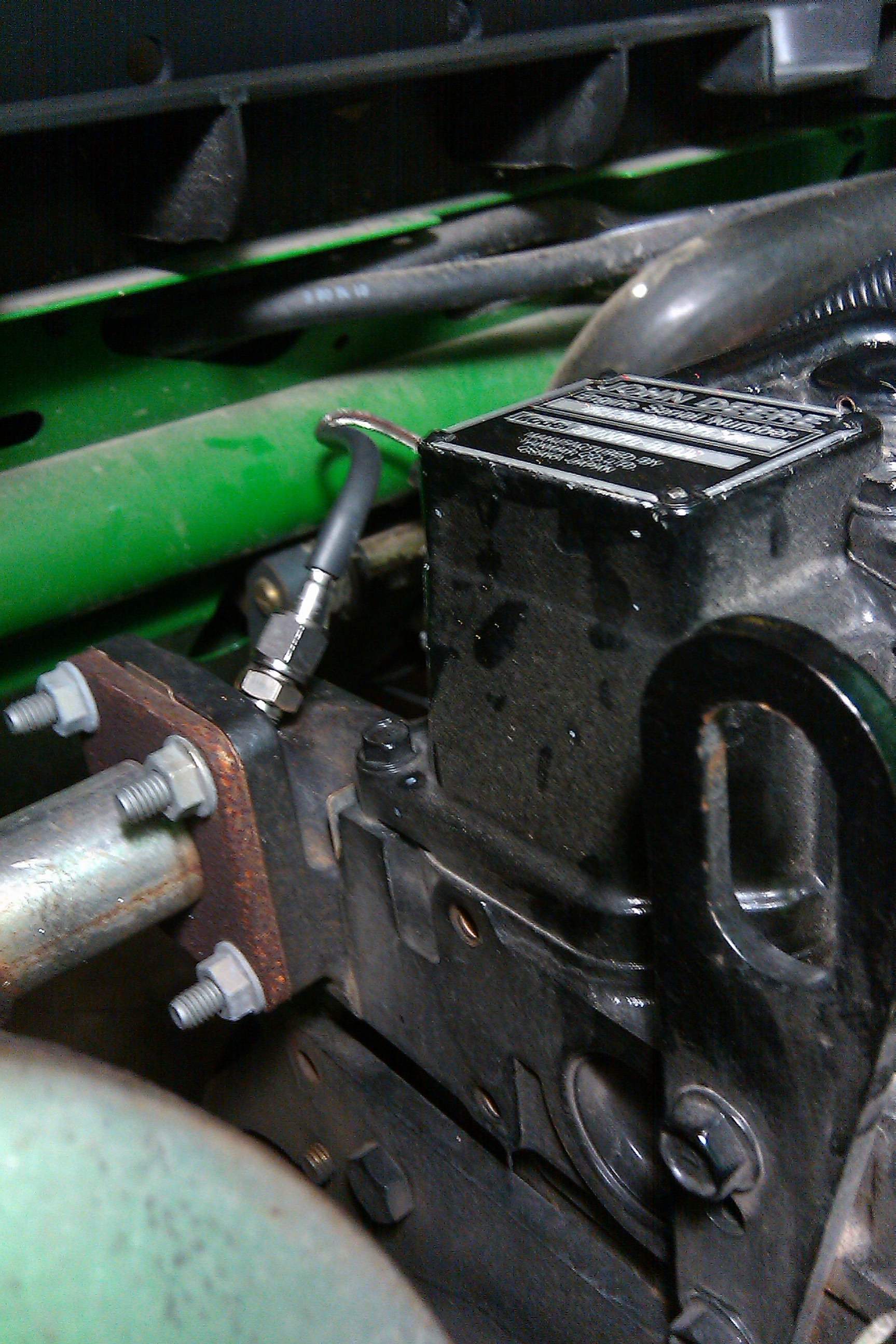

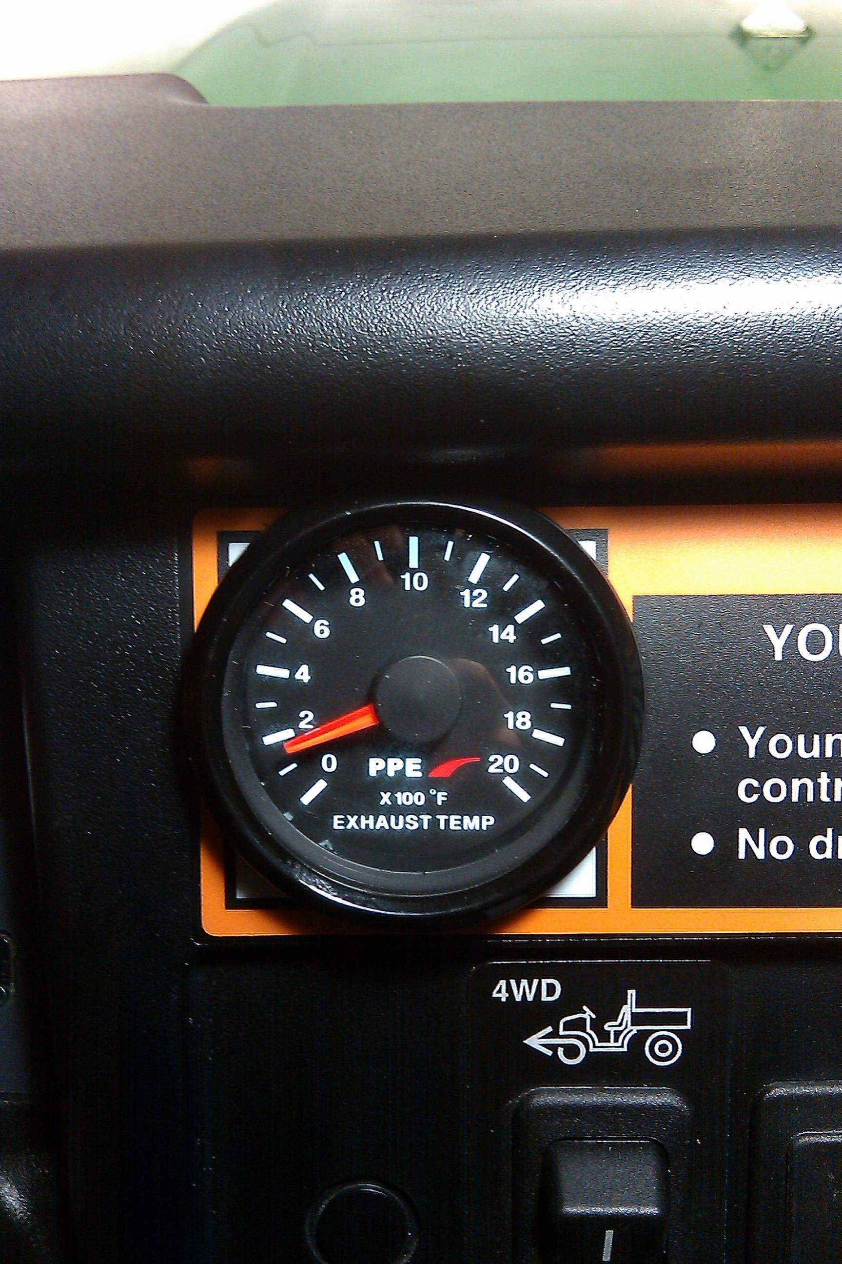

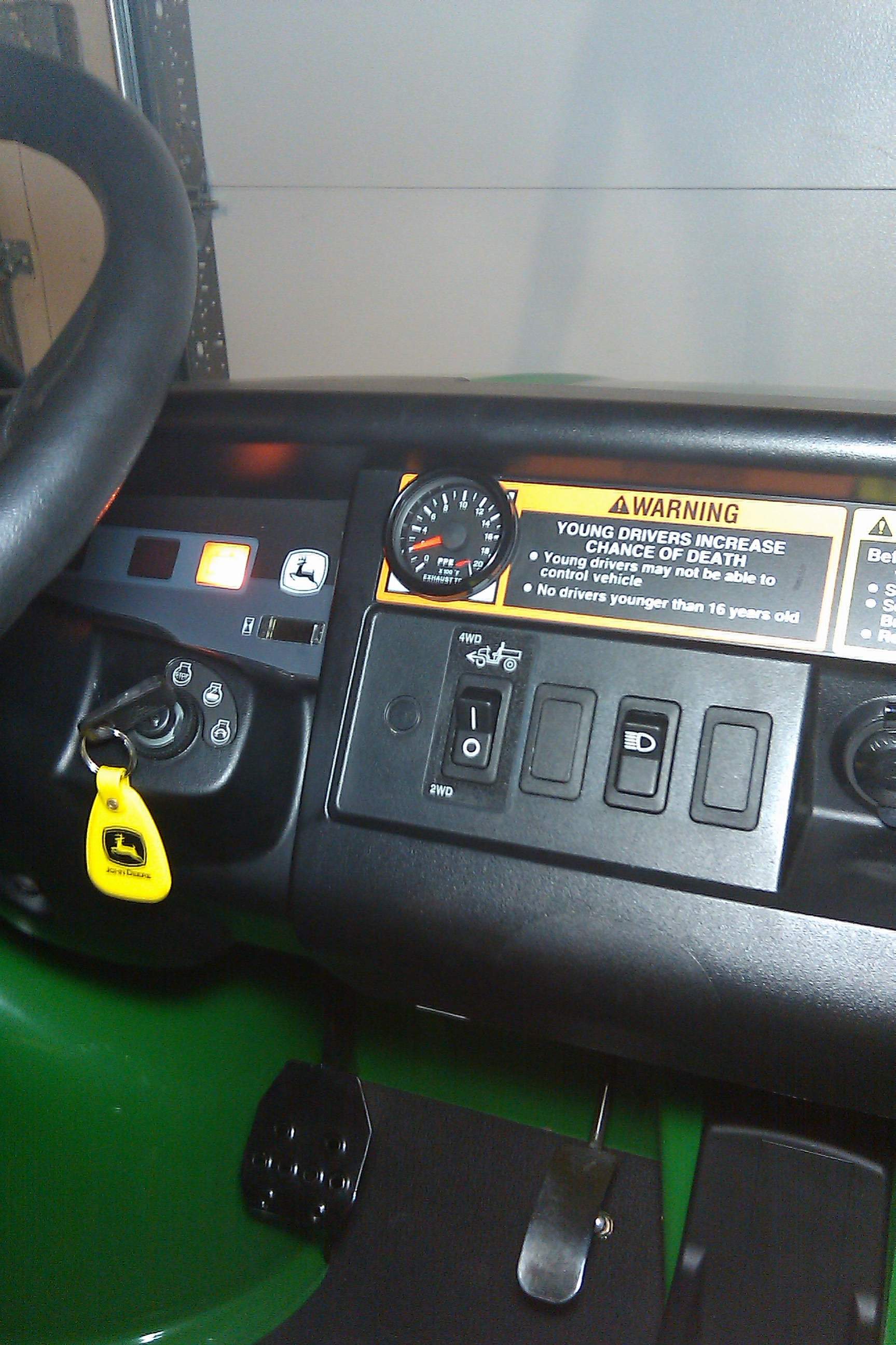

got the pump adjusted on my gator and a bit of smoke now, nothing too much; along with an egt guage. run's about 800 degrees full throttle down the road. this seem normal, i feel it's plenty safe. anyway thanks to all on here who helped.

FYI my gator is NOT turbocharged yet, so your temperature reading WILL vary from mine; but mine will sit right about 800 degrees full throttle down the road with max rpm at stock location, thats with my fuel increased. You'll want to get an EGT guage package, it includes everything you'll need (guage, lead wires, hardware, and probe). I used a PPE one I had laying around from a pickup truck. Insert probe into manifold AFTER all your cylinders closest to the last port. I made a post with more info about selling what I did. You can see that and I've included some of the pics from that post also. Depending where your located, I'd be willing to help you out for installing the probe and guages. Just a guess, I'd expect your's to maybe be around 900--1000 degrees with the boost and increased fuel. You can always play with the fuel on a diesel to move your EGT around, but typically I like to have smoke so I know it's a safe range and not too lean; at the same time not too much smoke so you burn it up. I'm just learning with these engines and haven't been inside of one, but based on my job and past experience with diesels. I'd say around 1000 degrees WITH boost added to engine should be safe. Average pickup trucks (duramax, cummins, powerstroke) can EASILY hit 1500 degrees with a tuner, and more depending on their fuel delivery. 1700-1800 starts to melt stuff. I take this into configuration and keep in mind I'm playing with a 3 cylinder, and figure 1000 degrees should be safe. I wouldn't want to see this 3 cylinder touching 1500; although it might be perfectly safe, I try to judge it based on what it's temps are stock.

oops almost forgot, places that you can get an egt guage from are local auto part stores sometimes, otherwise outfits such as isspro, autometer, etc sell guages.
