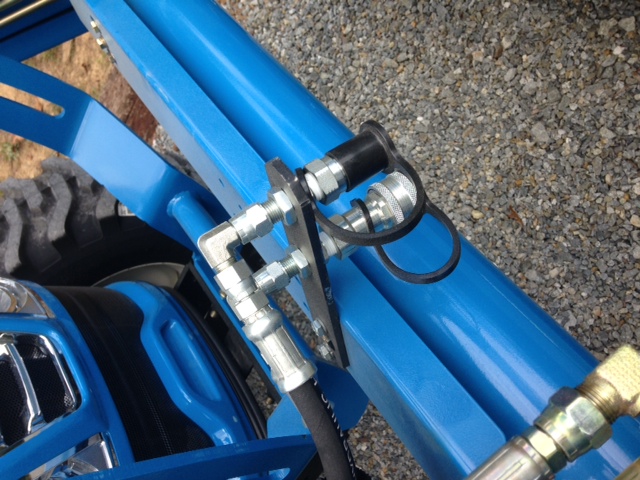

Evening all, I wanted to chime in on my new XR4046 gear I received just before the weekend.
After much lurking and post reading for several months while vetting what I was really after, I pulled the trigger a few weeks back. The tractor was in stock, but they needed some time to get all my "extra's" finished up. I fretted for a long time over a cab or not as I really wanted one, but I came to reality as this tractor will get used alot in the woods here and at the 1800 acre hunting camp I belong to where we do alot of food plotting, brush moving, tree moving and so on. Trails can be tight, and I didnt want to tear up the cab, I am happy with the choices made, and I wanted to share.

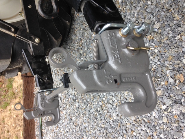

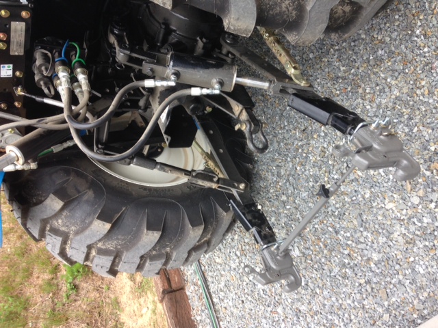

Extra's include, aluminum ROPS hard top, hydraulic Top n Tilt, 3rd valve set rear, 3rd valve set front, and easy change between front and rear on the 3rd valve function. The dealer ( Goss Tractors, Jasper, GA ) did a stand up job, and I am very very happy with the results thus far. Since getting it home I also installed a set of Pats Quick Hitch sets for CAT1, and FYI to any interested, they went right on, no mods needed, simple. Also worked the tractor yesterday all day grading a freinds drive for him gratis ( just had to try everything out ) and not only was he quite happy, so was I
Have some other "add's" to do going forward, but this will do for now until I get more time.
All n all, I think they did a brilliant job on the install, AND I must thank all whom post in the LS forums, you quietly helped my confidence with LS, and also helped direct me to what really counted with some add's. Thank you, thank you. Going forward I will be more active here in the LS section. Sorry for the misaligned pics, driving me nuts I couldnt get them orientated right but when you click on them, the do display right side up, go figure !
Here's some pic's
![photo 1[2].JPG photo 1[2].JPG](https://www.tractorbynet.com/forums/data/attachments/361/361326-b00fbb9a8df6d2037d0508adcc494a6d.jpg)
Top n Tilt
Top n Tilt and Pat's Quick Hitch w width bar
3rd valve set rear

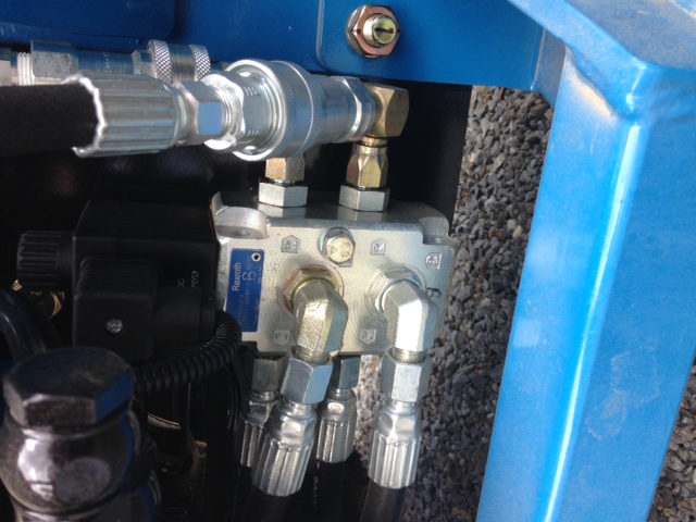

![photo 2[1].JPG photo 2[1].JPG](https://www.tractorbynet.com/forums/data/attachments/361/361359-2fb73ee4b87db08d8cdb140d578dbafb.jpg)
3rd valve set front

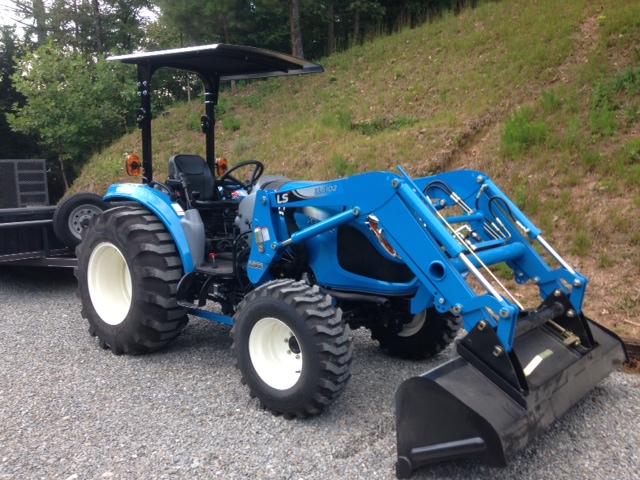

![photo 4[1].JPG photo 4[1].JPG](https://www.tractorbynet.com/forums/data/attachments/361/361361-81133bf7aaf4dec2bd6a3a0950537b6a.jpg)
3rd valve set valving on right side valve block ( valve block is by Rexroth )

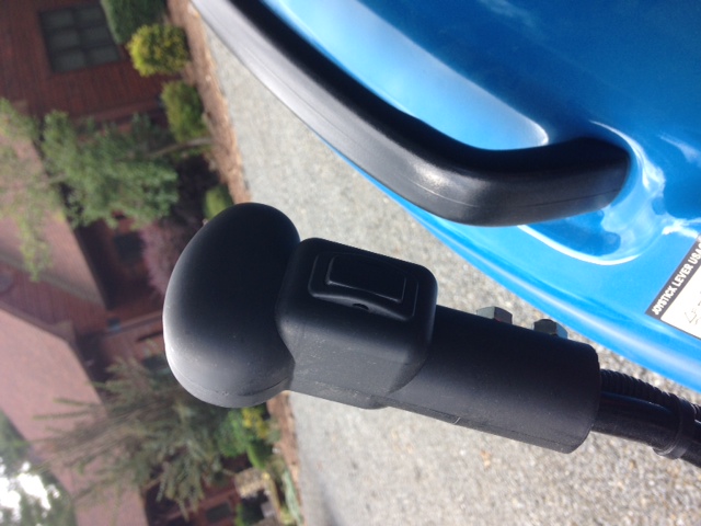

![photo 3[1].JPG photo 3[1].JPG](https://www.tractorbynet.com/forums/data/attachments/361/361362-7b8c602a53a3bf1c1f37186dfa8da3a7.jpg)
3rd valve set front / rear electro hydraulic solenoid selector valve

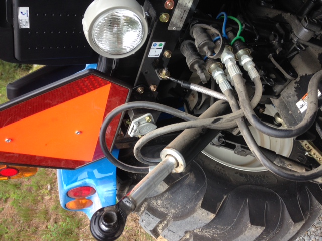

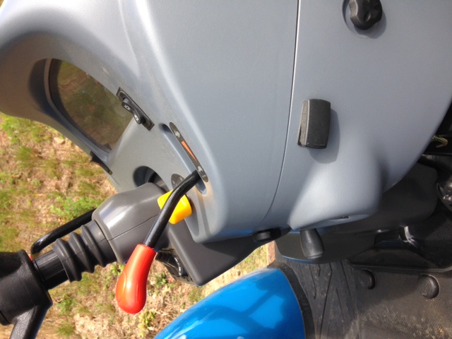

![photo 2[2].JPG photo 2[2].JPG](https://www.tractorbynet.com/forums/data/attachments/361/361370-f87b56ff0ec6ff1f039bc1ddb404391b.jpg)
the front or rear electric selector waterproof rocker switch

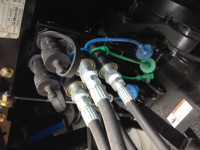

3rd valve front or rear FEL control knob switch
![photo 1[1].JPG photo 1[1].JPG](https://www.tractorbynet.com/forums/data/attachments/361/361382-3e02a495458f6f5a33edb0ae8037937d.jpg)
