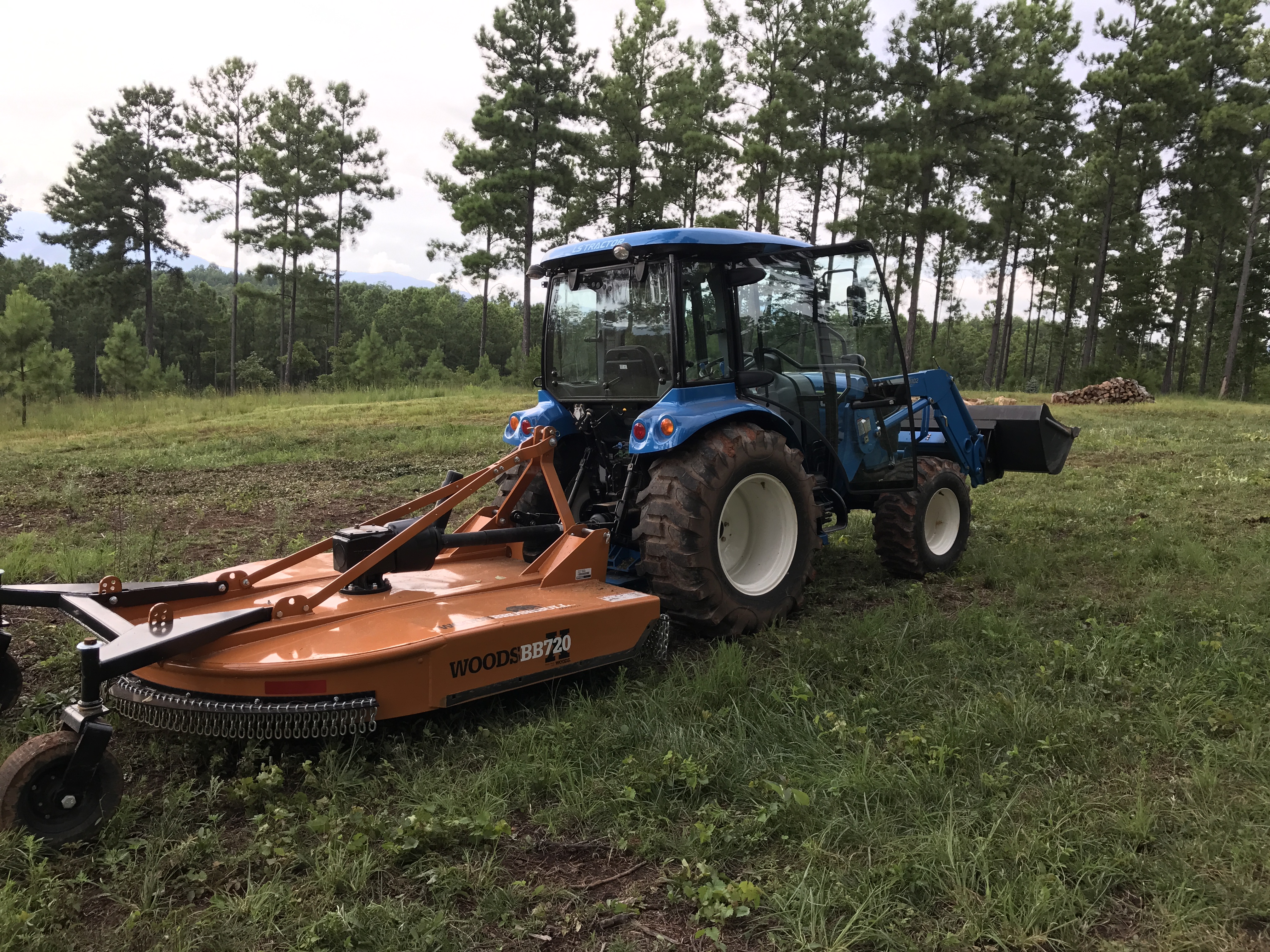

Tried this on another thread, trying it again here, we may be in the same boat. Just recently considering rotary mower. I've arrived at Woods BrushBull BB72X or BB720X. With the included options the BB72X runs about 900+#'s and the BB720X runs a shade over 1400#'s. I see from the spec page that the 4046 appears to have a rated lift of 2700#'s. In the past when I've had the backhoe attached (1163#'s with 24" bucket) I've not noticed any particular issues and basically with FEL and BH attached felt like there was pretty good balance when the two are attached. That said, if my numbers are correct anyone see any issues with going with the either the weight of the BB720X or the ability of the PTO to supply enough to the BB720X to make it effective?
   / XR4046 Bushhog #5

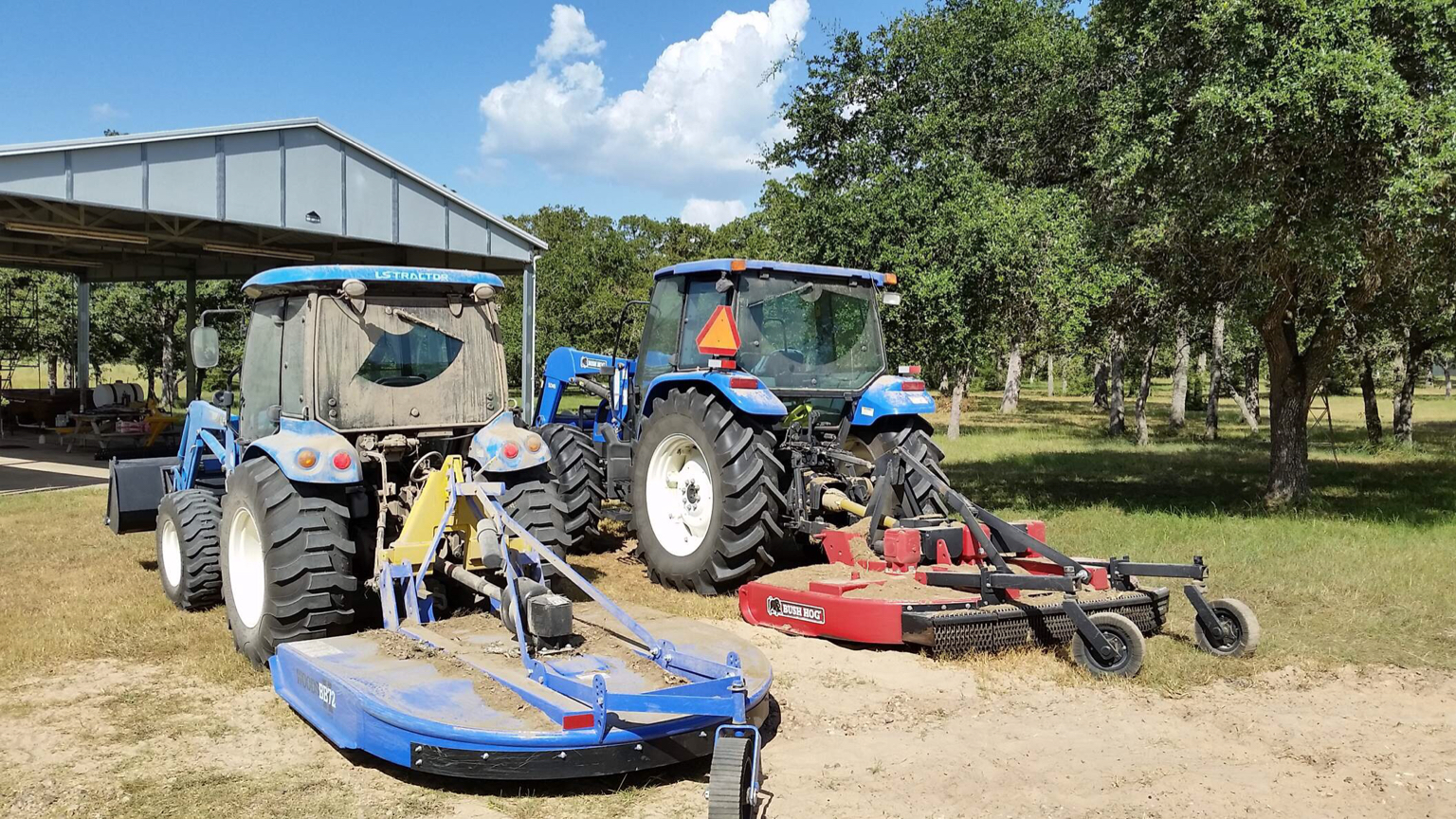

Purchased Woods BB720X up in Pennsylvania on Saturday, attached it on Sunday in North Carolina and ran for about two hours. As you can see, it came with chains front and back and tandem wheel setup. So far, pretty pleased. IMG_1093.jpg

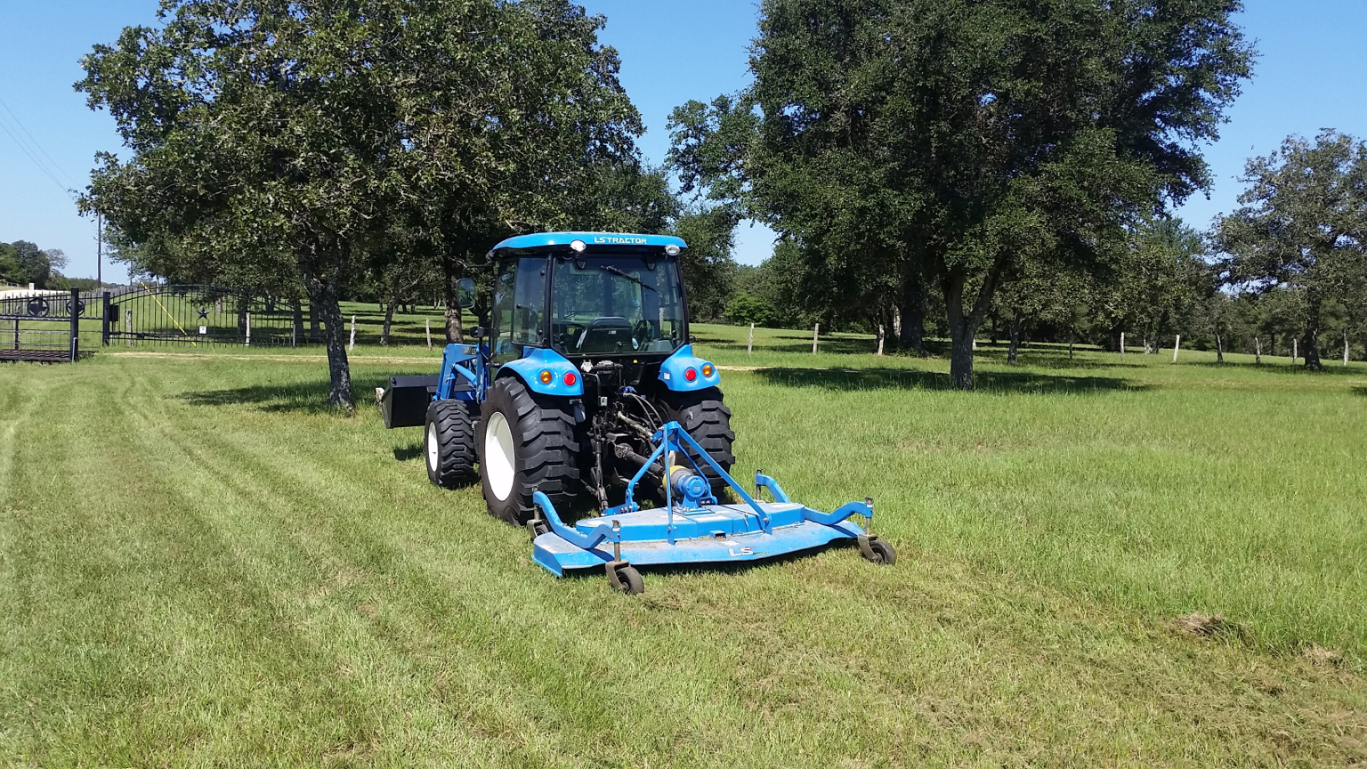

The Woods Brushbull is a great fit for your tractor. Mine is a XR4046HC.
Also have an LS 84" Rear Finish Mower.
   / XR4046 Bushhog #7
I have the LS 6ft bushhog with the slip clutch on my XR4145. Works great for deep grass and brush. I haven't tried to chew anything up larger than 1" or so in diameter, but I don't think it would have a problem. The LS units are made by Taylor-Pittsburgh.
