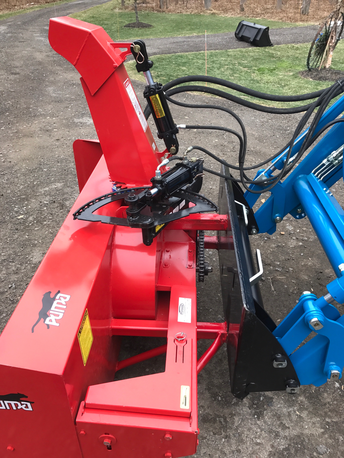

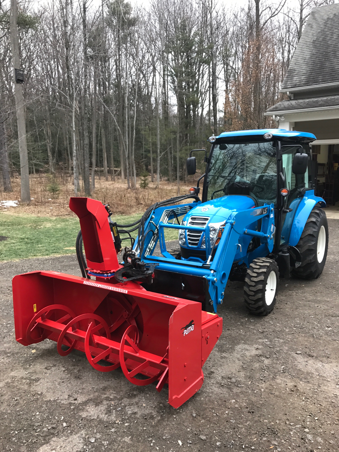

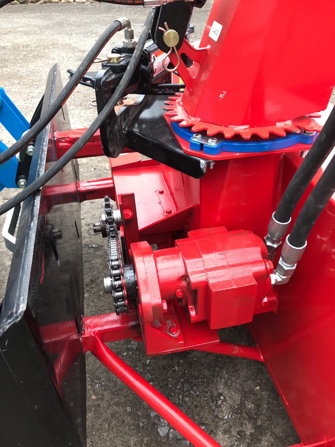

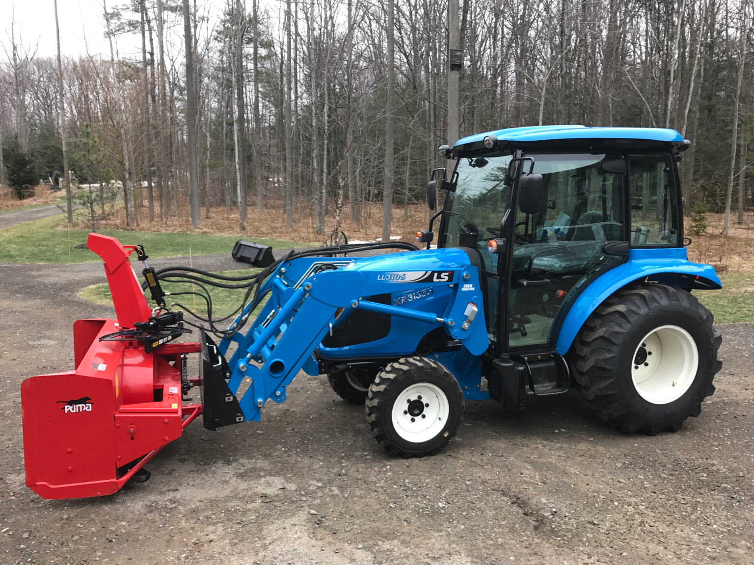

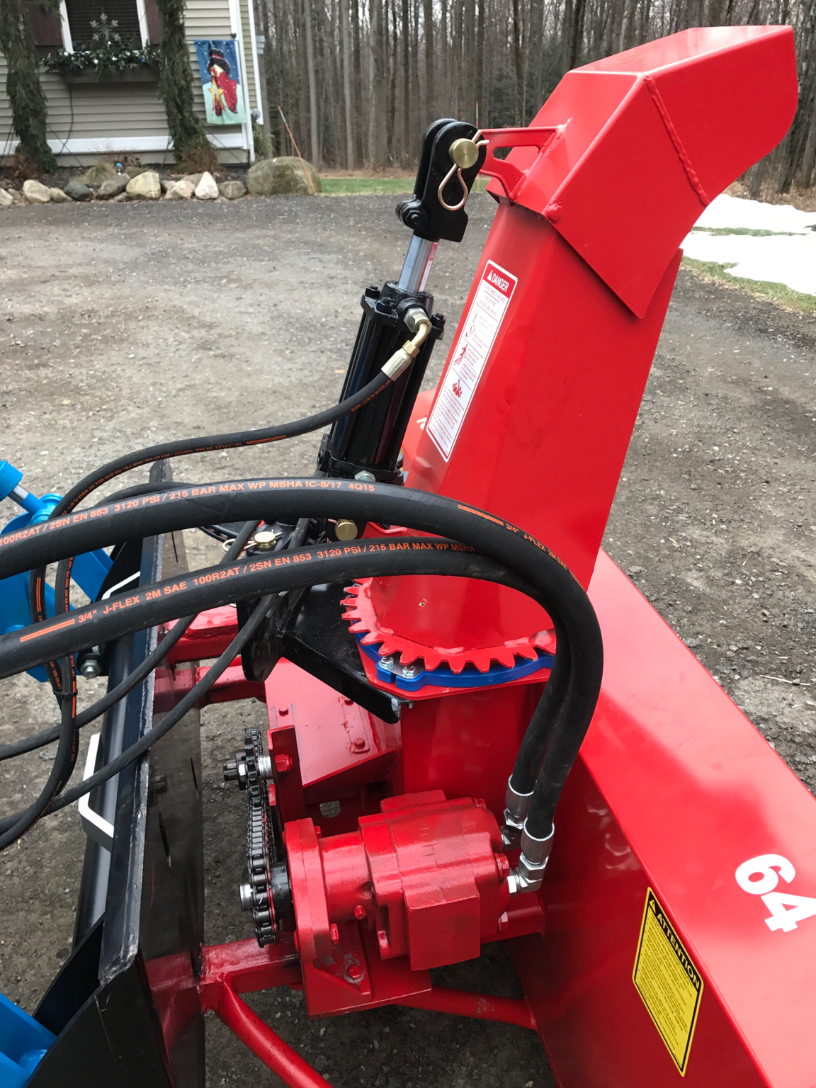

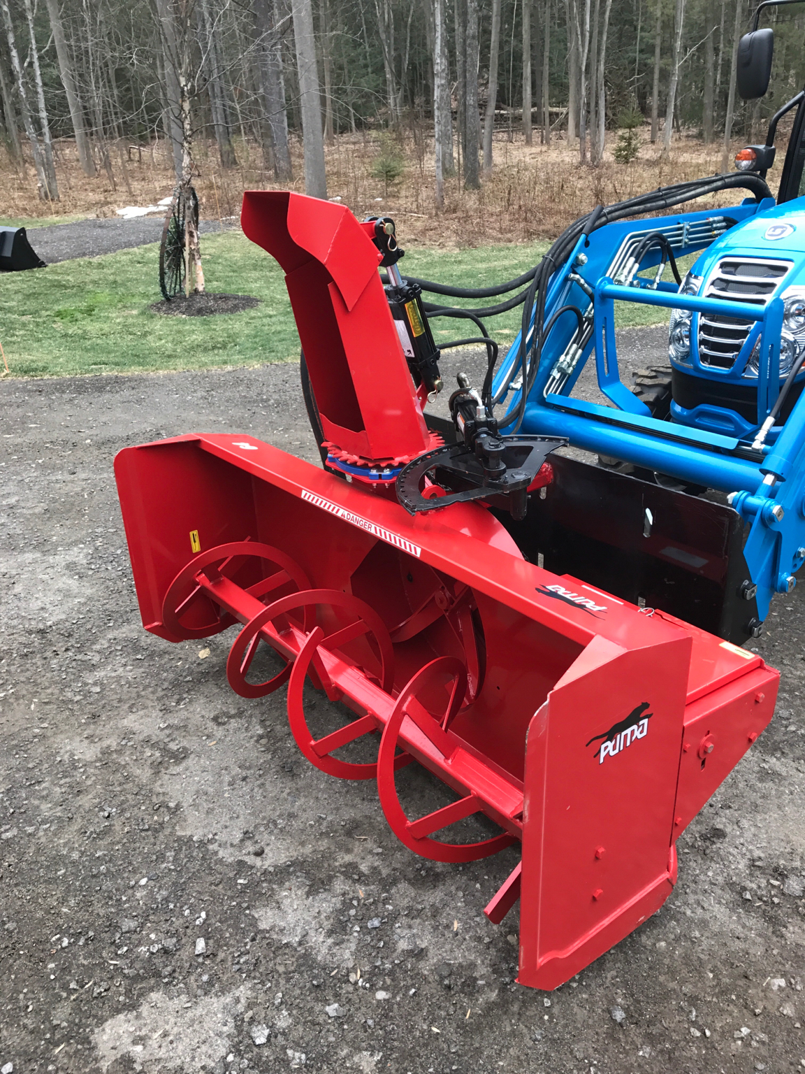

I really tossed the size of the blower around for a long time. The dealer has been putting Lynx 62 blowers on the front of these with good results. I wanted something wider and was going to get the Lynx 70. At the last minute I decided I really wanted the little extra durability of the Puma so I sacrificed a few inces to get it.

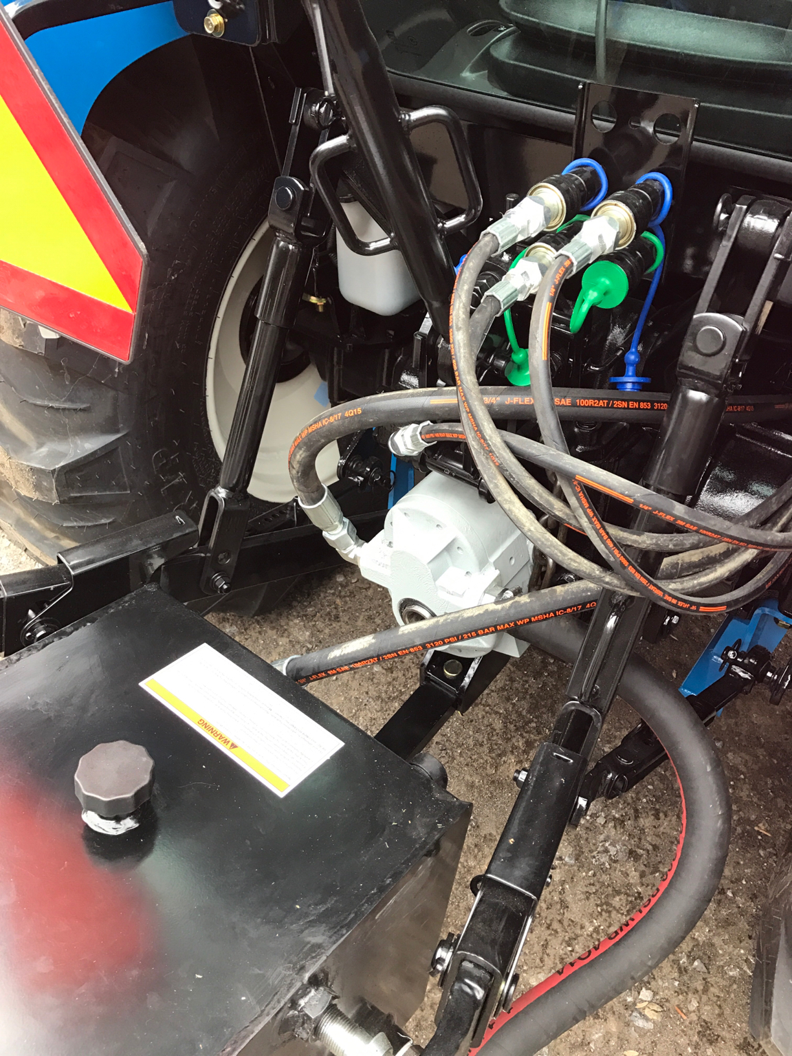

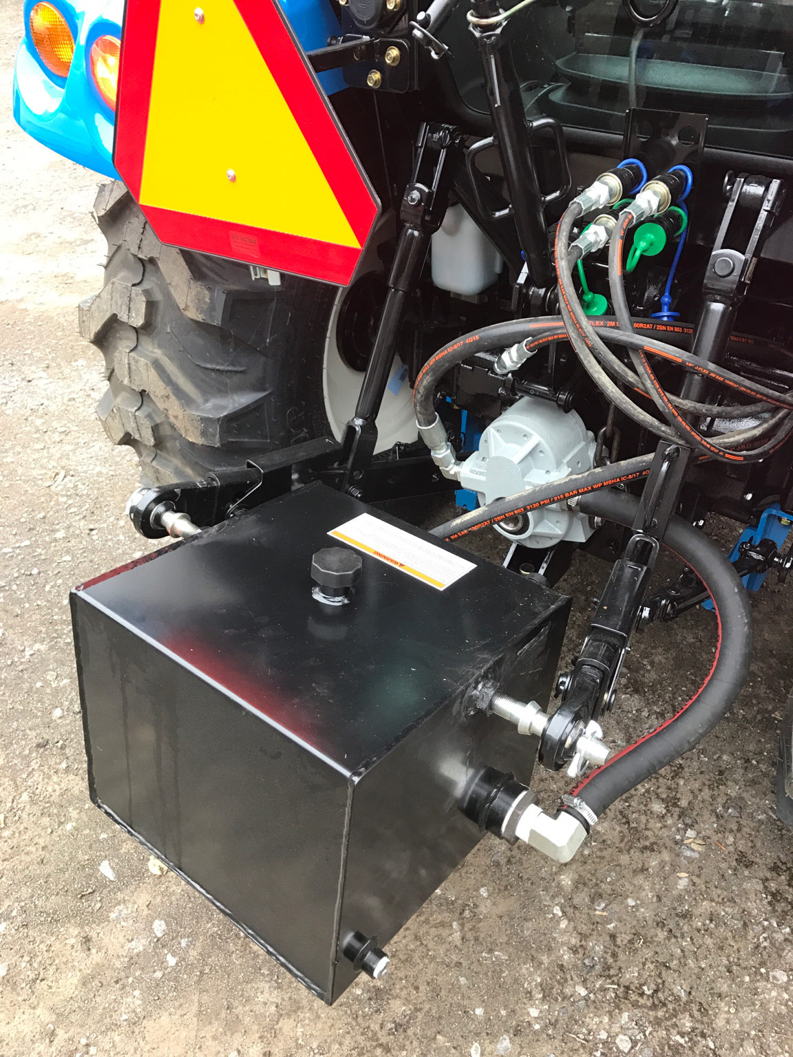

The dealer is taking off the 3-pt mounts and putting on a quick attach plate, along with a hyd motor on the blower. Putting an aux hyd tank on the 3-pt hitch and a rear PTO driven pump. He will run all the hoses under the tractor, including lines for the hydraulic chute and deflector.

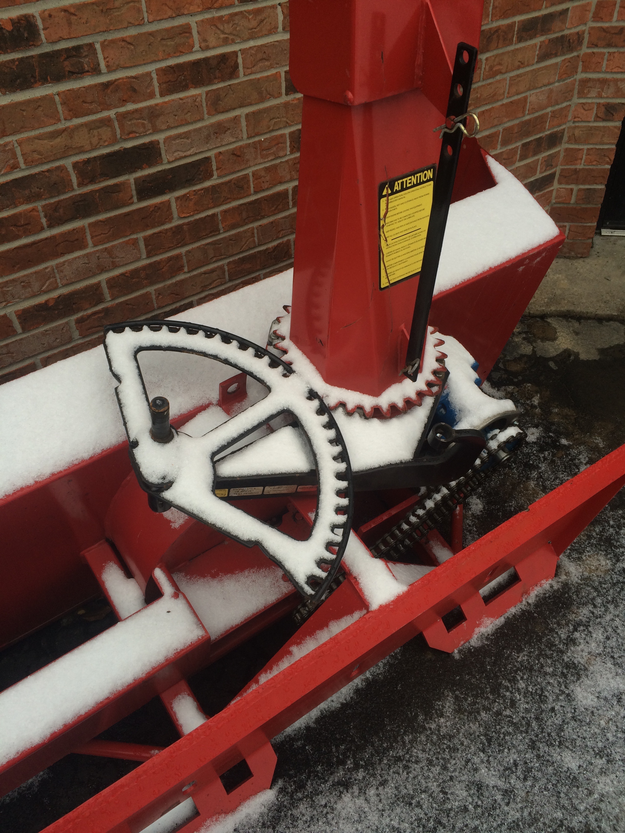

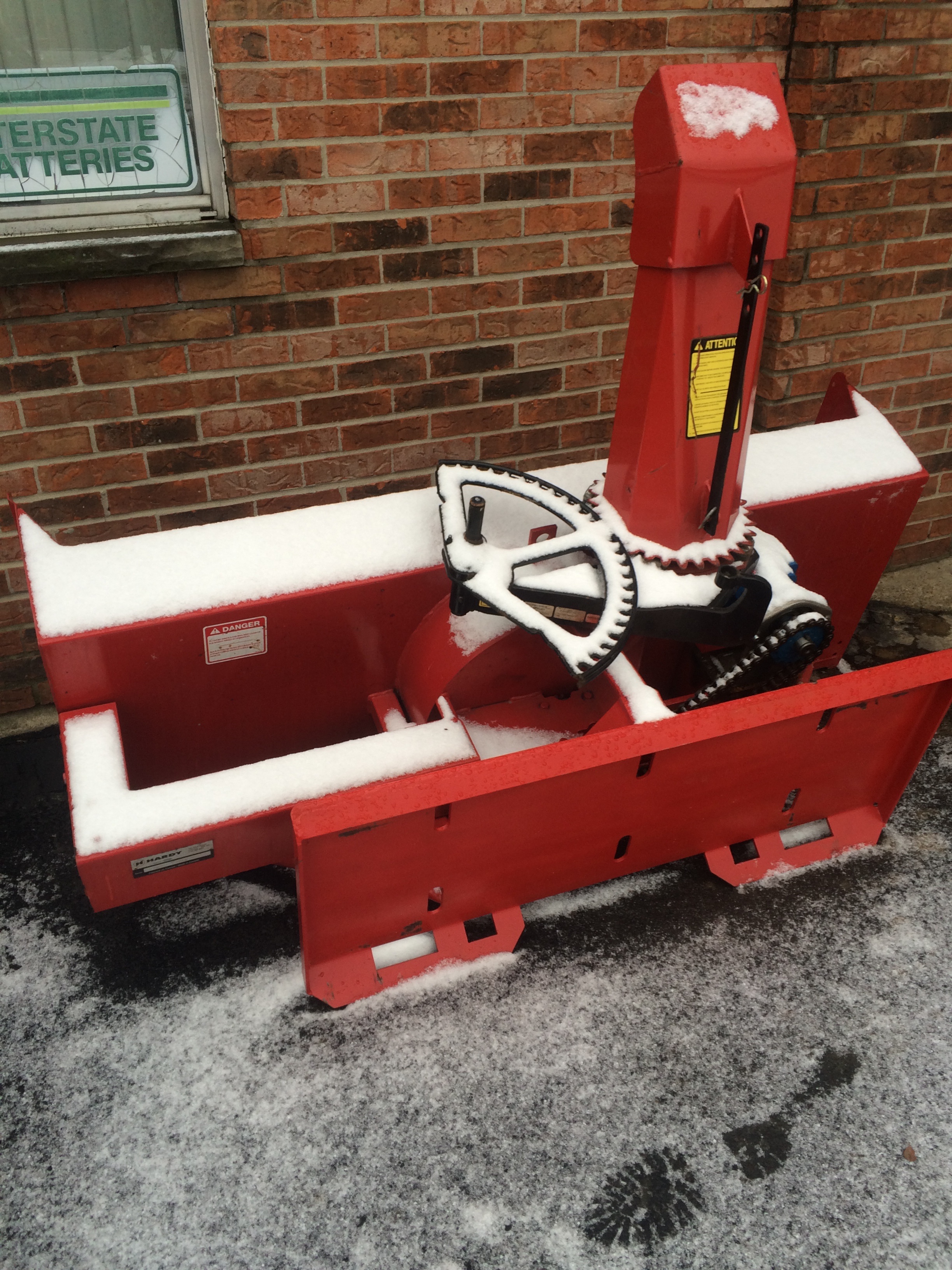

Here are pictures I took last year of a blower they had sitting there. Its missing the hyd cylinder for the chute, but you can see how they convert the mount. This was a Lynx.

Here are pics of the blower they converted.
